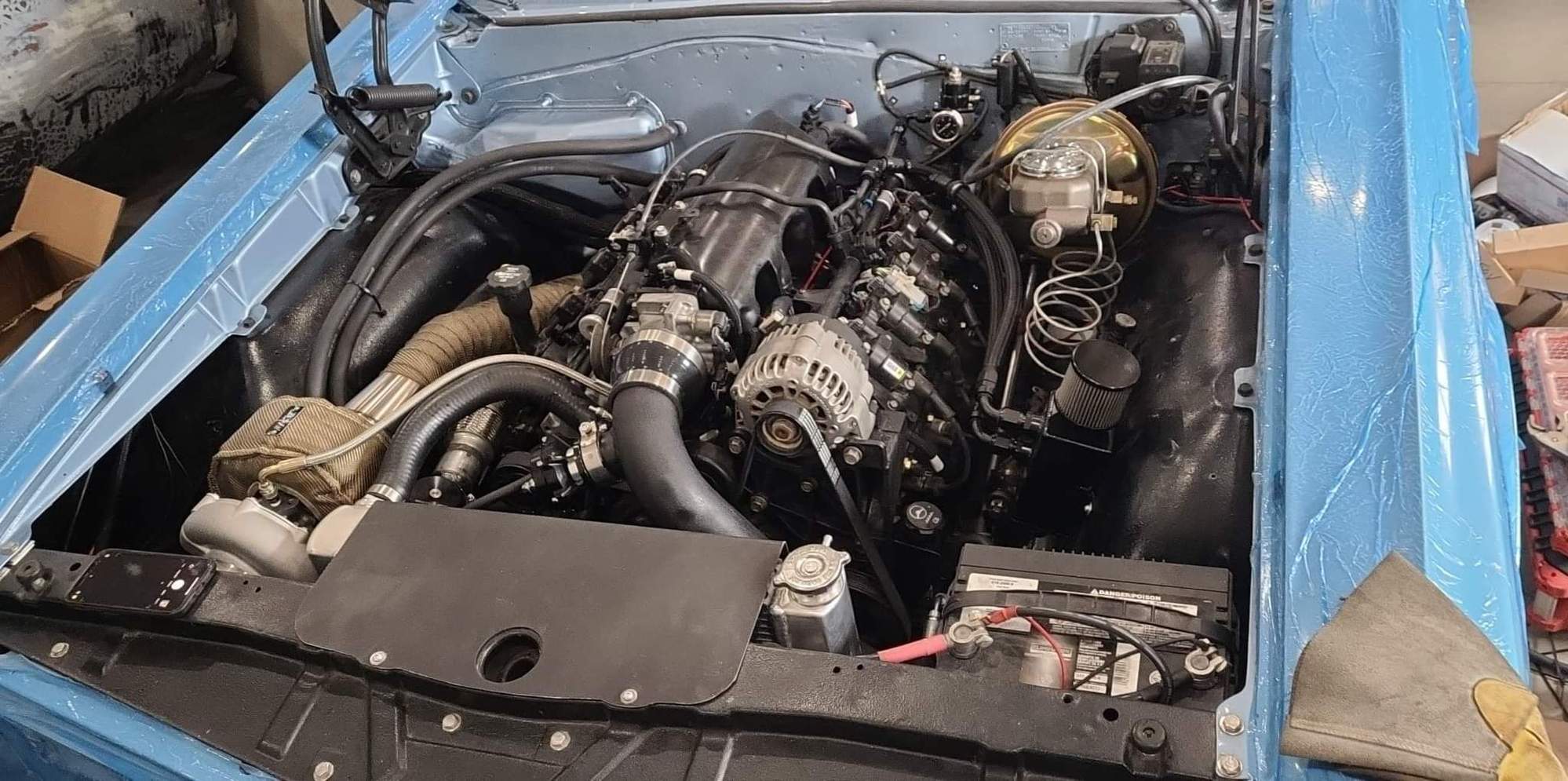

Getting closer...
Guess I'll be using a small filter haha
Maybe a "mushroom" style or the small pancake style k&n.

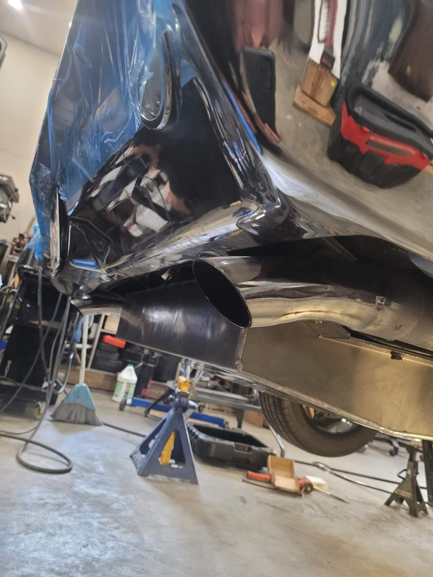

Closer by the day, was ahead of myself to startup by the weekend that just passed but in the next couple days is looking good. This week sometime anyways haha.
I hope I like how it sounds without mufflers

That's the thought. I really think it'll be fine until I'm on the loud pedal.
Then it's all smiles anyways.
Just hoping for no drone or anything silly during highway crusing.

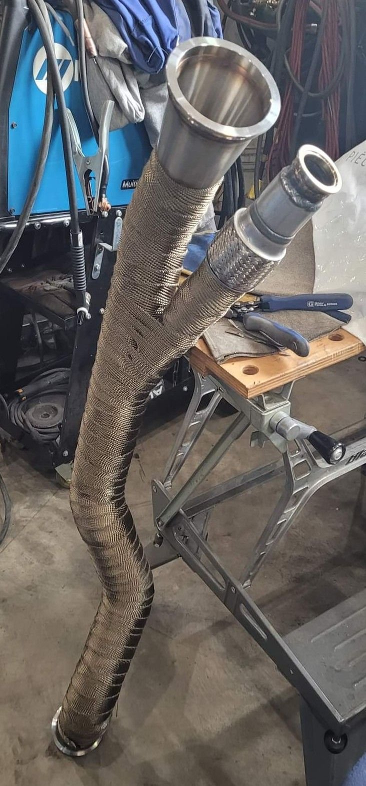

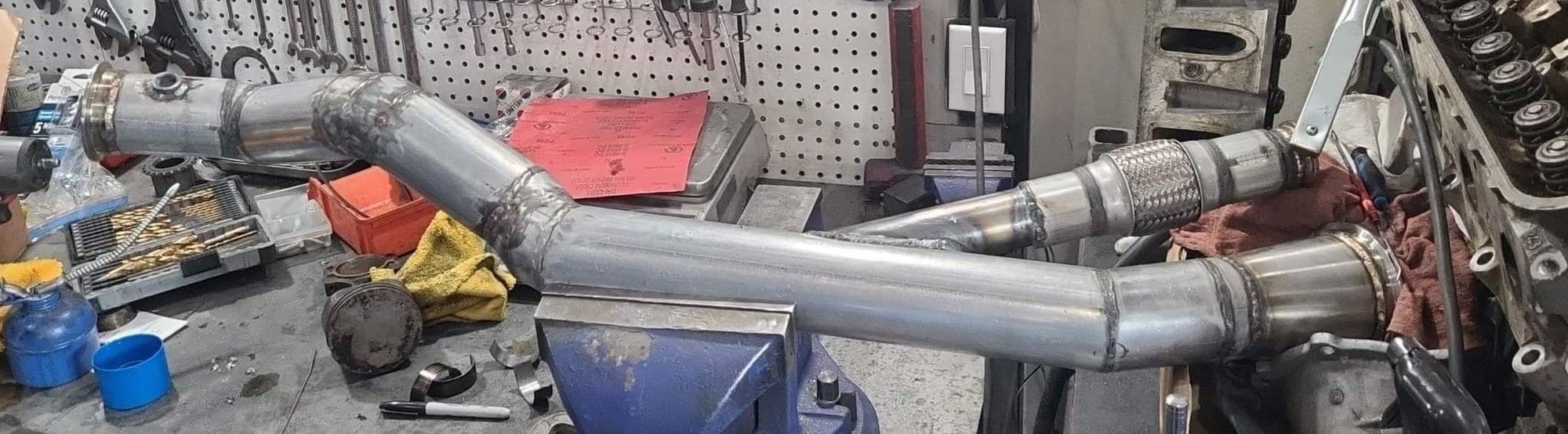

Downpipe finished and wrapped. Maybe going for a start up tomorrow, have to install downpipe, wire starter and essentially fill fluids.
I think I'll be hitting the dyno in a week it seems. Getting pretty excited.

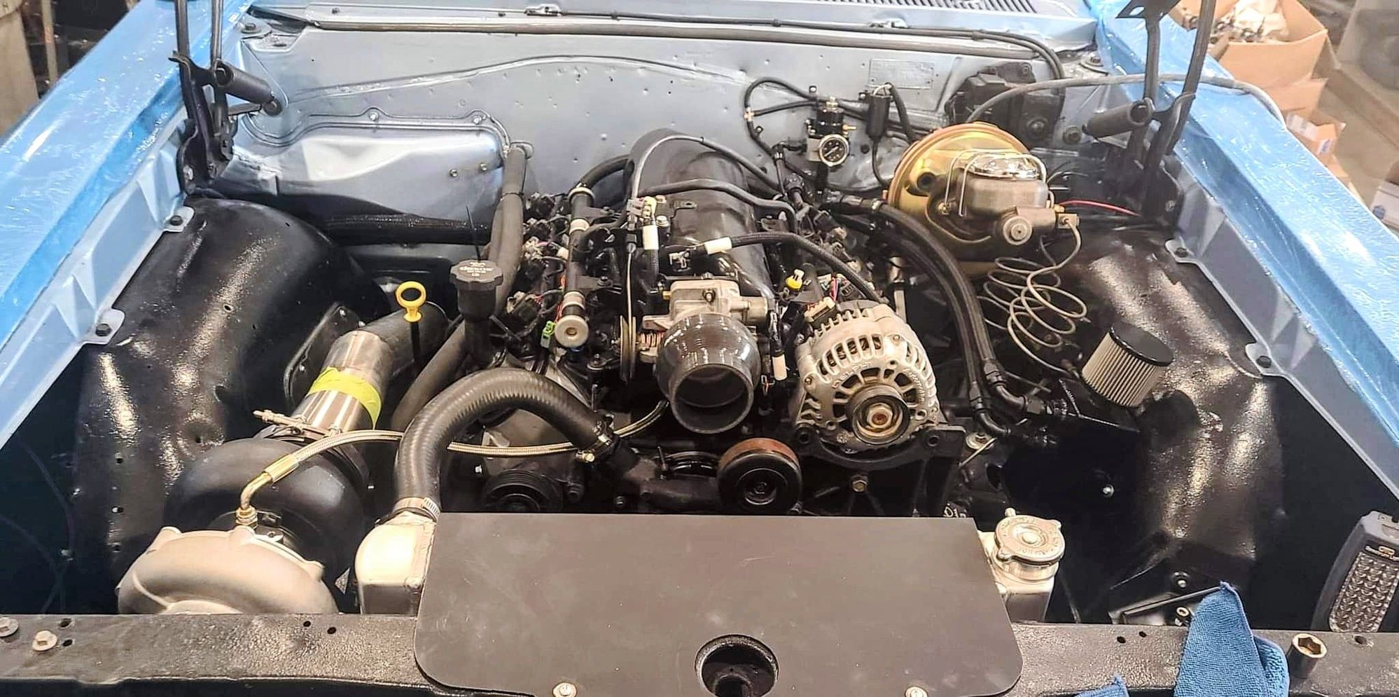

Oh & engine bay shot
