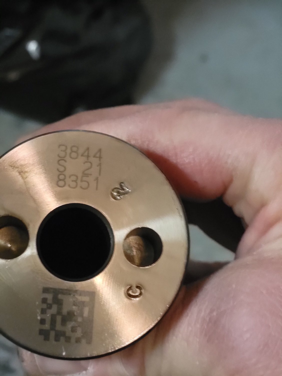

Ok so I found some time today pull everything off my motor and it looks like the vvt has been deleted! I've pulled the cam out anyone know how to identify what the cam is? I'll attach a picture of the only numbers on it incase anyone knows what it is!!
thanks all

Google the P/Ns

I did but nothing came up

https://ls1tech.com/forums/generatio...ification.html

I was assuming it was a stock cam I just didn't know what one, its still different numbers to the ls3 cam in that link!

The OEM LY6 cam specs are (as per Summit data)- 198/208, .466/.478, 116
ONLY the LS3 got the LS3 cam. LS2 is similar with less lift
