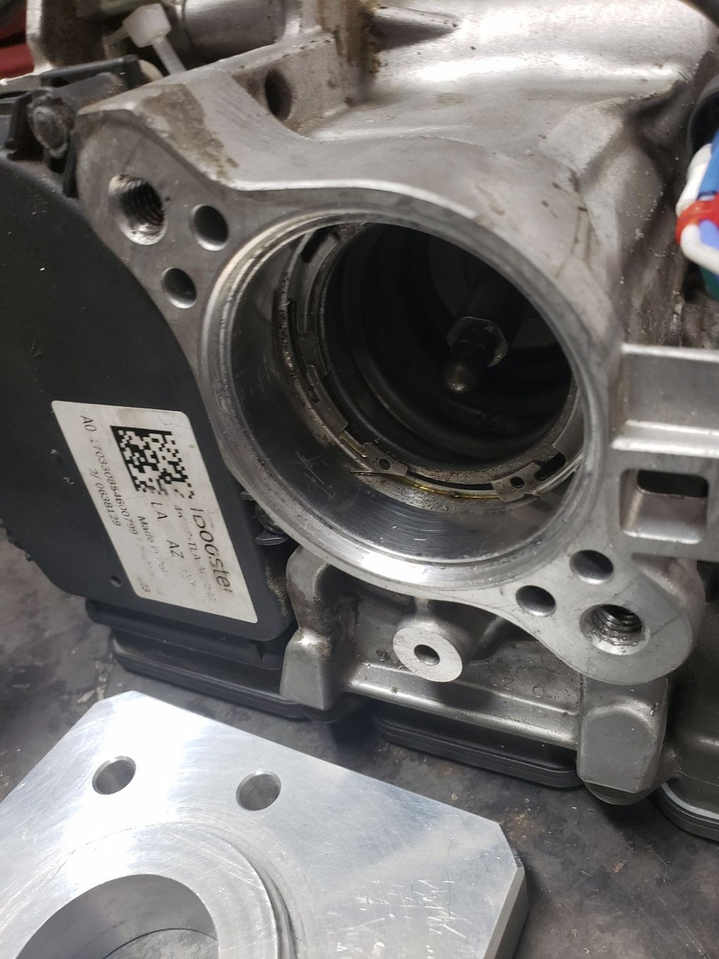

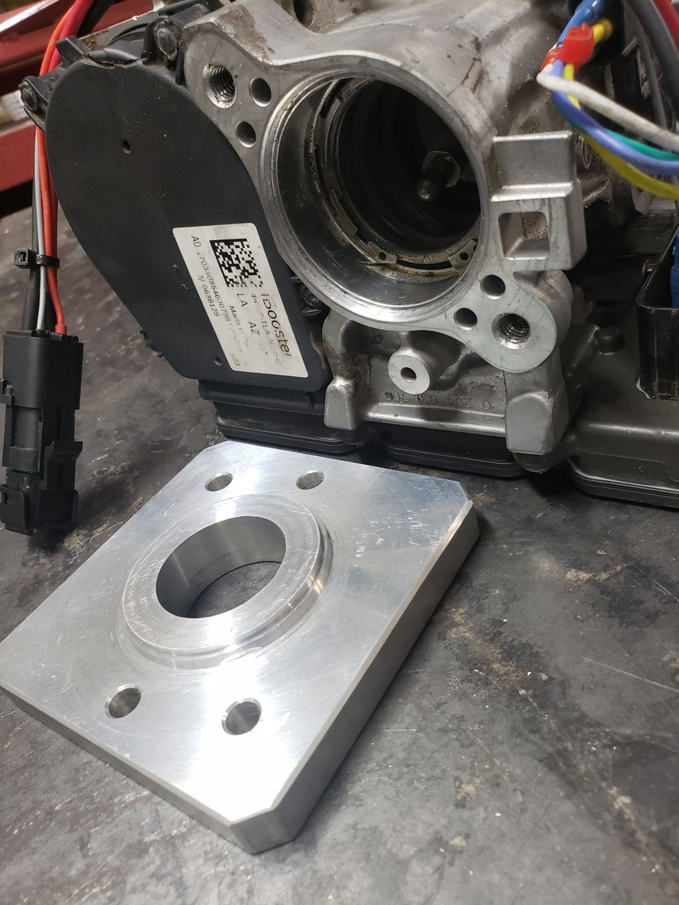

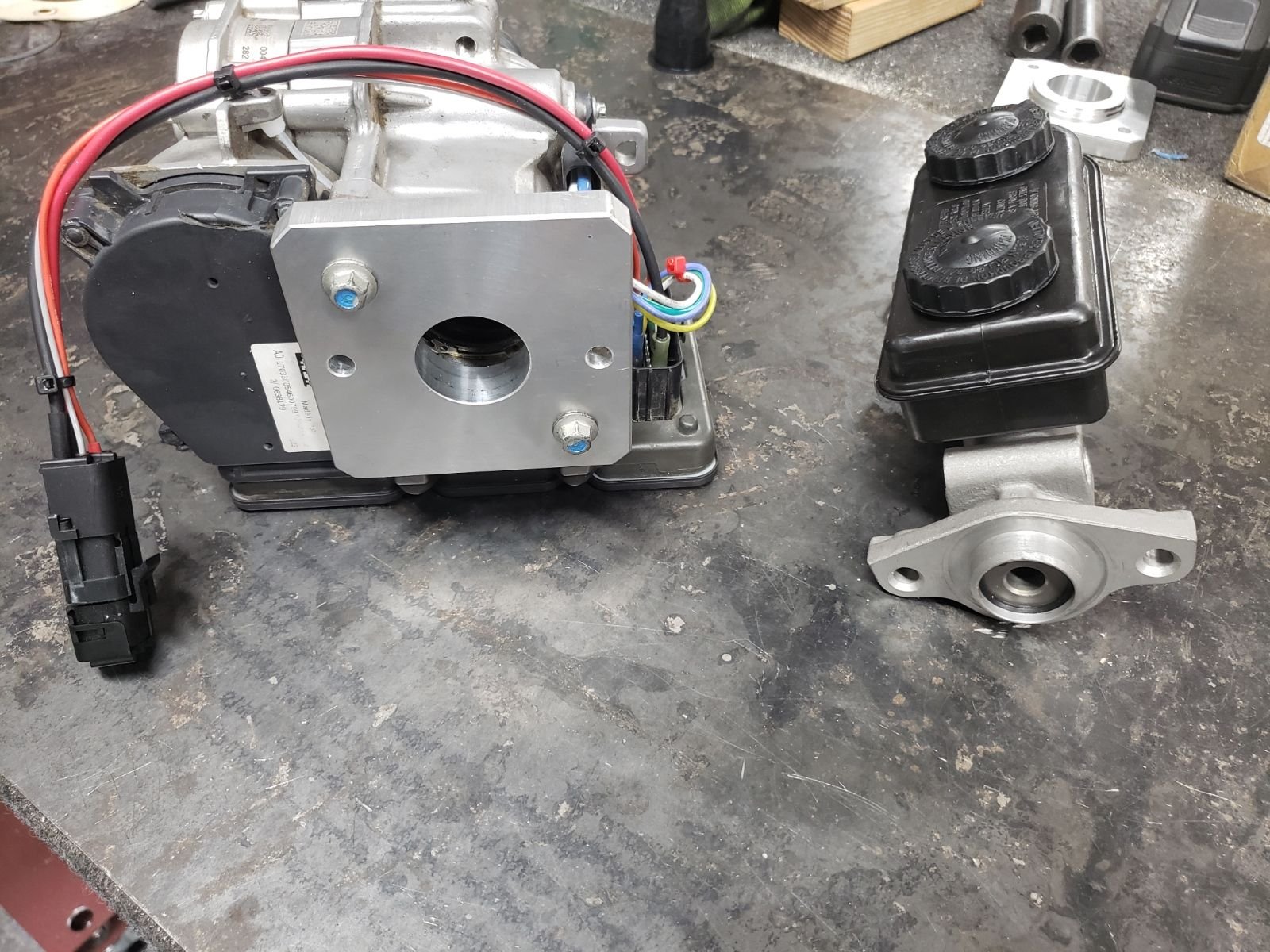

Old Feb 4, 2025 | 08:40 PM
  #120
march11934's Avatar
Joined: Jan 2025
Posts: 6
From: Florida
Made some progress with the iBooster. Used some of the information from here so I figured I would add some back. I made an adapter plate between the iBooster and the Master. I may set a second set of holes 180 out in the plate for the master so I can clock the iBooster to however it fits best in the car once I install it.
one question i ddi not see get addressed is the inner retainer ring. Does the correct master hae a sleeve that sits all the way in and up against the spring? I can't imaging that thin metal retainer is the only thing holding that spring back. I am thinking about milling out a ring that fits between that spring seat and the plate I made.
Im still considering recessing some of the bolts and figuring out how to deal with the wiring.
