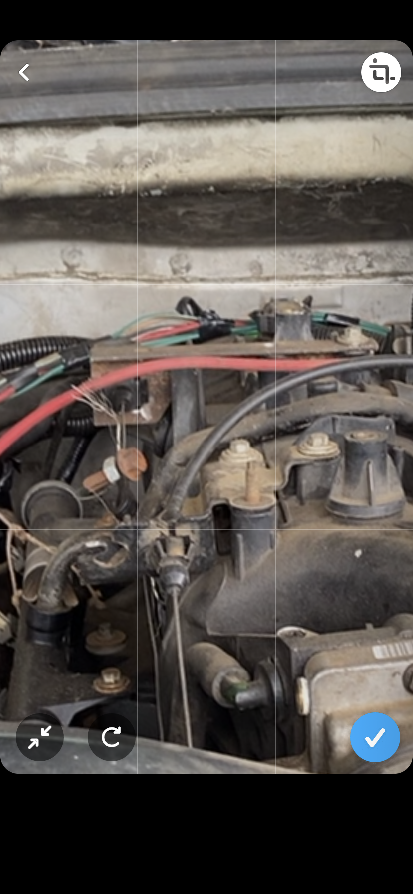

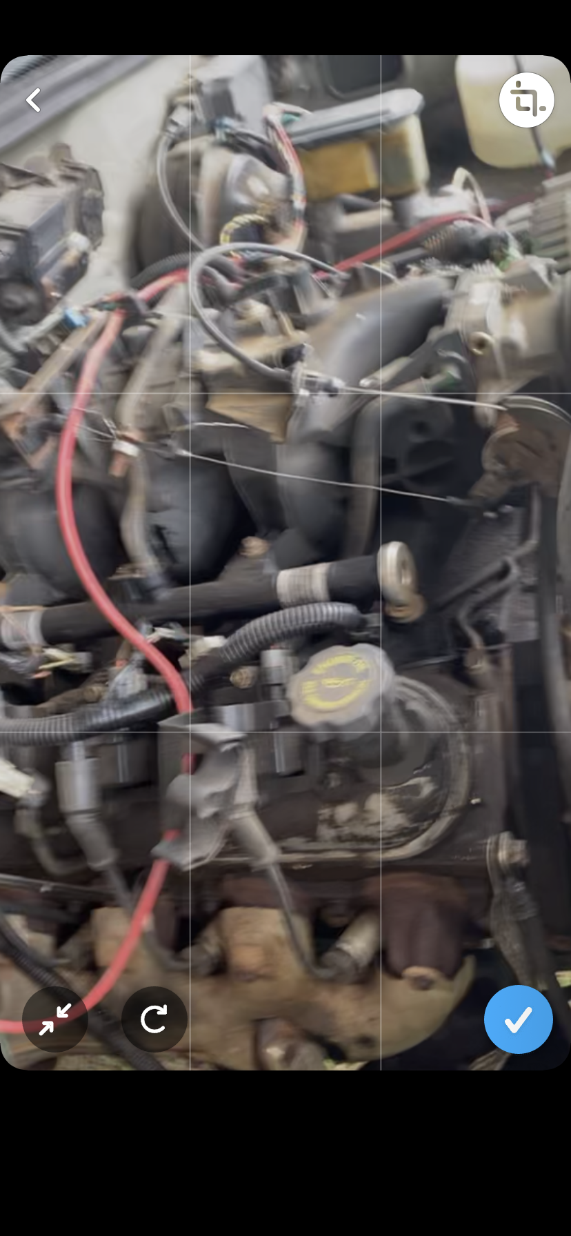

well it’s going to sound stupid but we used a nut and bolt and a metal place and custom fitted a bracket to angle the cable, we also held the throttle right and welded an adapter to the bottle of where the throttle cable pulls on to make sure it would pull fully tight when throttle was maxed out.

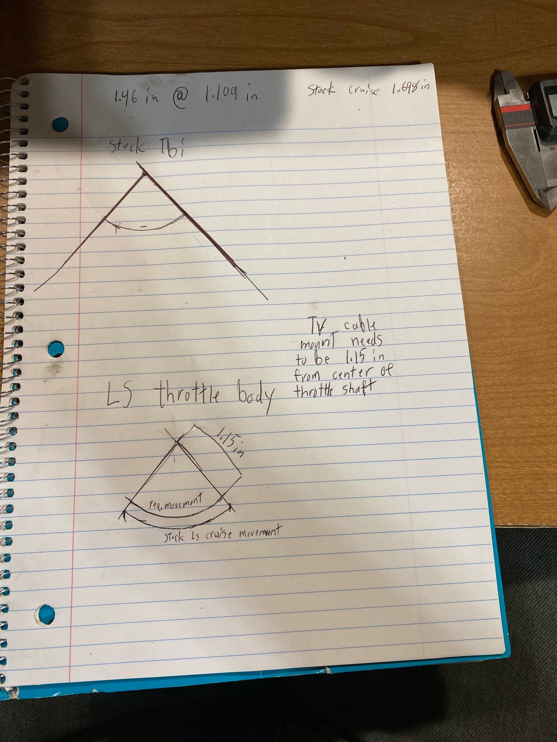

Is this a joke "the kick down is hooked up perfectly tight and maxes out as throttle is pulled"... Seriously? How exactly did you figure out the geometry for the cable? Serious question as it is LIFE OR DEATH for the transmission... It is NOT a kick down cable.. or a detent cable.. It IS a TV cable and it controls ALL of the line pressure, and influences all of the upshift and downshift points... This is not something that you can just throw together and expect it to work properly because you got the cable to max out as the throttle is pulled... Not kidding it takes a LOT to get the geometry right. I'm willing to bet, without seeing what you have working-it is not right. How many HOURS did you spend measuring the various components to get the geometry right? Cutting and welding the brackets to make it all work-unless you bought something that was already intended to work with a 700? What did you use to verify the angles needed for the attachment point? Me thinks you will have a smoked 3rd and 4th clutch pack in your very near future. Can you post a picture of the cable where it attaches to your throttle body... A picture is worth a thousand words...

jesus dude sorry I didn’t mean to offend you just two kids putting together a truck. It shift through every gear everything is fine I’ll post a picture tomorrow.

and yes we did look up the geometry got it as close as possible… yes we took our time.

Not offended at all. Sorry if I came across as "aggressive"... Here's another site that has relevant information; https://www.bowtieoverdrives.com/Ins...s/TV_101-1.pdf
though it does not go into setting up the geometry on the intake side...
This guy does a pretty good job of discussing angles, distance, lengths, and what-not for setting up the carb/throttle body connection; https://purplesagetradingpost.com/su...o/700R4p1.html
Have fun and enjoy your project!
