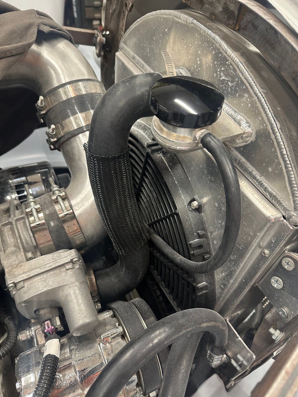

Originally Posted by Yader20
no i have the steam vent ran back into the filler neck by the radiator cap
Picture please...

So if you ran the vent line to the same port that typically runs to the radiator overflow the vent will be closed unless the radiator cap releases pressure to the over flow tank.
The vent has to go directly into the radiator, top of the water pump (drilled a tapped for a NPT fitting) or a splice in the upper radiator hose.

This is why I asked for a picture. LS engines are hard to bleed. I find that the radiator funnels work pretty well. It still takes a while, but they do eventually work all the air out.
The tell tale sign that there is air in the system is the thermostat doesn't open. To tell of the thermostat is open or not, feel the lower radiator hose. If the upper hose is so hot that you can't touch it but the lower hose is only like warm, that's a sign that the thermostat is still closed. Typically cars will idle around 215 degrees in that situation and once the thermostat opens, the temperature will drop almost instantly, while the lower hose gets a lot hotter in the process.

Picture please...
the small hose barb directly below the black radiator cap is for the overflow/expansion tank. The plunger in the cap that’s spring loaded is below that fitting so water can’t freely flow like it needs to for the coolant vents from the heads.

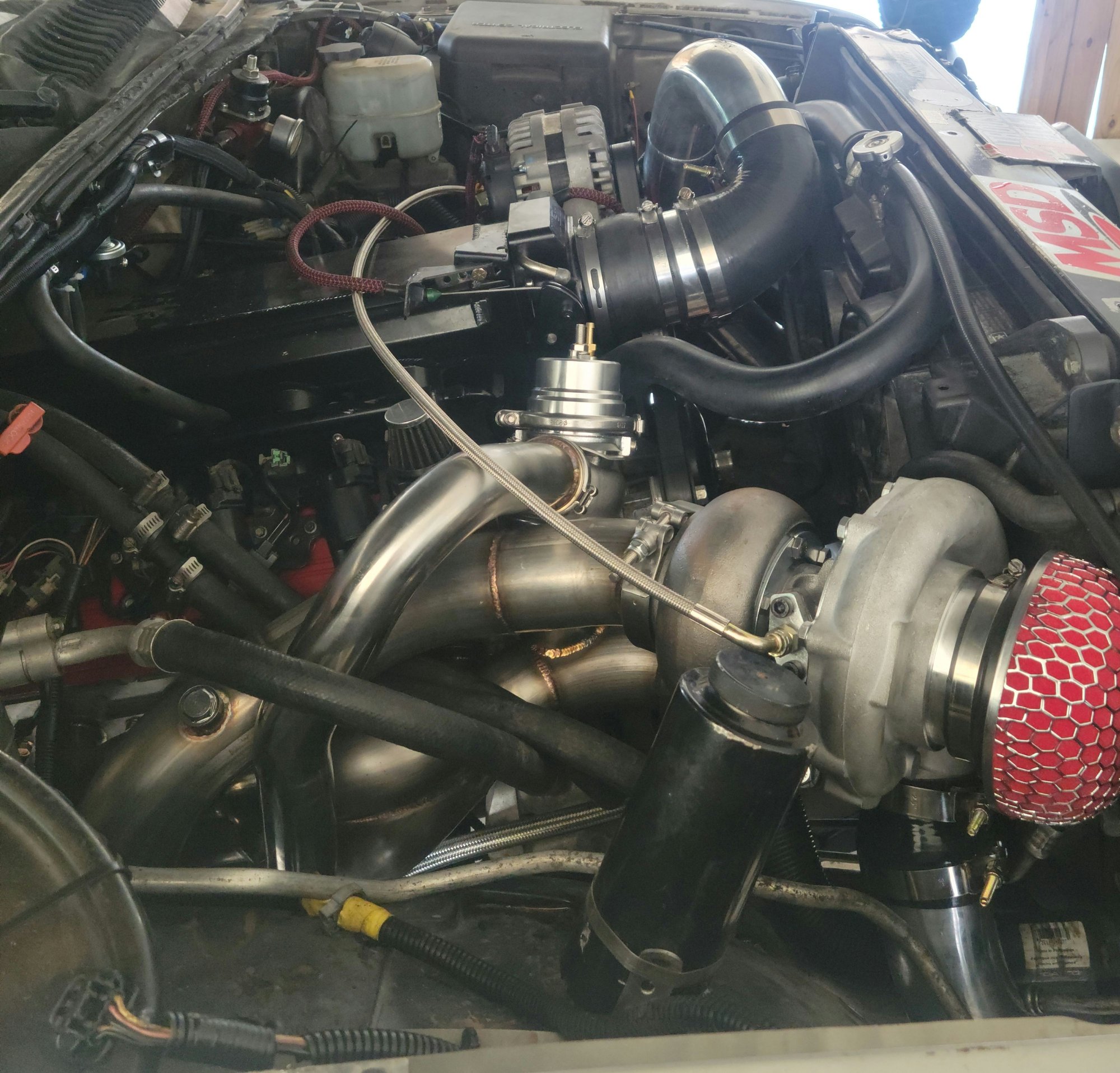

Notice the little small black over flow tank i have beside the turbo, amazon maybe 20$ and it works just fine. It has a small hole in the cap of the can to relief pressure and my overflow line runs to it. Ignore the clocking of the turbo, this was just mock up

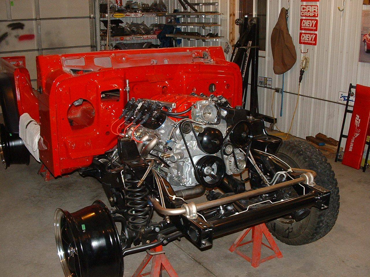

Pic of my Wrangler steam line plumbed into the water pump. Has worked well for close to 15 years. The down side to that is if you loose the water pump you can't just get a new one at NAPA with NPT tapped hole.
One other thing I do on the LS thermostat is drill 3 1/8" in the outer flange to get some coolant flow prior to the thermostat opening.
This is definitely a big problem. As others have stated, that is not the correct location for that hose. Get the vents routed properly to the radiator, use a funnel to bleed it, and you will be good to go. I see no reason that a bung can't be added next to the upper radiator hose with the steam line connected to it.
Andrew
