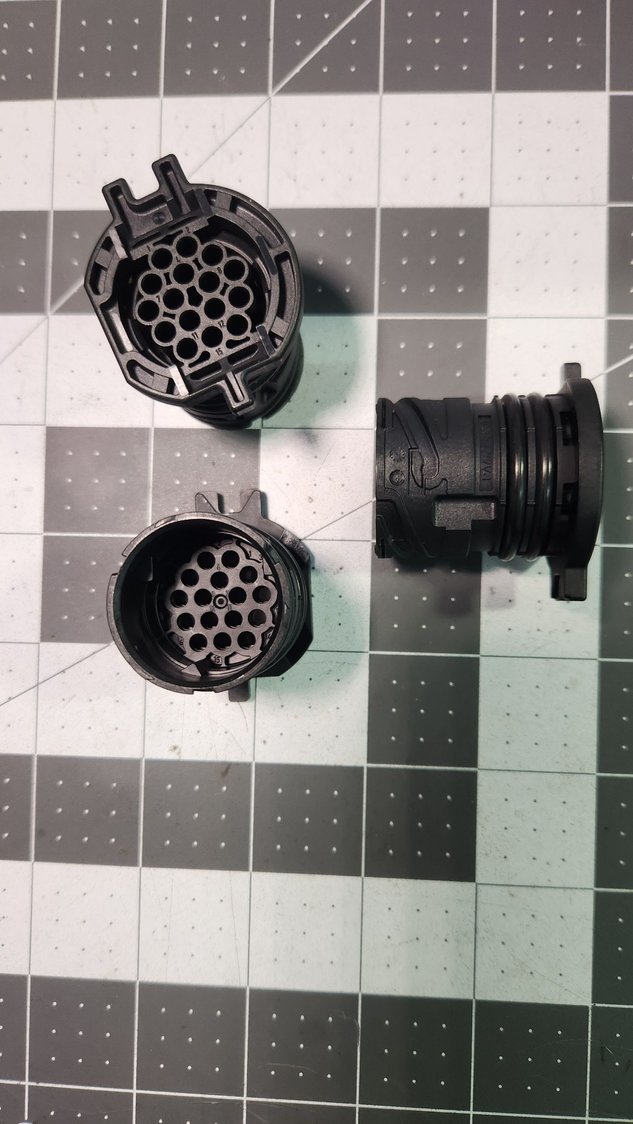

Finally put hands on some of these 6L80 TCM side connectors. Seems they do exist...
