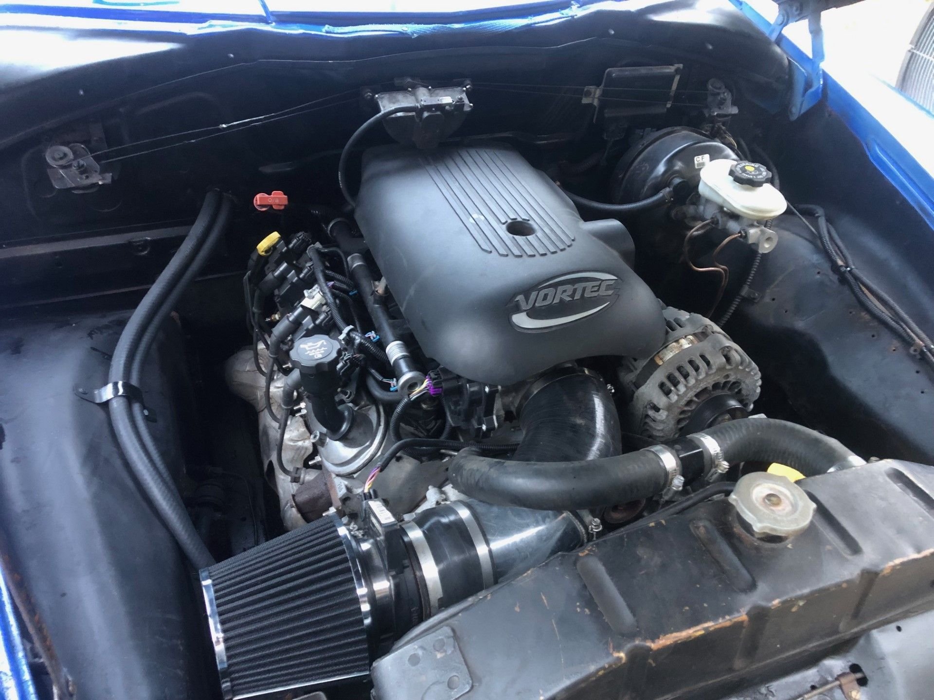

Quick off the top of my head price shows I have $695 in my swap including the fuel system, cooling system, and exhaust. Call it $700. It's a 2003 5.3 and 4L60e I put in my 1951 Hudson from a 2003 Escalade
Engine / trans $0 (bought the whole vehicle for $650, parted out and actually made money, but call it $0
Wiring harness for engine and trans $100 from ebay
Engine mounts $30 from ebay with homemade frame brackets
Trans crossmember is a modified 2nd gen camaro, swap meet buy $20
Trans mount $15
Oil pan Ebay $125
original Hudson radiator used so no cost
original Hudson lower rad hose so no cost
modified Escalade upper rad hose no cost
steam vent adapter and fitting $15
thermostat housing and thermostat $45
heater hoses $20
40k trans cooler from Amazon $75
Transmission cooler lines from the Escalade tied to the Amazon cooler
Shortened Hudson driveshaft myself, needed a conversion U joint $25
Cooling fan is a Ford Thunderbird 2 speed, swap meet buy $25
Relays and connectors to wire up fans $25
Exhaust made from factory Escalade manifolds, a scrap 4th gen camaro exhaust, and a swap meet muffler $25
Fuel tank from a 95 caprice wagon with in tank pump $100
Nylon fuel lines taken from same 95 caprice wagon, free with tank $0
CAI parts and air filter $50
Old Feb 27, 2024 | 06:02 PM

I will be doing another swap shortly into my 1957 International pickup, I can start a build / swap thread and post up pics and costs as I do it if anyone is interested. I should be starting in a month or so as soon as I am done with my 55 Buick. Costs should be about the same, maybe a little more as I may not break even on the donor truck (2004 silverado 4.8 / 5 speed for $500) and I need to buy a radiator. I may cam this one as well, but those costs are not part of doing a swap.
If you can fabricate and use a donor car for the engine and transmission it is absolutely possible to copy what I do and spend very little cash. A $1500 budget should leave plenty of room for surprises, you just have to be creative and not catalog shop unless it makes sense, or you have no choice.

It depends where you live as far as donors, here in the Northeast I can buy a Silverado any day of the week with a rotted frame for $1000 or less, they are everywhere, I know that is not the case to the south. In my videos I explain everything I am doing, and I believe if you have the aptitude and the ability to weld you can do this cheap. Some tools definitely make things easier, but an awful lot can be done with an angle grinder, a cutoff wheel, and a welder.
As far as your 2003, save the transmission, if it is good you can convert it to 2WD for about $100 in parts, I plan on doing one soon as I am YouTube trained LOL. Cant be scared to try it, just have to go for it.
