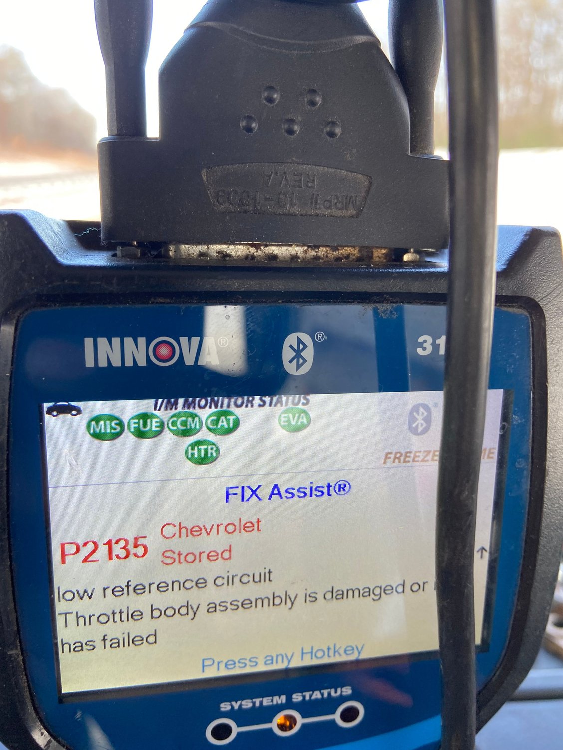

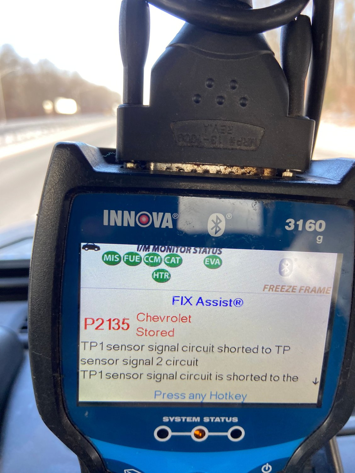

The engine stalls randomly, i notice it happens often when i am approching a stop. I have an automatic with Drive by wire throttle. When it dies i get trouble code P2135. The TPS reads 1.6 % at idle, not sure what the normal change should be on a DBW. I had cleaned the throttle, didnt help.
Also when this happens, i lose the gas pedal, it becomes irresponsive. To get it bad, i would turn the truck off, press the gas pedal up and down a few time, restart the engine amd it would be okay again. One time this happened while driving on the highway, scary and dangerous.

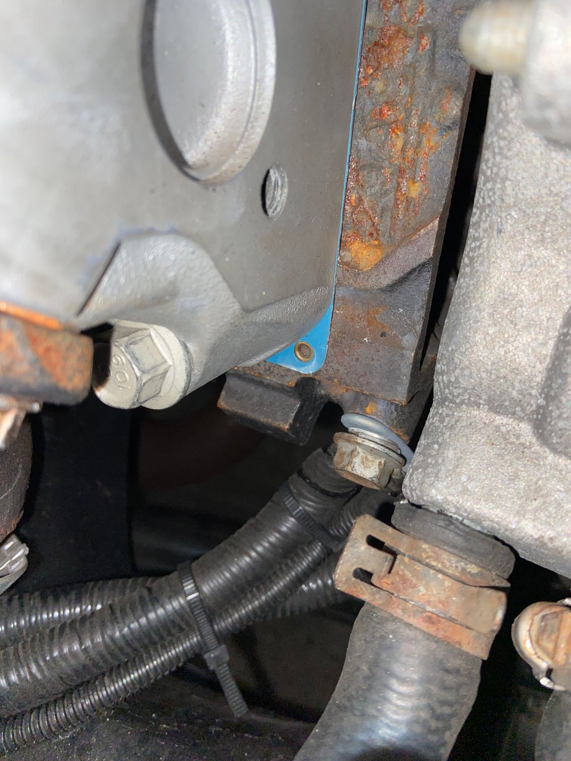

I have the ground wire from battery to engine block mounted on the front passenger side of the engine block, should I move it to the rear of the block, does it matter? See image. The harness ground is at the rear on the block pass side. Should I move the battery ground cable to this bolt where the harness ground is?

You have a hard-on for them TPS values. You put a second Throttle Body on there, got the same numbers. Clearly that's not the issue, as many times as you asked here for them you couldn't type it into Google and find your answer? Start doing some of your own research.
Several of us think it's a wiring issue. Code comes up as shorted, that's a circuit problem, again WIRING ISSUE. Get on Google and find the Schematics for your setup. Get a multimeter and start probing wires. Welcome to the world of electronic troubleshooting.

Your problem is possibly the TPS wires that go to the PCM or a bad ground. Grounds don't matter where they are as long as it's a clean surface, big enough wire, and plenty of them. No such things as too many grounds, I make mine over-kill for my builds and everything works.
