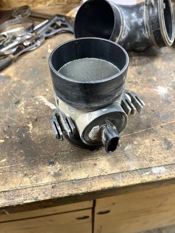

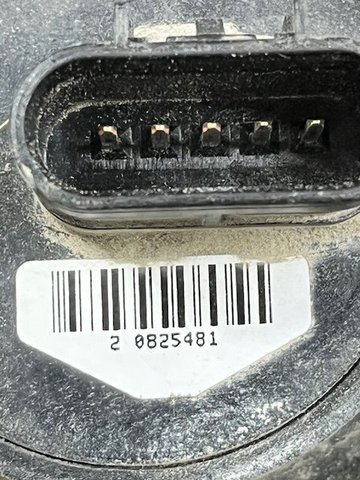

I have an LQ4 out of a 2005 Savana 3500 that I'm installing in a 51 Pontiac. I've purchase a cheap cold air intake that has a 4" tube/elbow/filter etc. that "you add your stock MAF sensor to between the tube and filter housing".. Unfortunately my MAF sensor/housing is not compatible - housing is no where close to fitting (yes I should have looked into this before purchasing intake). So far trying to cross-reference the part number 20825481 is coming up with nothing. Real estate is extremely tight so their is no way of utilizing any of the stock setup.
Can I simply source a different MAF sensor that fits the tube and has the same pinout to get it working? Is this something that can be "re-calibrated" when I have my tuning done??

For custom intake hose and tubing I use Intakehose.com. IIRC they are out of Spokane WA.
Kind of a weird looking MAF. Would a say a 05 2500 Silverado 6.0 MAF work/fit better?

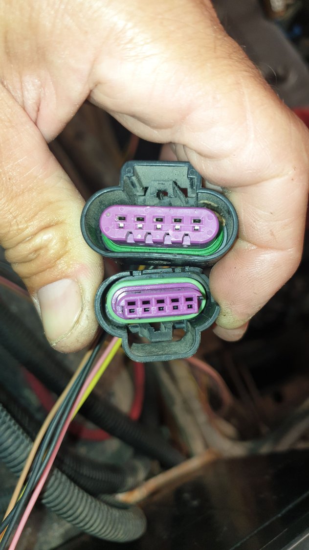

Beware that the blade MAFs have a different connector. It's still a 5-pin, flat connector, but it's larger, AND IT IS NOT PINNED THE SAME.
I had to deal with this on a swap I'm working on.

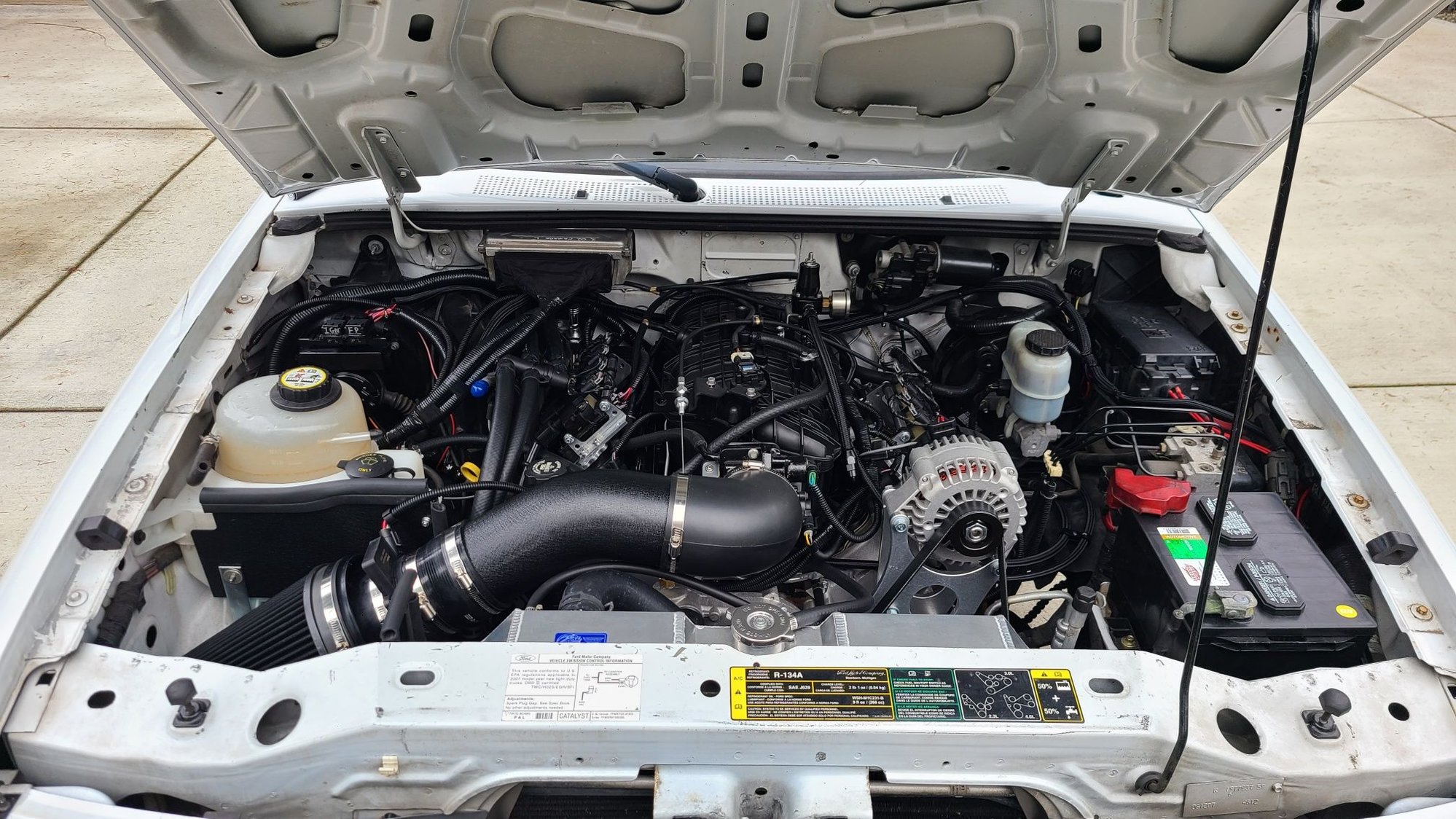

Hey turd, You can get the common early 5 pin Delphi MAF sensor brand new on Amazon for under a hundred bucks and it should play well with your erector set cold air kit.
I put one of these in generic amazon Silverado cold air kit and it worked perfectly. If you are running a stock engine and stock PCM it will be plug and play no tuning.
Delphi AF10043 Mass Air Flow Sensor.
Edit adding picture of MAF sensor.

Ok we finally got to a point where I can start the motor installed. I got a new AF10043 sensor but the existing connector wasn't compatible. Bought the correct connector and compared the wiring schematic of mine to one for a Silverado, and noticed the pinout are wired reverse, so I wired as below. But the motor runs like crap. Disconnect the MAF and things improve significantly.
So 2 questions
1. Can someone confirm the pinout for the AF10043 to confirm my wiring is correct?
Pin A - MAF Signal
Pin B - Power
Pin C - Ground
Pin D - AIT Signal
Pin E - AIT Power
2. Is this something that tuning will/can correct - can you program a different sensor??

As long as the wiring matches the PCM it can be. The curve just needs to be correct or corrected for the combination.
I am now running an LS3 card style MAF in the truck above and when I switched connectors I not only had the wiring order backwards but totally mixed up.
I knew it was wrong when it would just start and die. (maf only tune at the time).
Once I corrected the wiring I was able to get the MAF tune correct.
