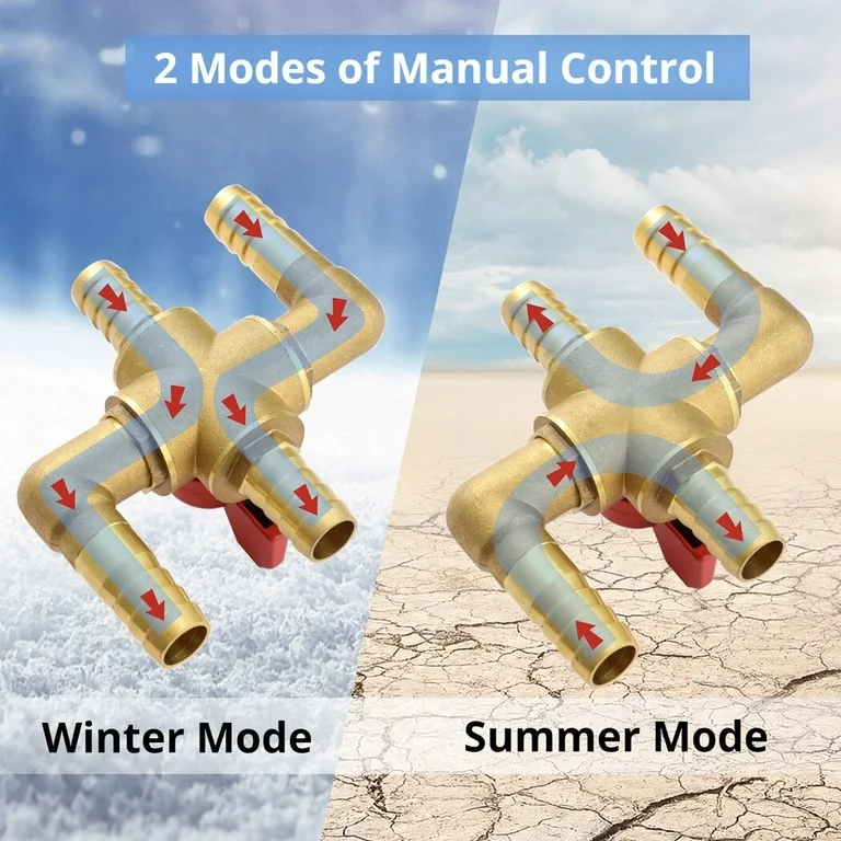

1978 Caprice. LM7 5.3, 4l60e. All stock, daily driver swap. (sorry, some of earlier pictures have stopped working)
https://ls1tech.com/forums/conversio...5-3-4l60e.html
I looked into a lot of options for blocking off my heater core during the summer. I wanted to keep things as reliable and simple as possible as this is my daily driver that I've had for 27 years. I decided to go with this option, and will choose to manually turn the valve at the beginning of each season. Also, I've purchased a heater core restrictor, which on older cars like mine prevents the water pump from over pressurizing the heater core and causing failure (I found this out the hard way when I didn't include one and my heater core was damaged). I'm thinking that if I use the partially opened valve as a restrictor, then I may not need to add the stand alone restrictor, causing one less set of clamps and an extra piece under the hood (the factory GM restrictors are plastic and are known to fail with age).

This seens fairly simple and you only loose 1 cup of coolant .
A restrictor or shut off valve on the inlet will not change the pressure in a heater core.

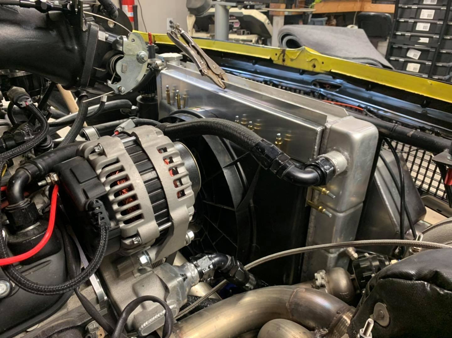

I run this block-off made by Jaywire. Blocks off the bypass. The bypass (you can feel the passage easily with your fingers) routes hot coolant back in the engine.
#racecar
