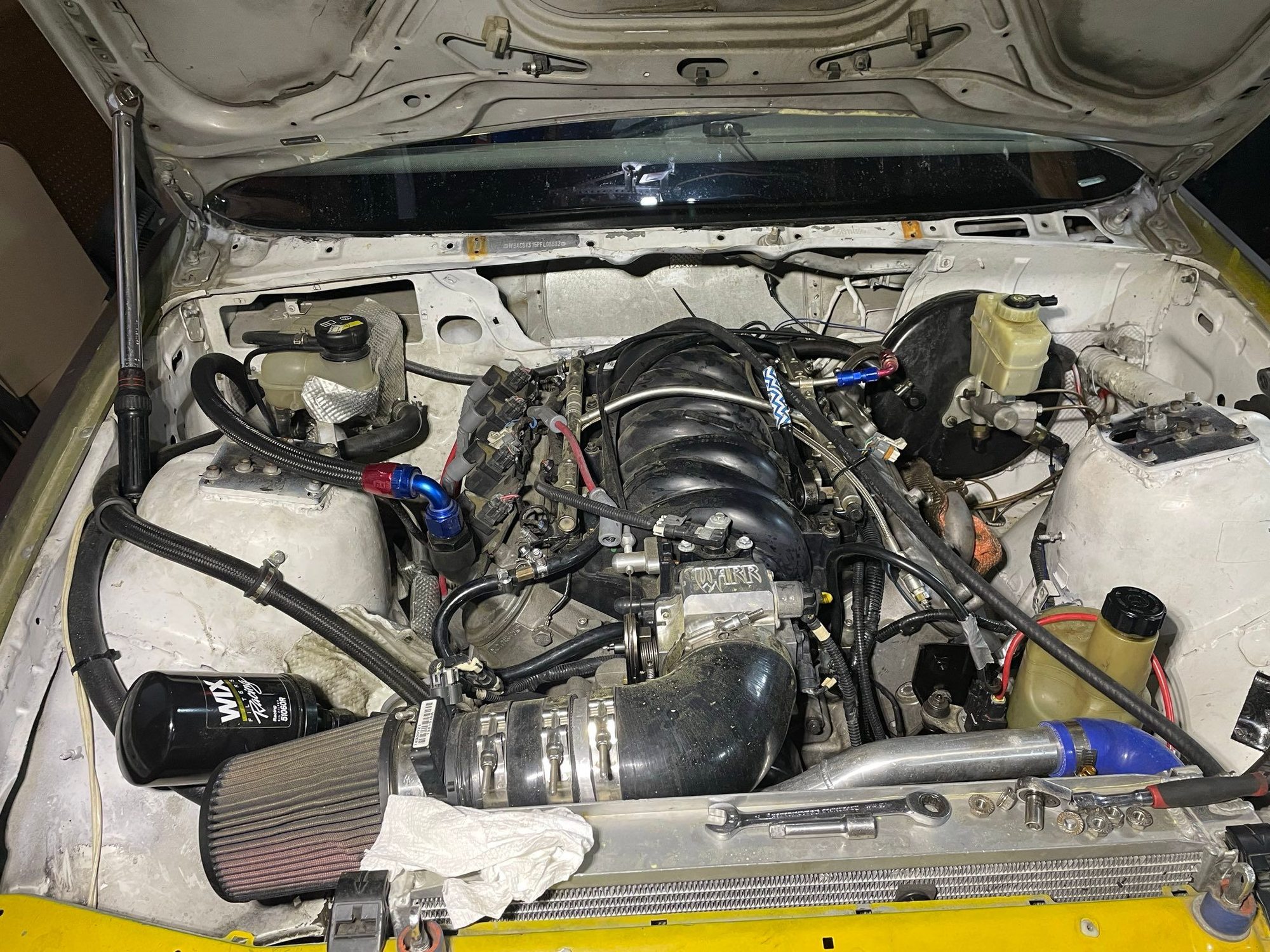

Current engine compartment - and yes, that yellow stuff is pollen....
Very much appreciate the help / ideas.

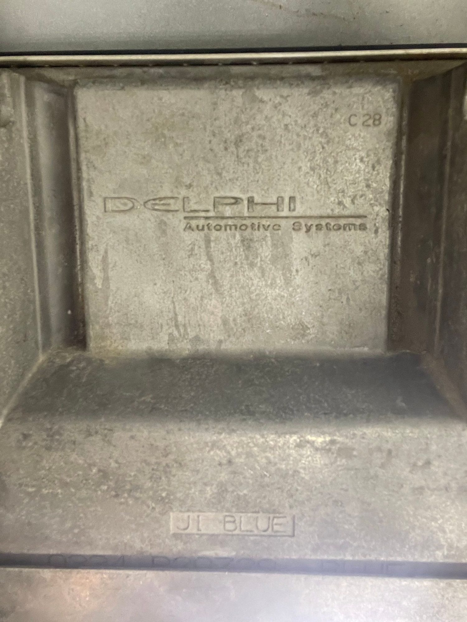

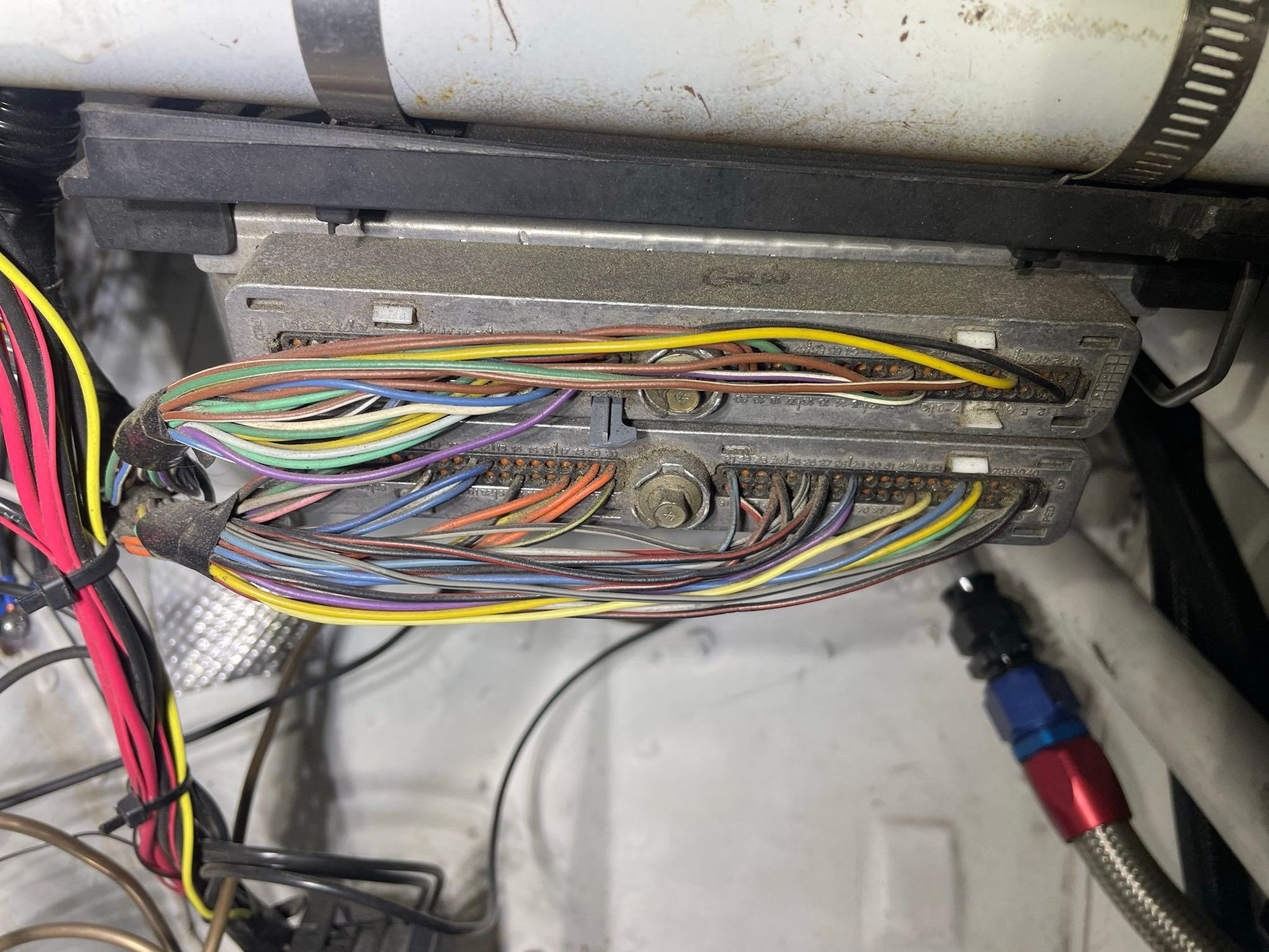

A picture of the current ECU will tell us what it is.
Old Apr 13, 2025 | 07:16 PM
joeo's Avatar
Joined: Dec 2024
Posts: 18
Pretty new here - so no, I've not seen that thread. Thank you! What a build! I looked under the car briefly for the crank sensor near the starter, but could make it out. Here is the current engine computer:
Old Apr 13, 2025 | 07:53 PM
LS1 TJ's Avatar
Joined: Sep 2008
Posts: 1,660
Likes: 532
Total guess on my part but the pic above is a 24 tooth LS1 ECM. It can control both the engine and auto trans.
My 98 Wrangler with a LS6/4L60E swap the ECM looks similar.
My 80 Camaro with a 2012 LS3/4L60E the ECM looks totally different from the pic above. With a 58 tooth engine you need to have a ECM for the engine and if running a auto a TCM controlling the auto trans.
