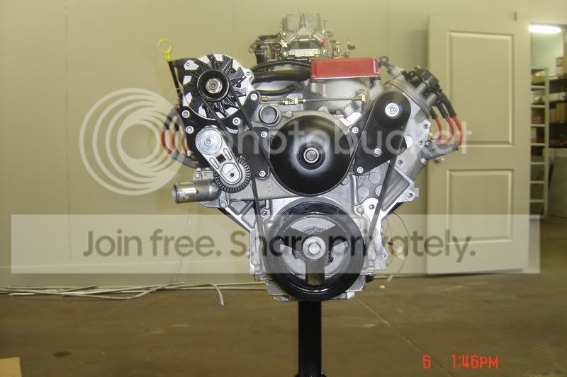

Factory F-Body mounting allows for just an alternator, water pump, and the tensioner mounted on the water pump assembly. I have my LS1/RX7 done this way.
It's a ~52" belt. The routing goes crank -> alternator -> under waterpump -> tensioner -> crank. Pretty simple.

stainless works makes an alternator relocation bracket which moves the alt. to the upper passenger side and uses the stock tensioner pulley and alternator. BMR makes an alternator only bracket that mounts in the stock location (lower driver side) but is a good alternative if you dont already have the stock alternator bracket.

Get an electric water pump and the BMR alt bracket then all you will have is just one short belt from the crank pulley to the alt, and you can ditch the whole serpintine belt system including the tensioners and brackets....nice and clean!
