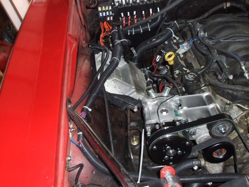

mine's under the hood on the inner fender, and there is barely room for it--had to relocate it this weekend when I mounted my AC compressor (Sanden SD5H14 w/ kwikperf brackets). I need to redo mine and put it inside somewhere.
