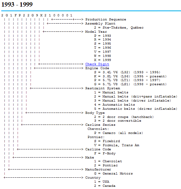

Try this. It looks like the last 6 digits are sequence.

Originally Posted by 95TAGary
How do you tell when my car was made on the production line? Is it in the VIN #.?
Yours is one of 2,402 '95 T/A 'Verts built.
http://www.marshu.com/ws6-car-gm-fir...-2000-2001.php
The last 6 digits in the VIN, as was said, is the plant build sequence number. Since all 4th gen Firebirds and Camaros were built on the same line at the same plant, this would be the sequence it came down the assembly line behind all other Camaros and Firebirds for that model year.
