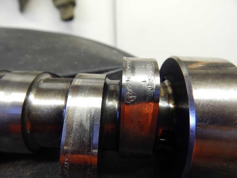

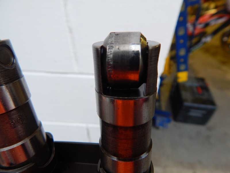

Fast forward to this spring, took it out to the local speedway(KY Speedway) and got to do 30+ laps in the car along with a few buddies in their cars. Had a bit of ticking after getting it home which promoted some poking around. Cam was flaking/grooving and it was evidently hungry and ate some lifters. By this time I decided to pull the motor and survey the entire motor/clutch.

Carnage pics from old cam. The pattern it left on the lifters is strange to say the least. Looks as though the cam itself started flaking off and took the lifters. Maybe someone with more valvetrain insight can say. It had fresh BTR .650 platinum springs on it. The ones I replaced were duals and didn't seem wore, I changed them for peace of mind Odd thing is, it kept great oil pressure and only had a slight tick at best. I thought for sure it would be a minor scuff on A lifter, not 7 missing pieces of the wheel and a destroyed cam. Pistons, rod bearings and most everything else looked alright considering. Mains bearings were toast.

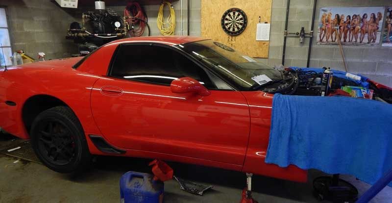

The car just waiting for more parts, going to start cleaning things up while waiting. Front cradle is horribly dirty and I need to remove the air pump, rest of the exhaust and torque tube. Don't mind my dirty garage.... I'll clean it before posting any more pictures of it ..... ha
