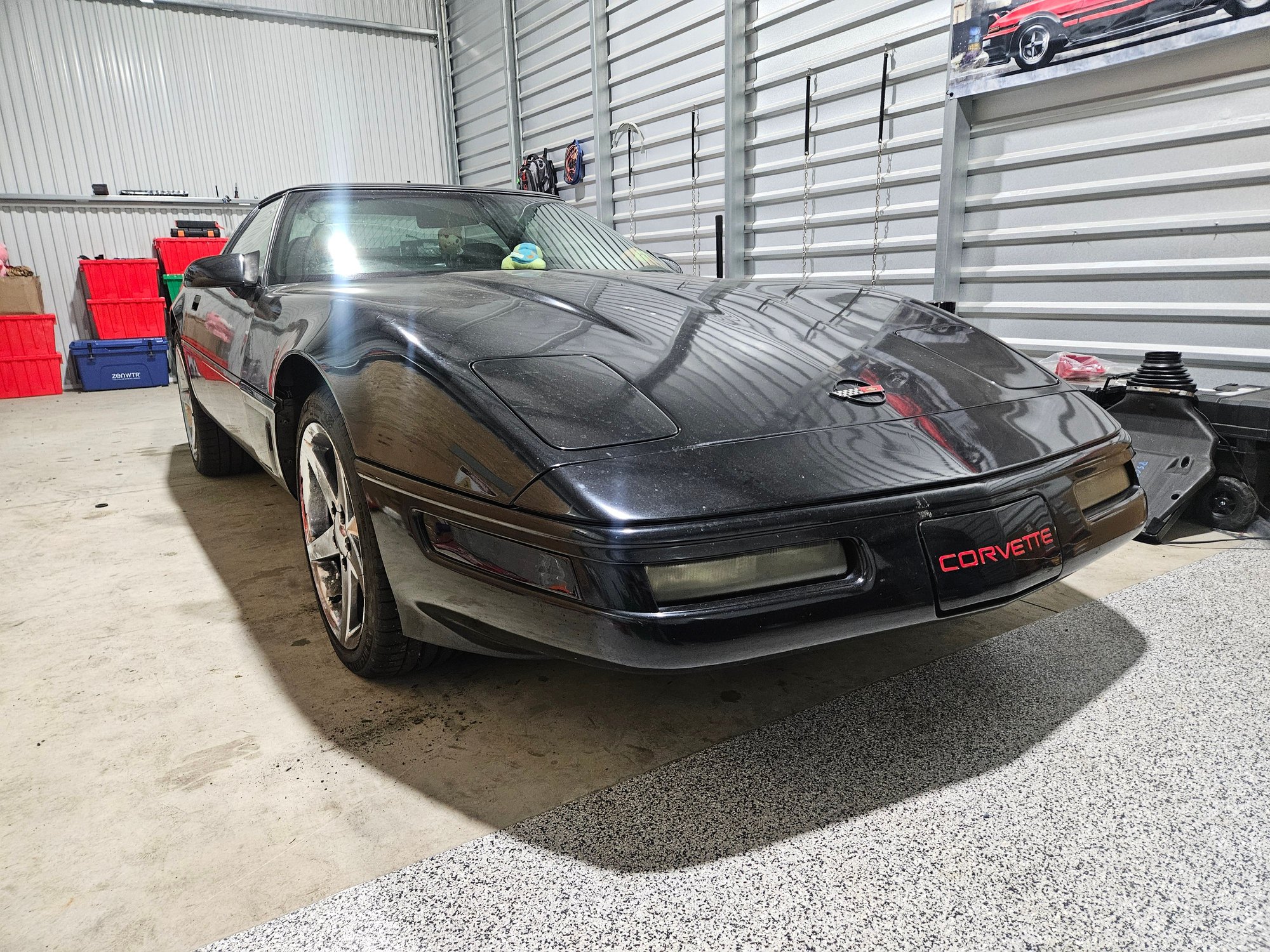

Hello , I'm going to give some basic background knowledge of what I own. Whats done so far. As well as my main goals for the project over the next few years. And ask for help with parts I'll need to achieve my goals.
As it sits i own a tmk stock 95 corvette paird with a 5.7l and a 6spd manual. It performs about as I expect when compared to my peers cars , 02 Cobra, 03 350z , 06g35x. No major modifications at this time. Simple stuff has been done short throw shifter, hi flow performance cat back exhaust, shocks replaced, new pads, gaskets replaced on the valve covers, new weatherstrips, new visors, new roof, taken the cluster out for repairs, as well as other things like lights, and headlight motors. Not scared to take things apart, put in work , or spend money.
with that said I am mapping out my plans with the car, easy stuff is being done and will eventually be complete so id like to move onto mote complicated points. It's got good power I respect the car for it's age but ultimately I am looking at bumping up the stock 300/340 figures closer to the 400+ range at the wheel.
I am planing on doing American racing long tube headers with hi flow cats to match up with my hi flow cat back system. After that I would like to focus on the meat and potatoes. Heads , cam , rockers, push rods?( this is where you guys can help the uninformed) iv never dug this far onto a vehicle, I do have help with working on the car but even my dad can admit when it comes to cars with ecu's it is not the same as with carb cars.
I was looking at kits at first but that seems the wrong way to go. After reading around iv been lead to believe the - Afr comp eliminator ported 195 heads are a very good choice for my motor and my goals im not sure if i should go with the 65cc or 75cc versions though. I'm also reading that potentially the scorpion 1.6 rockers would match well with the heads. I'm looking for any other suggestions on parts that would be necessary to support this setup. I believe id need a cam? Hardened push rods of appropriate length ? Upgrade to full aluminum radiator + silicone hoses? New water pump? New timing chain ? Again looking for any suggestions or anything I'm missing. I want a solid car that makes around 400 at the wheels i could daily drive if I wanted. This is a second car to me and I am not depending on it to be running at all times but i definitely want it turn key ready. Oh I also know I will require a tune. I am looking around at local shops and/or tuners who can help make a safe and reliable tune for all these parts I plan to put on my car over time. I live around Portland, OR. Thank you for your time.
