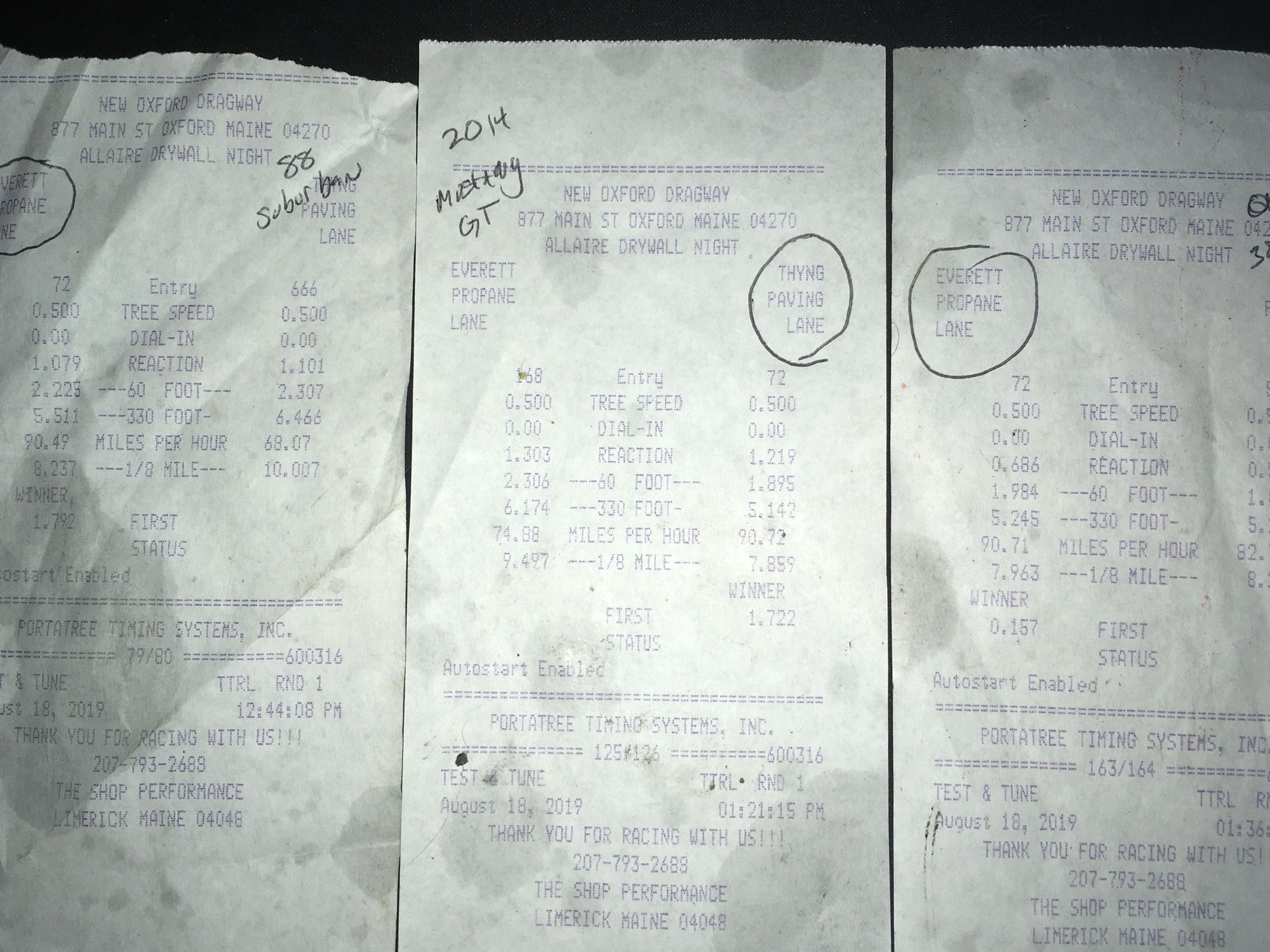

April 2019 I bought a cam only camaro from a forum member. Shortly after that I took it to a local 1/8th mile track to get a baseline with the current mods that the PO installed:
Lid, LTs, ORY, BTR stage 3 cam, Yank SS3200, milled 241 heads, ported throttle body, UDP, NT555 (non R, Non drag radial) Stock springs, Decarbon shocks (wasted), PO said 3.42 gears but the door code says 2.73 10 bolt, Auburn LSD, SFC's, full weight on 93 oct.
Results:
DA 2400 / 95% humidity / 90f
I did 4 runs but lost 1 slip. Tires @ 26psi best 1.895 60ft. Not bad for bone stock suspension and some nitto 555's

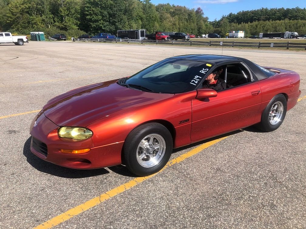

Got down to New England Dragway Sunday for a few passes. It was 79f degrees 39% humidity with a DA of 1188 ft.
MT Street SS tires @ 18psi
Coincidently; First pass I lined up against a 2007 C7 Vette M6. LS2 Tsunami cam with supporting top end, 3.73's, full exhaust, intake.
I got a decent launch - Me in the Right lane.
I parked to look over my slip and the vette parked right beside me. He said he missed 3rd and needed to adjust his AFR; the guy wanted to run them again
So we switched lanes and lined them up.
Guy was wicked nice. Told me his next plan is to go Turbo with a RPM stage 4 tranny.
I need to make some more changes to the adjustable LCA's and I'm in desperate need of shocks. I wont have those until next season though so looks like my 60ft wont improve much. Thing just doesn't want to squat without some shutter rebound.
On another note, the rear axle didn't blow up after I swapped all the bearings. This was a concern of mine considering I never checked the gear mesh after setting the backlash. Well I say concern. I never thought twice just sending it. lol
Overall I had fun and plan on running again next Sunday with a few more things up my sleeves.

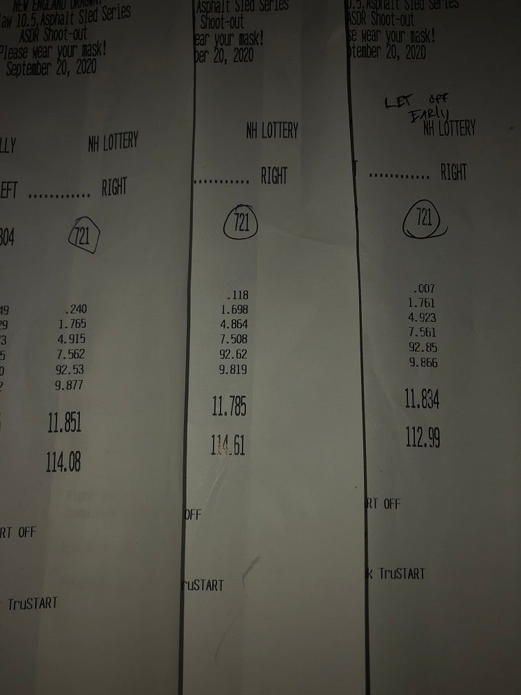

I got down to NE Dragway for another go at getting into the 11's.
Track conditions were favorable with DA between 150ft and 450ft.
Tires @ 16 psi
5/8ths of 93oct with a bottle of Lucas Octane booster. (to make sure I have at least 93oct)
Weighed In @ 3670lbs with driver
I got 3 runs in.
First run I adjusted the LCA's to show 3 threads. It hooked and booked.
Second run I adjusted to show 4 threads. Gave it a bit more RPM at launch. Best 60' of the day.
Third run I adjusted to 5 threads. This run I was racing a friend so I went after that reaction time.
Gave it a bit more RPM and she broke loose. I pushed through the 60' with a little tire spin. Let off early.

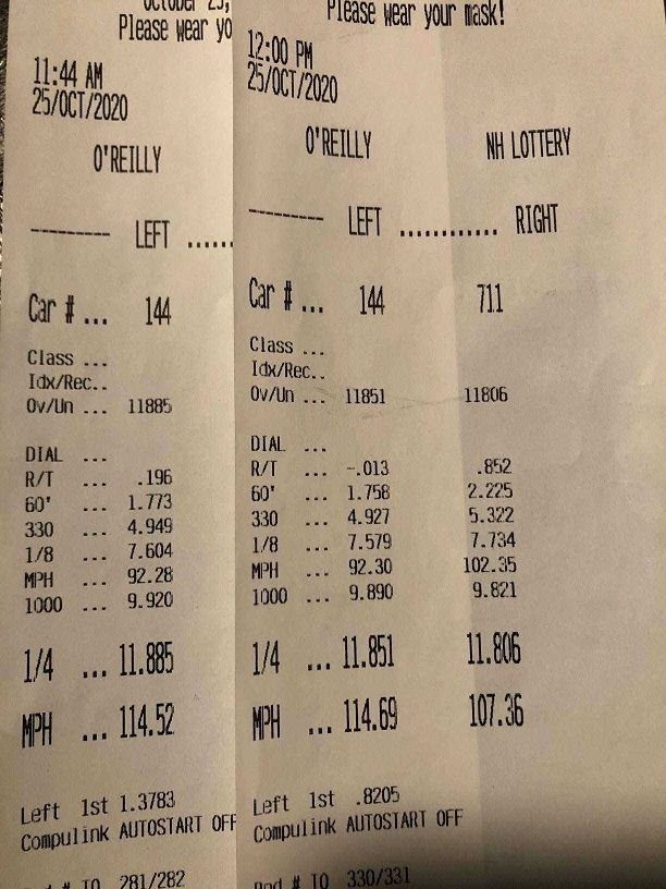

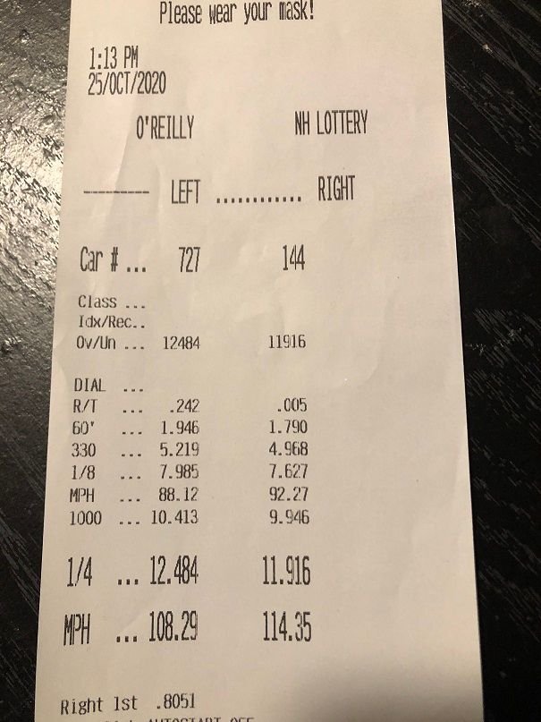

Oct 25th 2020 I made it out to NE Drag way for one last go of the season. Unfortunately I didn't achieve my goals but I still took it as an opportunity to fail and pick myself back up.
I filled up with some 5 gals of 109 oct which left me with a full tank of fuel. Guess I was going full porker on this one.
Density Altitude: -1265 feet
Relative Density: 103.75 %
I'm car 144.
First run: I launched @ 2400ish rpms but it felt like a dog but I didn't take anytime to look anything over. Car weighed in @ 3790 with me in it after the first run
Second Run I hot lapped it: Launched @ 2600rpms felt better but something was still off. I got flagged down at the end of the track, spotter thinks he sees oil under the car. I take a look under and there is some oil but nothing leaking. I took it to the pits, wiped everything down real good and went back to the staging lanes.
Ran two more times back to back launching right around 2600-2800rpms.
After the second run I was waved off the track again and god darn it all I was covered in oil again.
I searched around and low and behold the valve cover breather was 100% clogged which pushed the lowered crank seal out causing it to leak.
I made a custom catch can out of a Gatorade bottle, some duct tape, shop towel in the bottle to act as a baffle and cleaned up the underside once again.
Darn it.... Still not feeling right so I go back to the pits for lunch.
Final run was a dumpster fire. Trans was cooked, brakes couldn't hold 2800rpms and I pushed through the stage. Trans dropped to neutral on deaccel, wouldn't rev, lost brakes and almost met the sand trap. Unfortunately for me the spotter noticed my lack of stopping power and proceeded to yell at me. Oops! I apologized. After I lengthy restart, the trans decided it was okay after all. As if though nothing even happened.
Back in the pits I discovered the panhard bar was lose causing me to squat so hard, the rear wheels were rubbing on the quarter. ******* burned right though the paint and chewed into the tires.... Why the hell I didn't think of this sooner when it was "running like a dog" perplexes me. Oh well, I'm out here to learn am I right?
