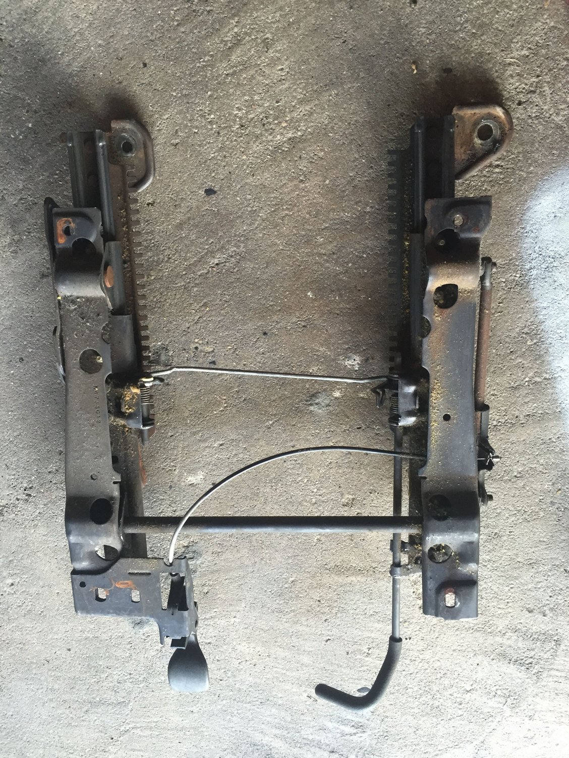

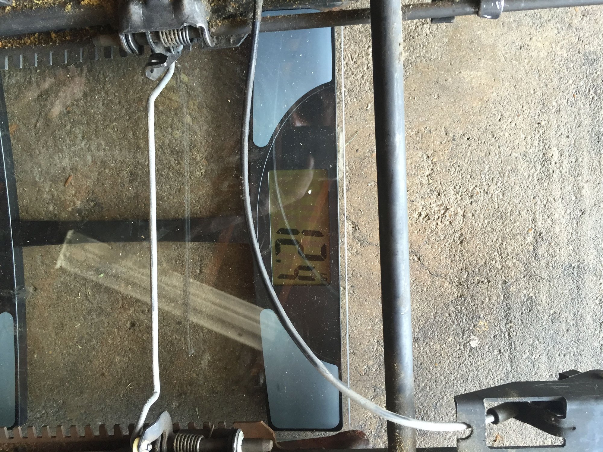

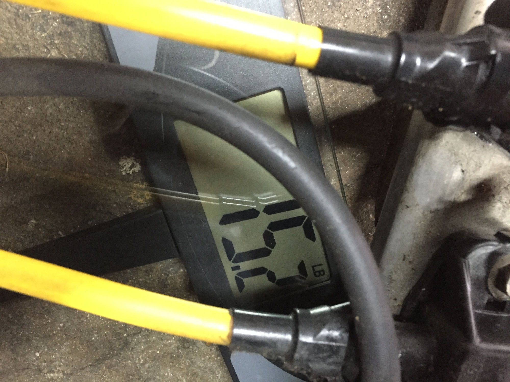

Default The weight difference is about 3lbs.. Idk if it's worth it..
Manual frame
Power frame
15lbs for power
12lbs for manual
At least I got paid for the job when I found this change under the seat lol
Keep in mind that this is a bathroom scale so it's not the most accurate for lightweight stuff..

Originally Posted by 346only
Wow, I've always read 7-10 lbs lighter for the manual.
Well the bathroom scales are not very accurate for weighing little things but there is NO WAY it's a 10lb difference.. The most I'd give it is 5lbs max difference..
