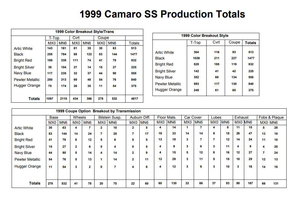

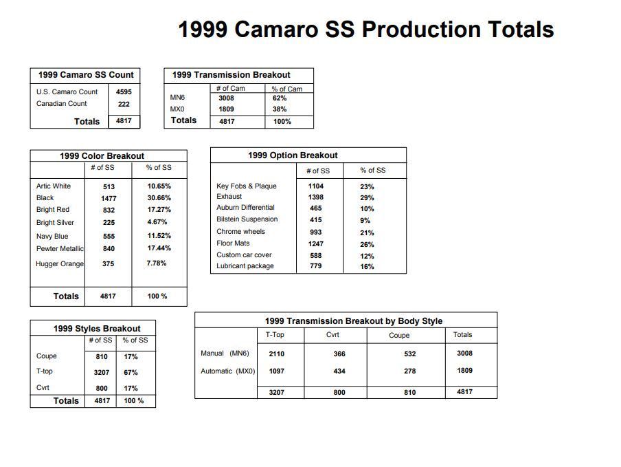

I actually would like to determine how many cars were manufactured identical to mine from the factory.
It looks like there were 54 1999 Hugger Orange SS Camaros produced with a hardtop and a manual transmission. How do I see how many of those 54 came with no power windows, locks, keyless entry etc?

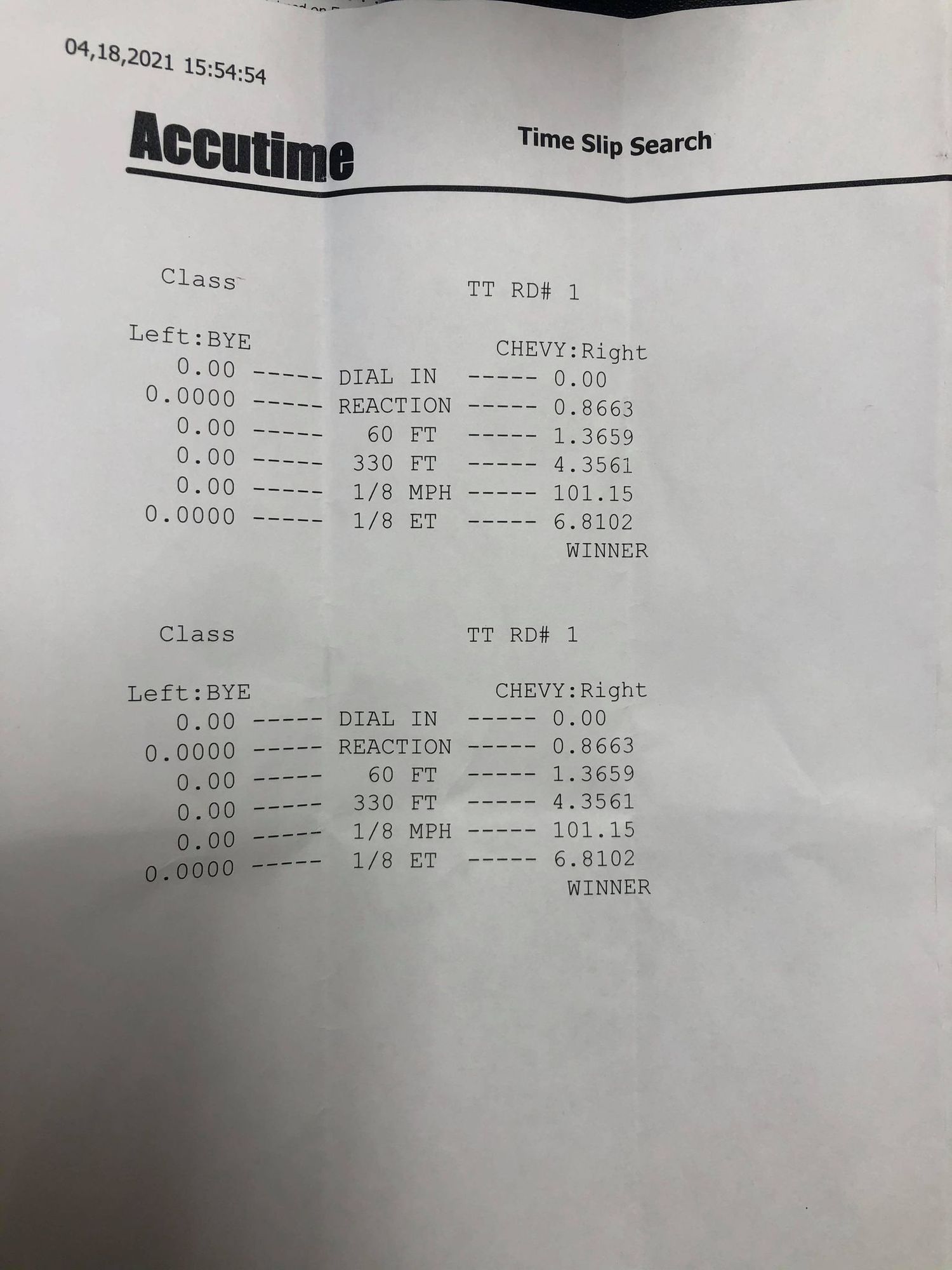

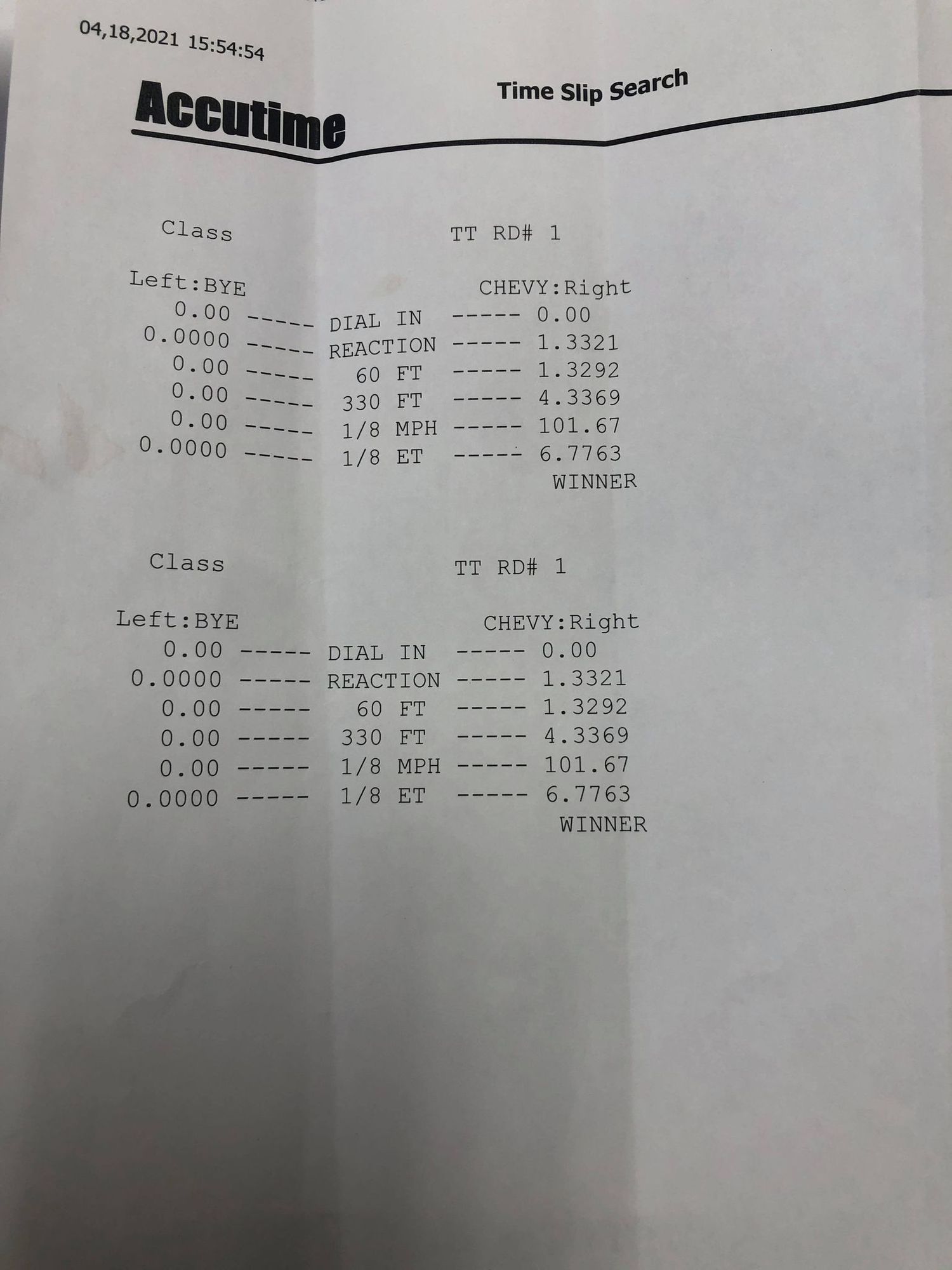

Here is the link for the first track outing. I will post of the slips later today!
Top slip is 1st pass in video, middle is 2nd and bottom is 3rd.

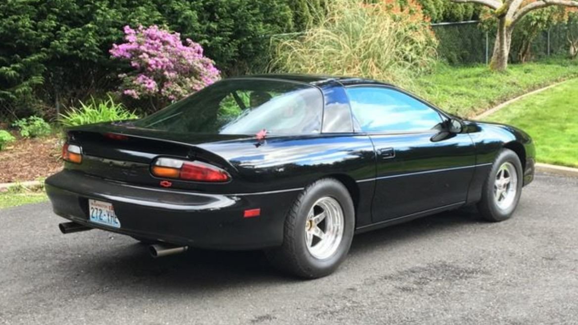

I have had my 2002 1SC since 2008. Bought it with 8500 miles, now, 13,000. I just keep improving on it.
Life keeps throwing me curve *****, getting close to getting it done.
Keep up the good work.

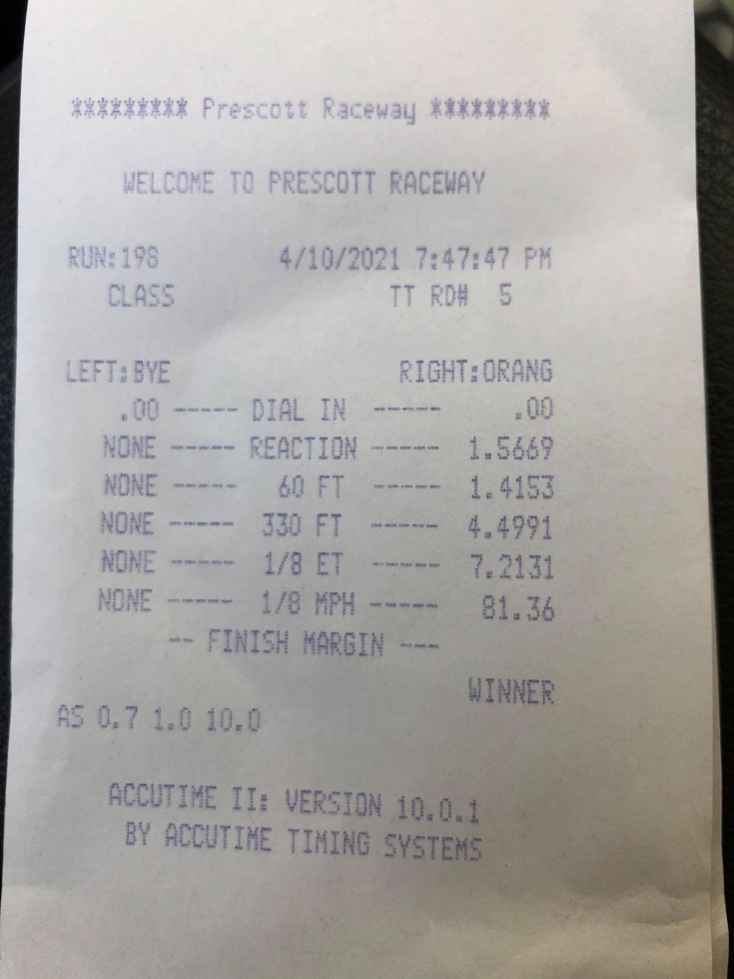

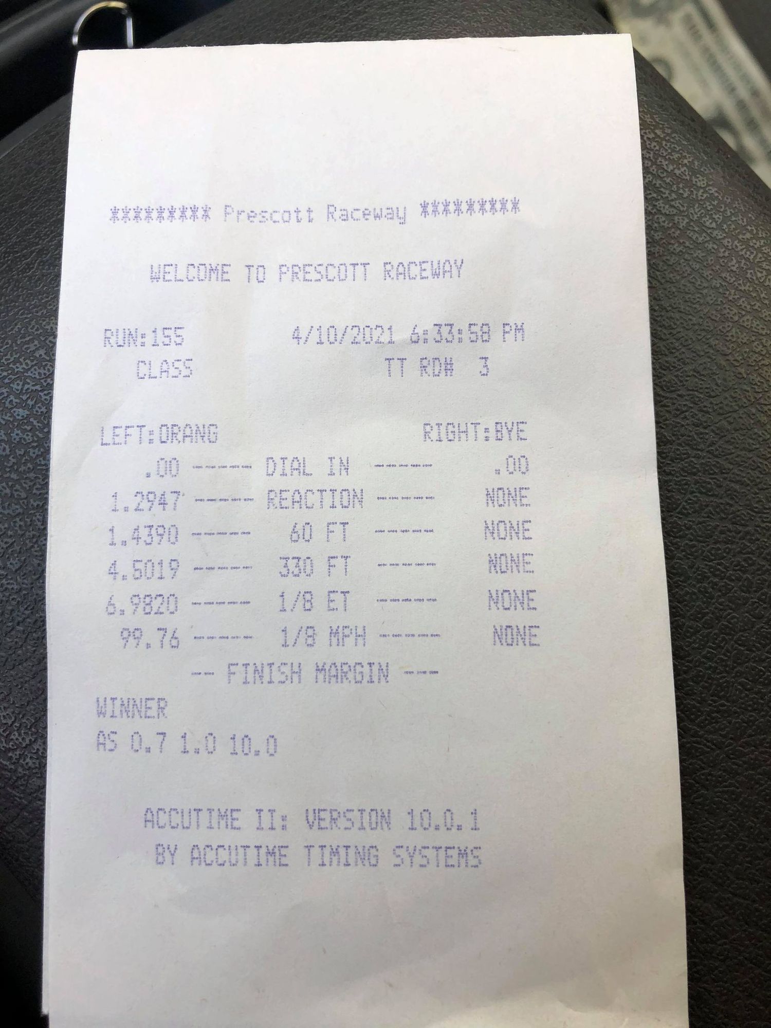

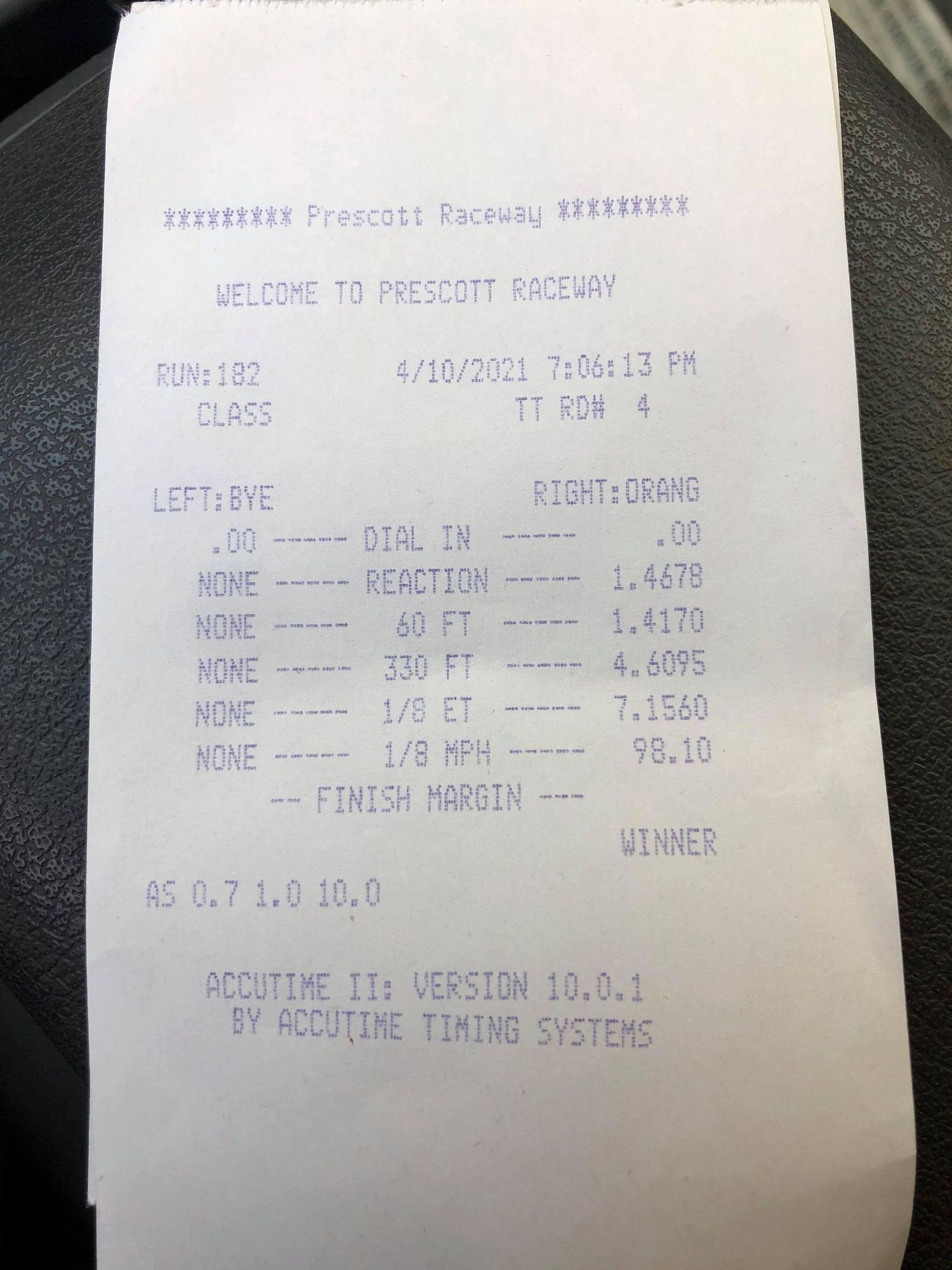

Here are the time slips from the 2nd outing at TNT.
I lowered the Launch RPM from 5,000 to 4,900 and dropped about 40 lbs off the rear of the car and pulled the air filter out of the lid. No other changes were made mod wise. No suspension changes.
Track was prepped for 150ft out and the track was solid.
I started to shift a little better and made sure I was running the RPMs a little higher after being more comfortable in the car.
