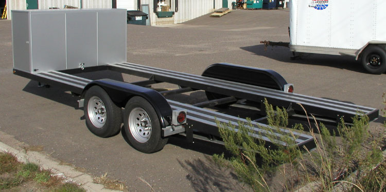

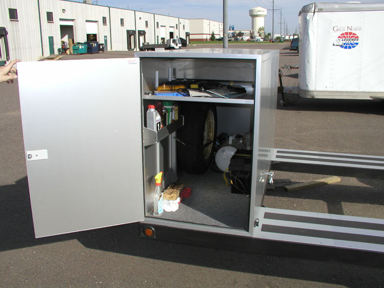

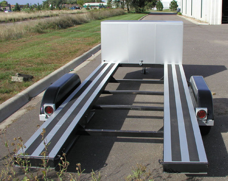

Originally Posted by J 98ta
Here are some pics of the trailer.
http://j.cz28.com/trailer1.jpg
http://j.cz28.com/trailer2.jpg
http://j.cz28.com/trailer3.jpg
Custom made by myself. I am very happy with how it turned out, but spent more $ and time on it than expected. Tow with a 99 Yukon 3.73's and 112k miles....
'J
http://j.cz28.com
jman812@hotmail.com
That thing is very purty

Thanks for the compliments Guys !
As for selling them, I do not believe there would be many people willing to dish out that kind of money to make it worthwhile for me. I have more $ in materials than most half-decent trailers cost complete.....But it does have a winch, batt, etc. I think I went overboard, but it really works well for what I use it for. I have approx 2500mi on it this year with my car on it, and no problems so far. Even had an Impala SS on it for a trip. I made long ramps ~75in that slide out the back on nylon, that helps for my low car loading. It is pretty quick and easy. No tilt, but it does rock with the weight when I drive the car on. Removeable fenders for opening door on trailer (again my car sits pretty low).

Originally Posted by GM Muscle
Quick question for you guys with low boy open trailers. Is their enough room for you to open the door and get out over a door bar. I went and looked at a couple tonight and my doors will deffinatly hit the fenders and I'm not sure if there's enough room to get out over a ddor bar. I'm not sure on the width but it was the widest open one they had, maybe 8-8.5' (just a guess).
I can. I do not have a door bar, but my car door can open completely. I made removeable fenders just for that purpose. I figured once on the trailer, I did not want to "Dukes of Hazzard" it all the time. If I winched it up, I would have no way of closing the window if I needed to steer at all pulling it up. 102" overall is the legal widest I believe, maybe different in some states. I am 81" for platform. I designed it with just enough room to get the door open with fender(s) off. I looked for the shortest tire with the load rating I needed, and made the trailer as low as I could. My car sits pretty low, especially with the y-pipe.
I would look for something you can get the doors open on. Much nicer.
