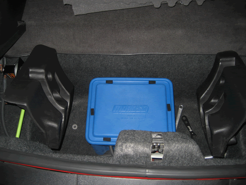

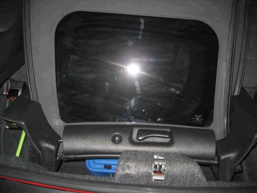

Why won't it fit into the spare tire area? Look at the photo from burkharts site. I also had a battery in my spare tire area without issues.

they removed the bracket that holds the power attenna, plus their aluminum bracket is raised above the floor a bit.
the mini tub might have cleared some sheet metal out of the way also
btw I'm using a Summit plastic sealed battery box

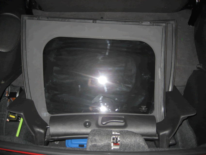

I put mine in the middle of the trunk, and I just finished relocating the T-top holders. I can take pics if you want.
yes if you could show pictures that would be great!

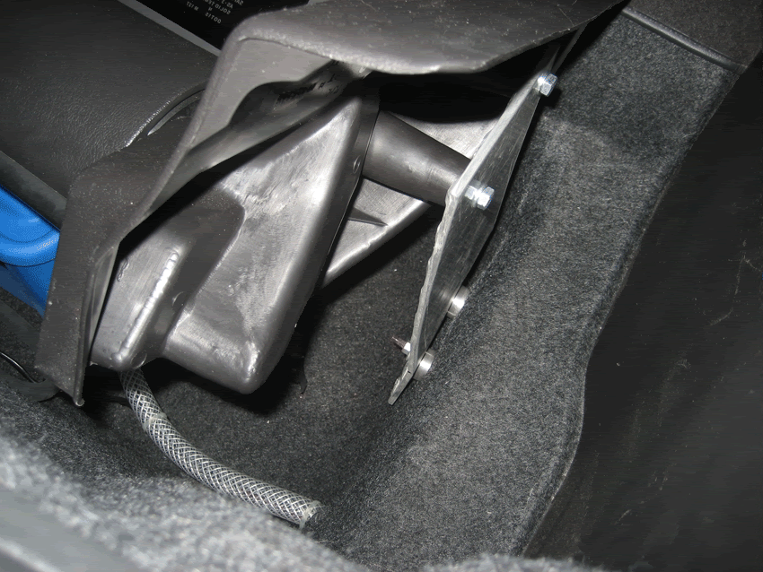

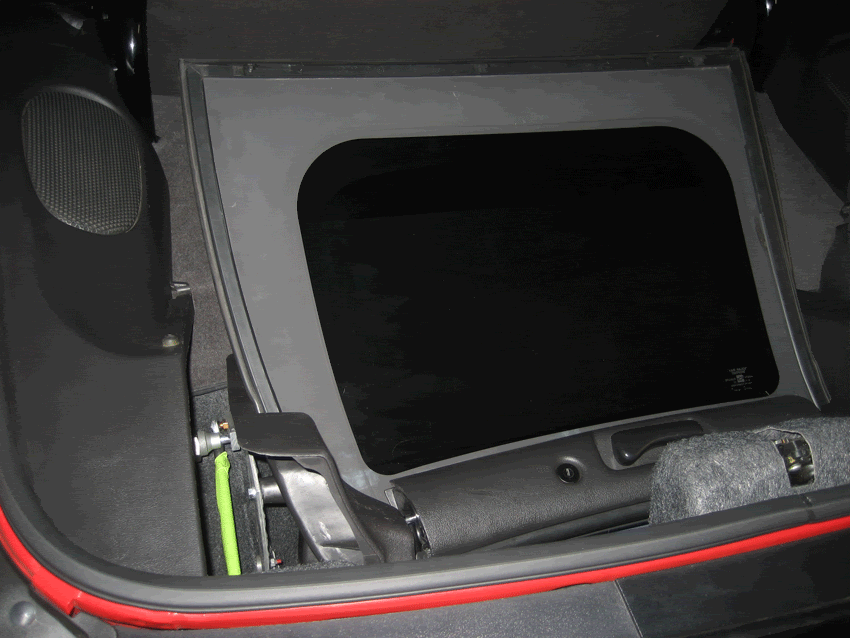

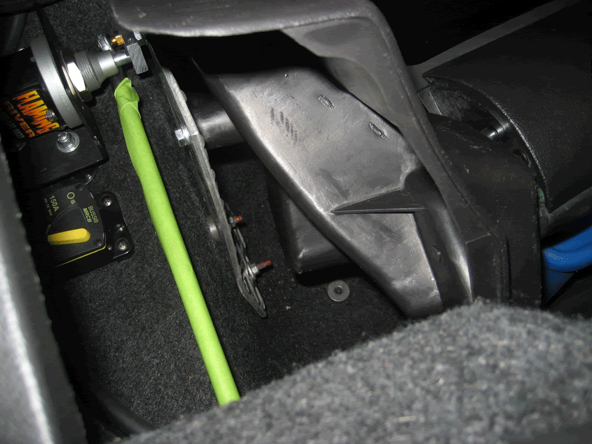

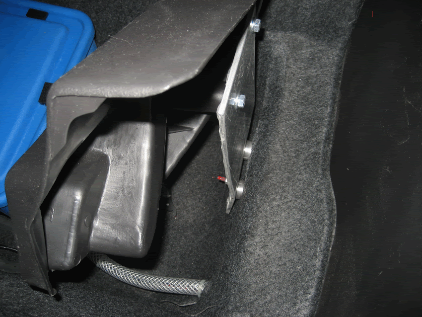

Hope this helps you

When I get time I'm gonna paint everything black and add carpet to make it look more concealed. And there is plenty of clearance between the T-tops and the hatch

did you just raise 'em straight up, or did you lean them towards the front of the car any?

For the most part they are straight up but we also bent the diamond plate on a slight 45* because it doesn't line up just right if it straight up only. You can kinda see the bend in the last pic. Also it has to be shimmed or it will be too wide and the tops will fall out.
