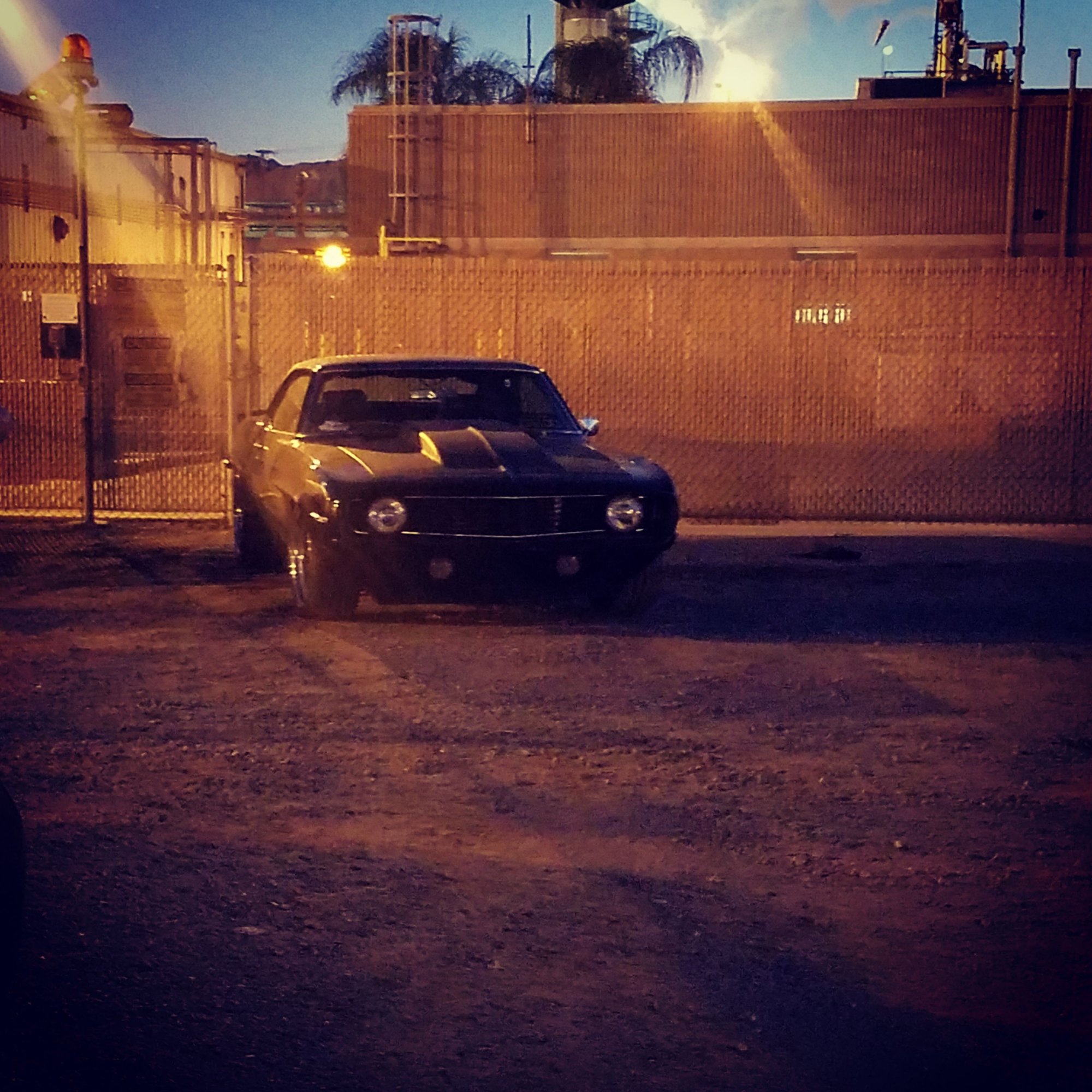

Originally Posted by newchevyman
Impressive numbers. Post some pics of the car, those wheels look awesome in the dyno pic.
thanks they're HRE 540 18X9 AND 18X10
First time out of the garage in 3 1/2 years in this pic.

That car and that dyno curve. OMG beautiful.

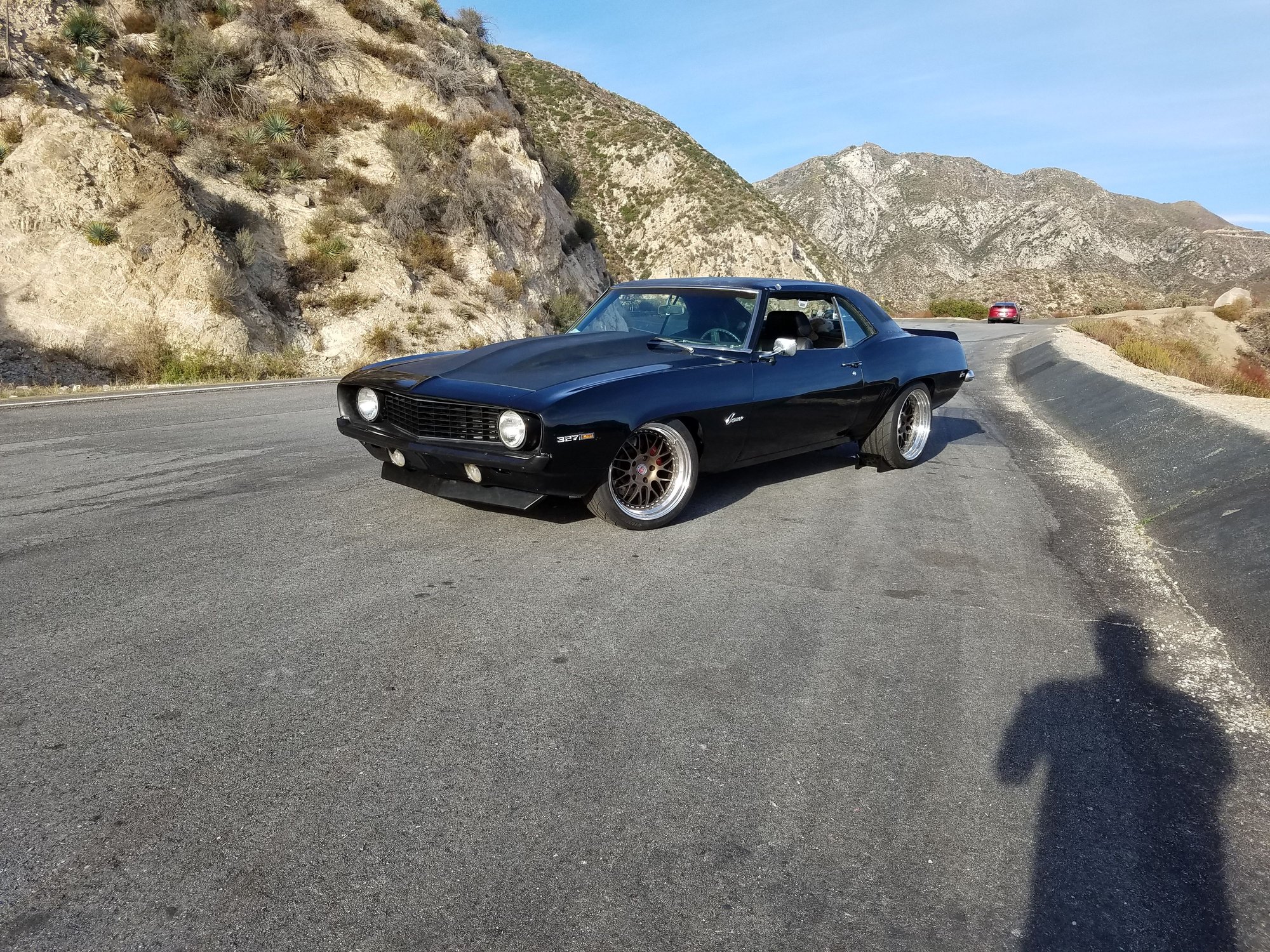

thanks a lot man ive been driving it 60 miles a day to work every day it doesnt rain out here lol. Averaging 13-15 mpg depending how bad LA traffic is
The car is running heidts suspension parts hotchkis sways unisteer rack wilwoods all around w rs3 hankook rubber all around its definitely addictive.
