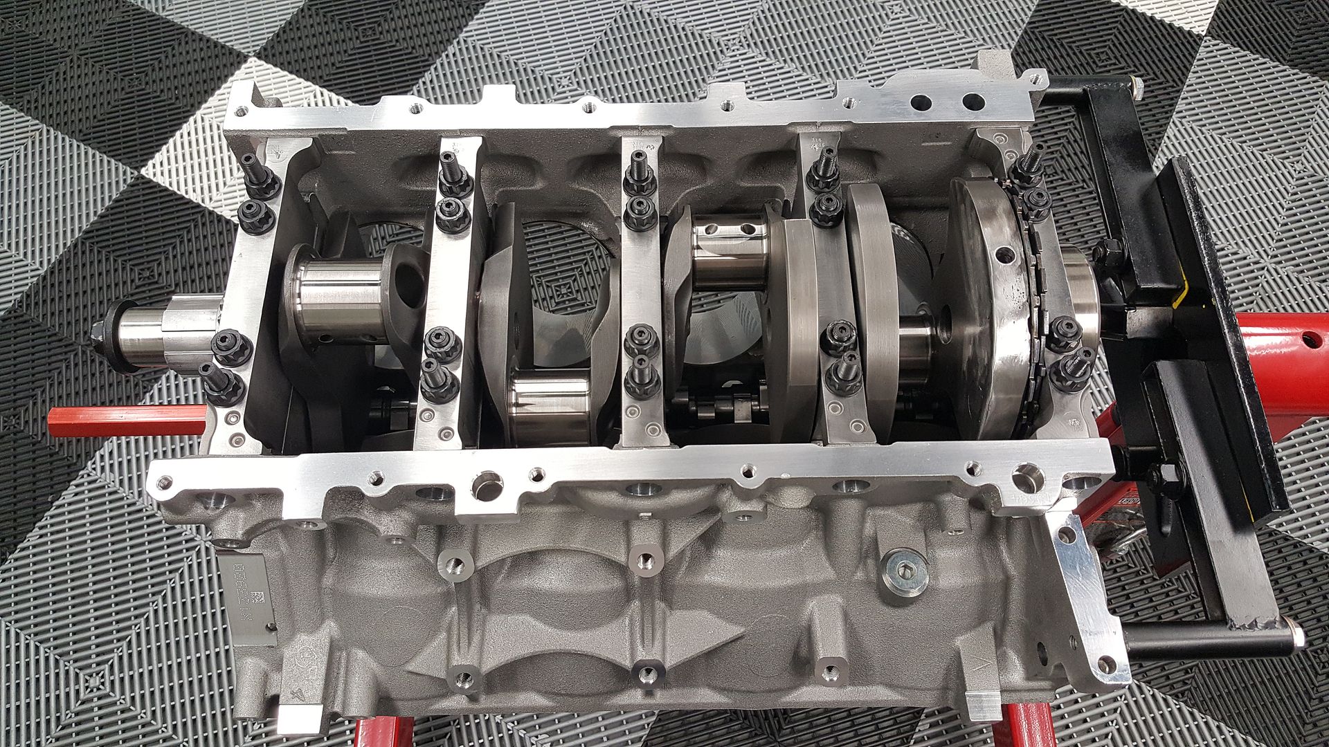

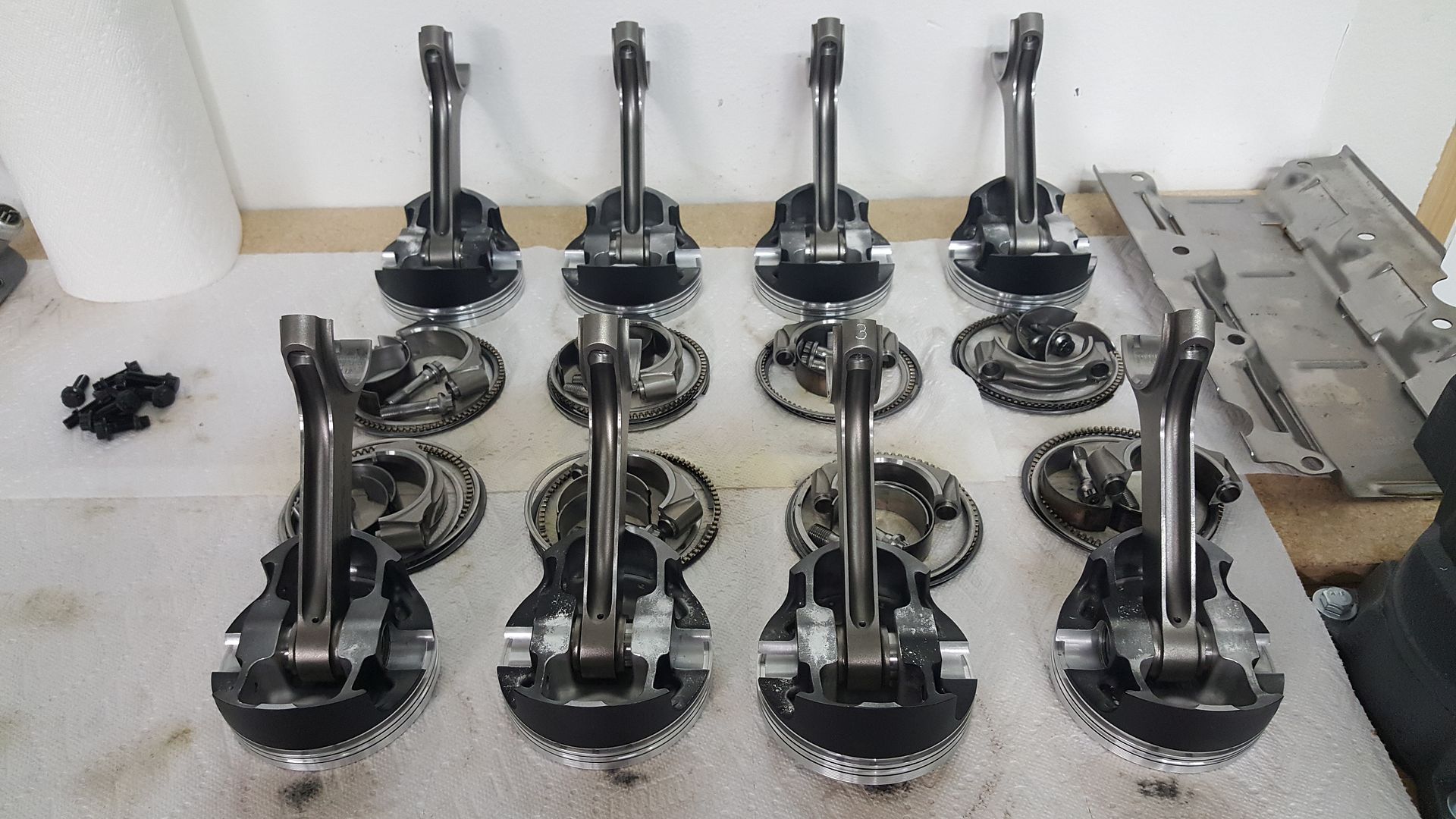

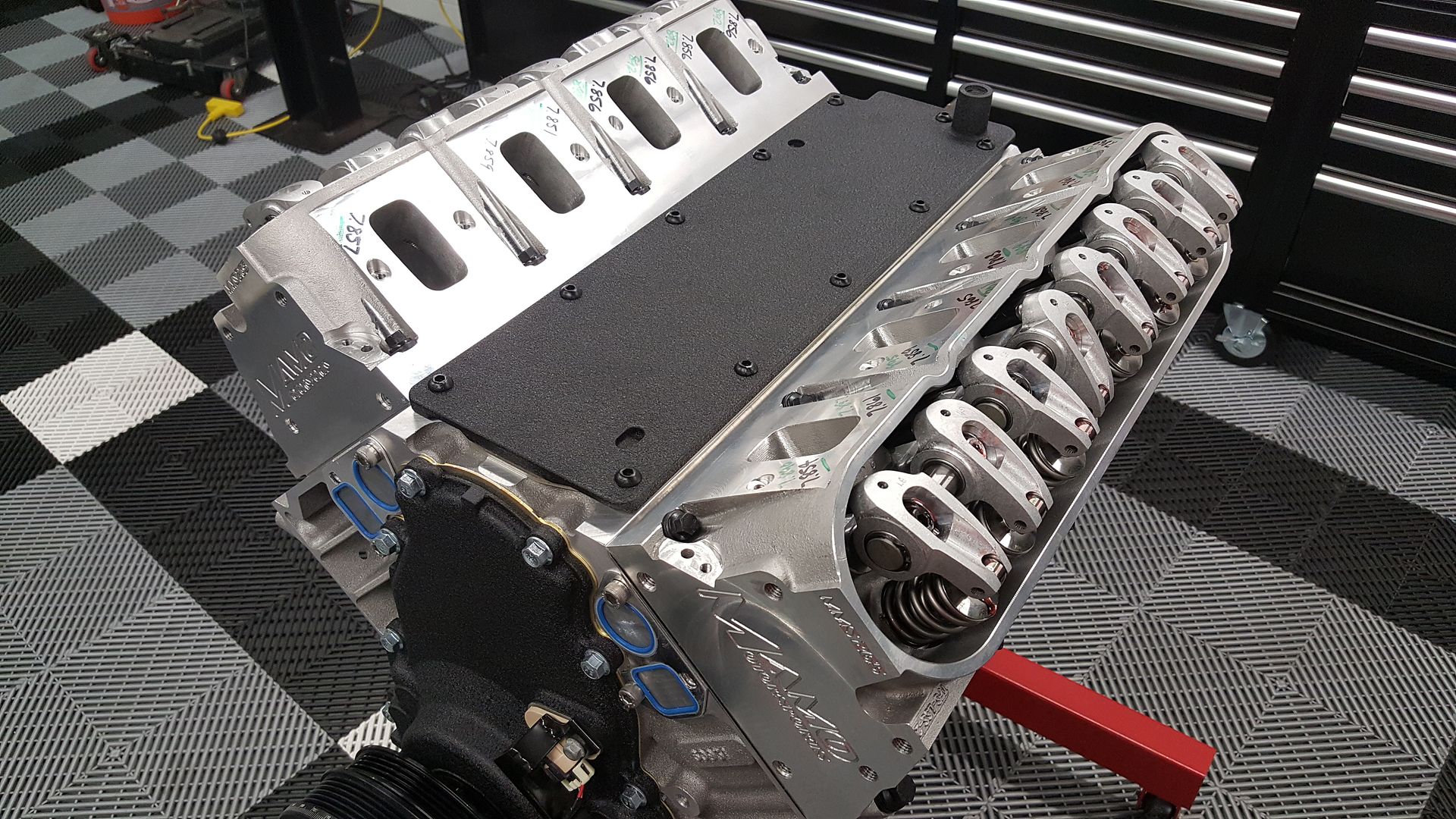

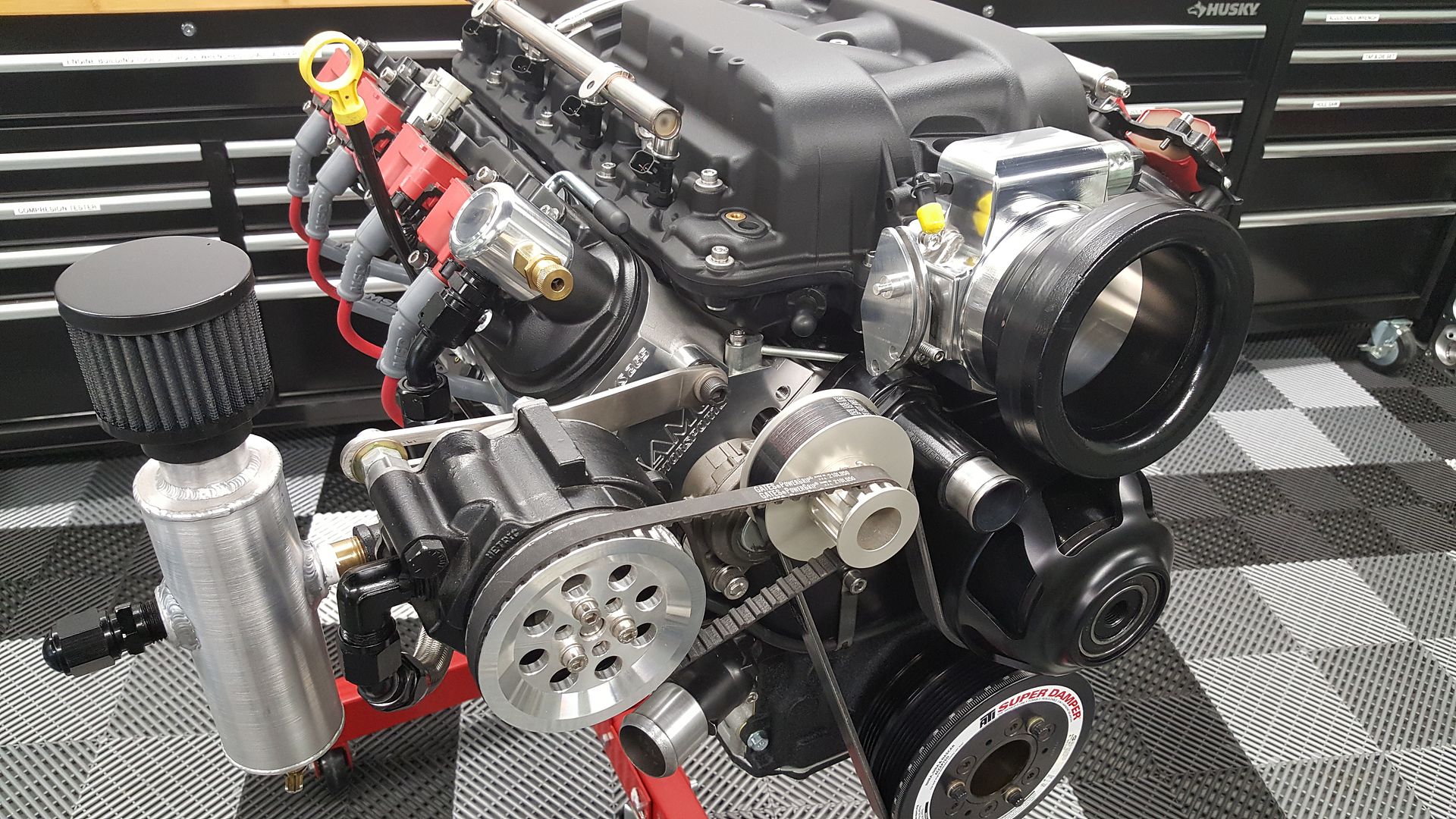

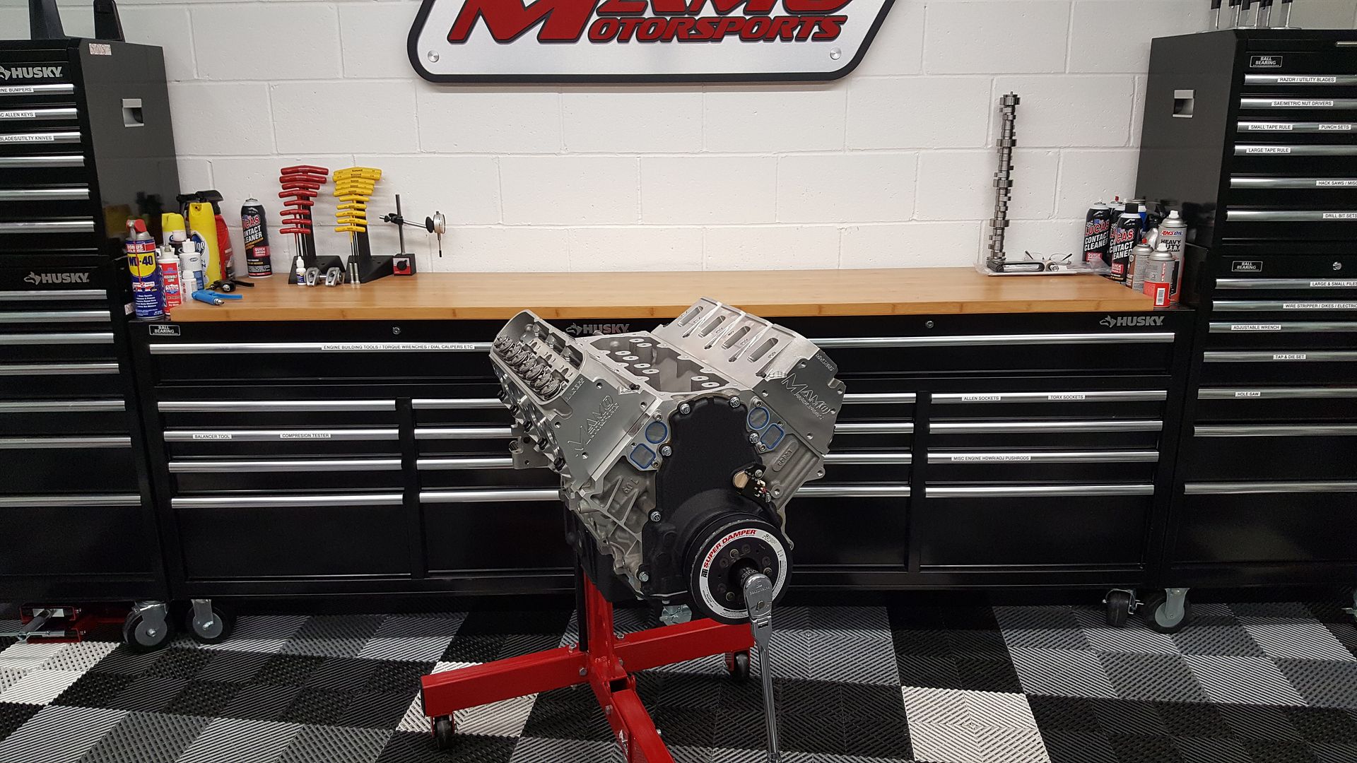

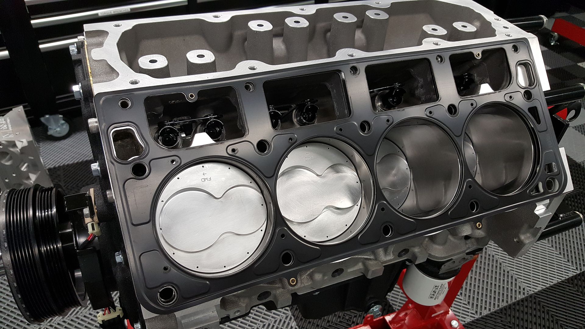

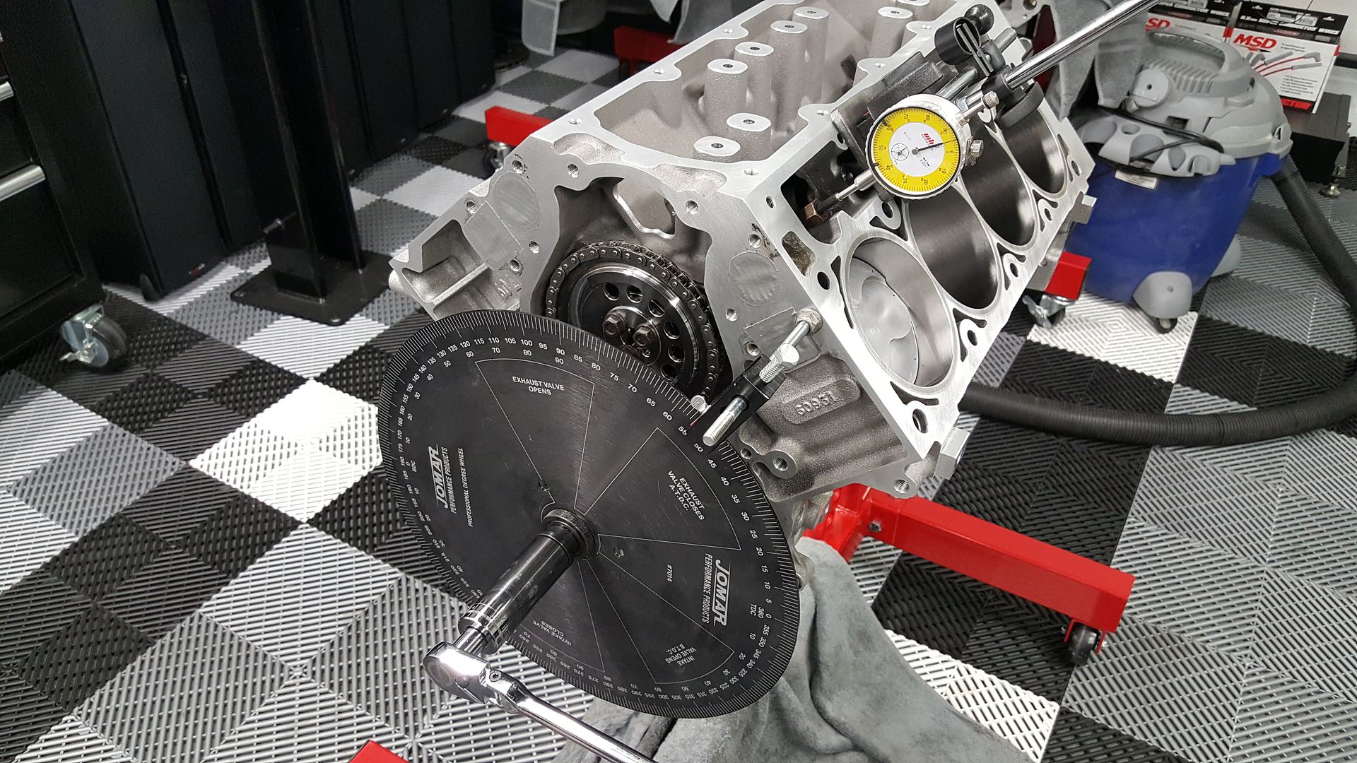

Here are some pics of the engine going together in my new shop (another improvement since back then!)
If you guys have any other pertinent questions feel free to ask....this thread can be more than a guessing game also btw....anything tech related to the topics being discussed here is fair game also. Man time flies....I cant believe it's been six years since I drafted that first Vader thread....it really is insane how fast the years fly by!!
