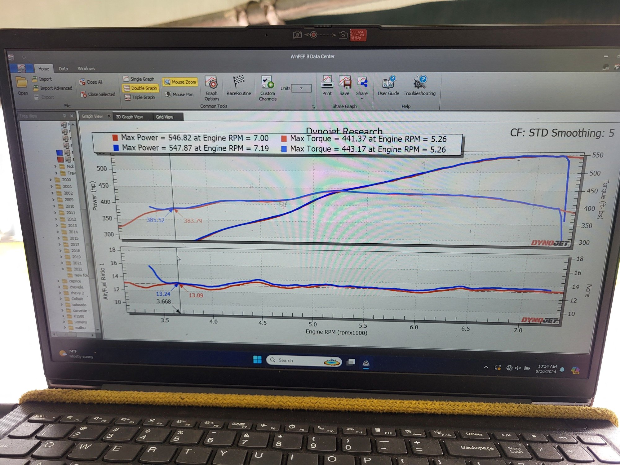

You should easily make more than my 5.7 does.....and it made 548whp on pump gas m6 with a 9". You have more compression, more cam and more displacement. I am running old early 2000 gmpp cnc 243 heads. I did tune them up a little by hand. But there are surely better port designs for 243s now I would think.

Forgot to update after the fuel pump upgrade . It ended up at 548whp 444wtq. It carried out to 7800rpm now with out running out of fuel. I wanted to try a few things that woulda likely helped power a little but the starter went out on the dyno and used up my time fixing it.

There really are no details. The bottom end is basic af. Stock crank, gen4 rods and a set of mahle off the shelf pistons with 4cc valve reliefs.
Heads are old ls6 gmpp cnc heads. Some psi beehive springs and I forget the brand of roller rockers I used.....nothing high end tho.
A used llsr cam from Darthv8r ghosthawk sbe build that he documented on here. It has around 12:1 compression on pump gas.
My bolt on ls6 made 451whp 423wtq.....which is very likely over 500 crank. Gm gave us a great foundation......no reason to over think it. And most importantly don't go backwards. Just build off what they gave ya.
