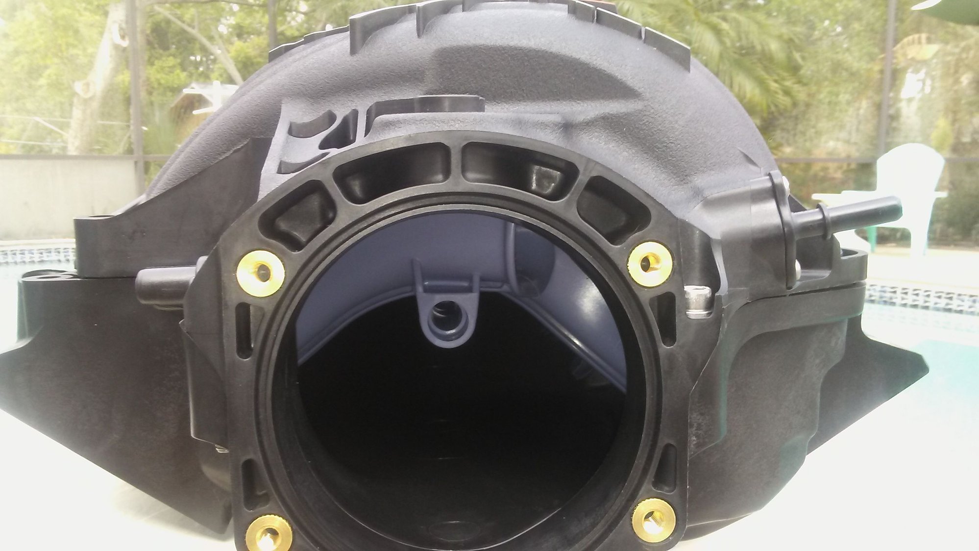

Yep all the four bolt Tb's will fit on a 102 intake but you have a cable. I didn't think GM made a 90 with cable. There's lots of aftermarket cable 90 92 and 102's out there though. Might be one in the for sale section or will be soon I'm sure. I found a 92 for my ls3 intake here. $275, hardly used and with the big Fast box. NW's are the best though. That was a while back when tb's were more expensive then now. A realy good deal would be a used
fast 92 intake and tb. They show up as well and there just about as good for cheep like $600 or so for the intake.

I'm running a gm ls3 intake. its a very good intake but 92mm max Tb. I did just get a new 102 though. I'll use the 92tb on it for now.
