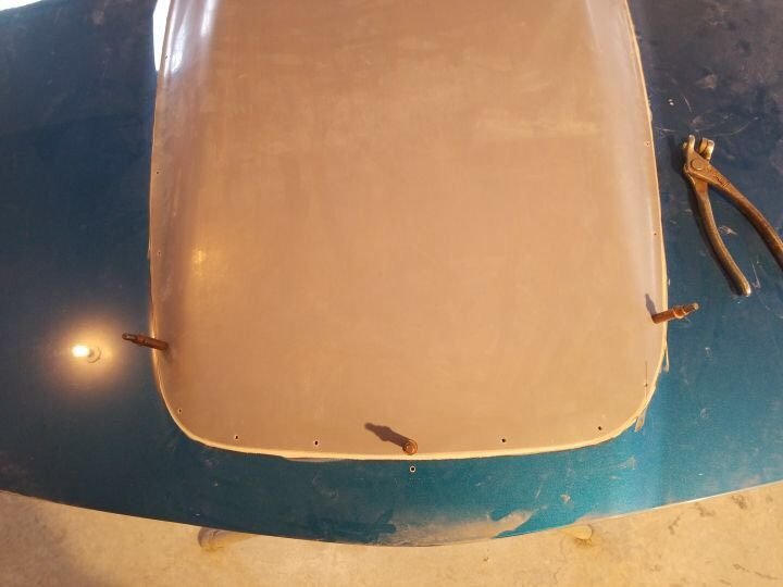

Worked all weekend with HioSSilver getting the hood and intake installed. Had to make some custom parts of course.
