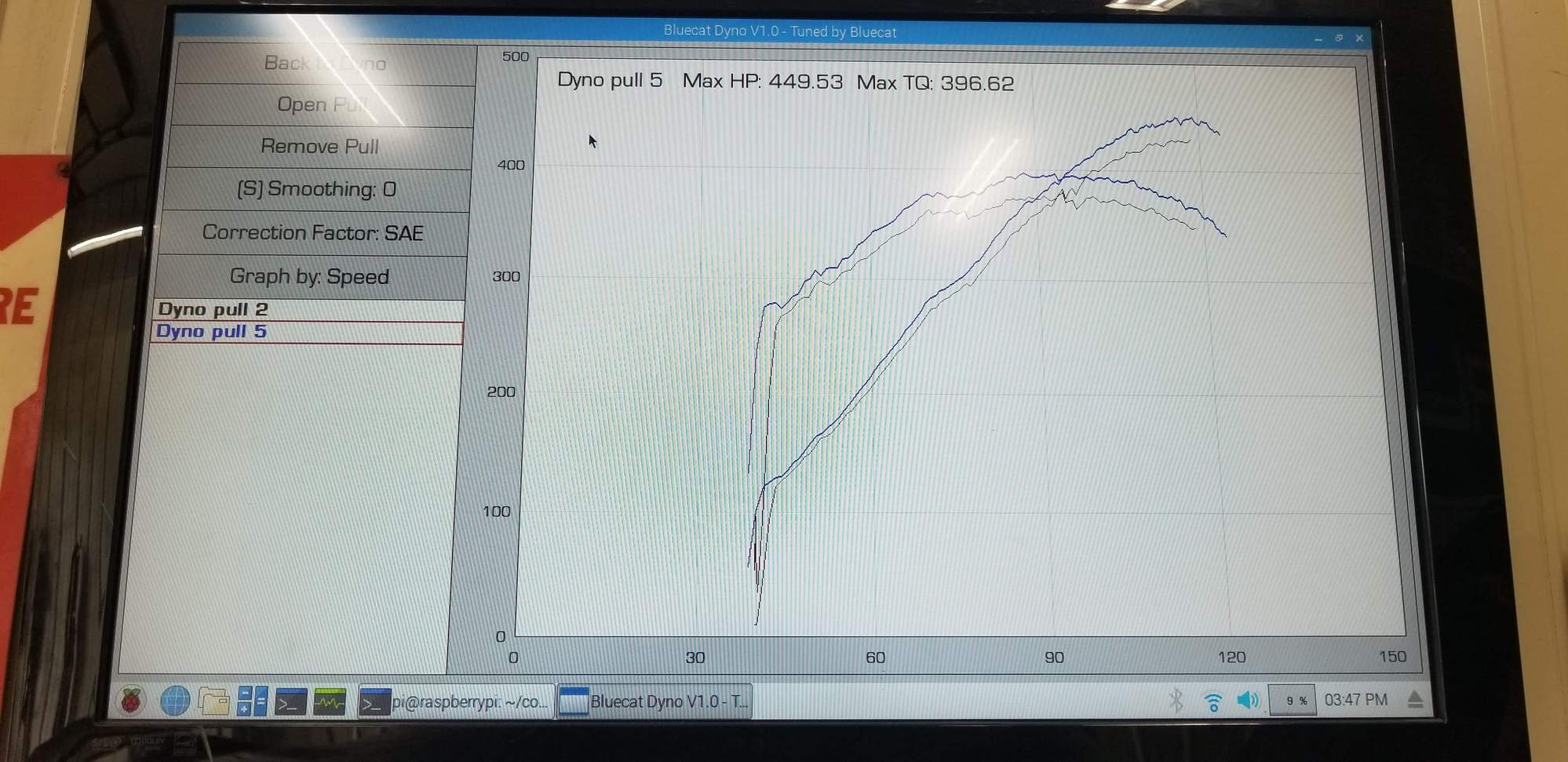

Hey guys, just wanted to share my results to add to the never ending questions of how well does this combo work vs another lol. Setup is 102 fast intake and TB, stock 243's, BTR stg 4 N/A cam, 25% UDP and custom exhaust pulling through an M6 with a moser 9in. Im hoping a good port job on those heads might put me in the 470HP range but I guess we will see. April 26th I've put in for a day off so I can go to the track and see what kind of time she will manage to pull off. Best previous time was a 12.007 @114mph, that was at 330HP and 3850 weight, so I'm hoping at 450HP and 3350 weight and much better tires this time that I can manage to squeeze out a 10.9 E.T this time.
