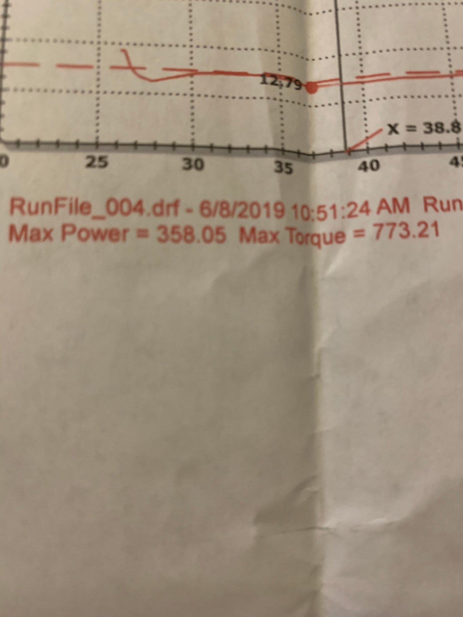

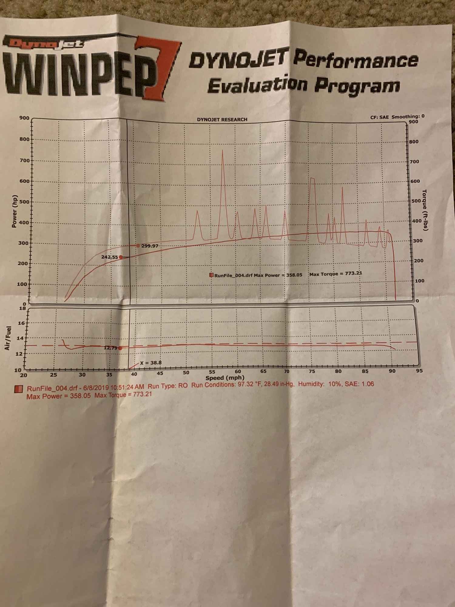

Anyone ever heard of 773 foot pounds of torque and 356 hp running a 6.0
Just doesn’t make any sense to me got back from the tuner seems a little off

That doesn't sound right at all. Is that peak numbers?
Yes sir it is

Post the curve, I bet it looks like a diesel dyno
I posted the dyno sheet. Let me know what you guys think
i appriate the help
waiting on on the site to approve pics

That graph is junk, I hope you didn't have to pay for that.

After seeing the graph, how was this ever even a question.

If the dyno operator did not know that was garbage...

That is a joke of a graph.

That is a peaky engine

LOL feisty little fella. Dyno is junk data...... It likely would make around 320-340 foot pounds. Strap it back down elsewhere.

Definitely redyno that graph has issues.
