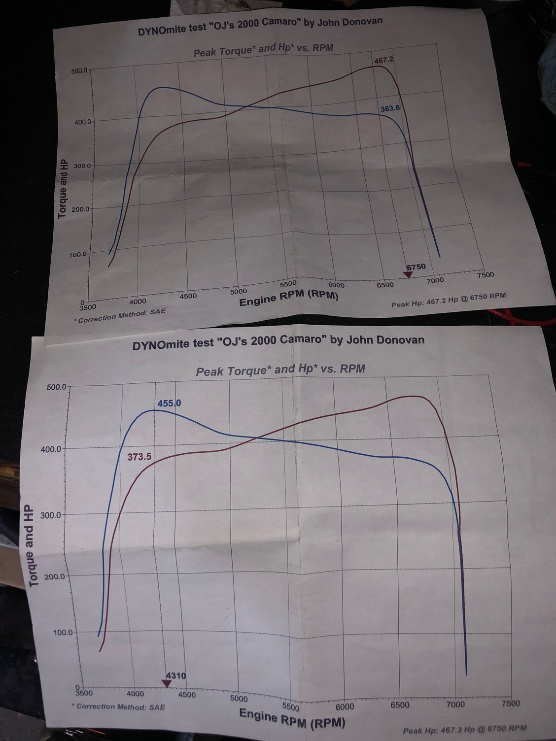

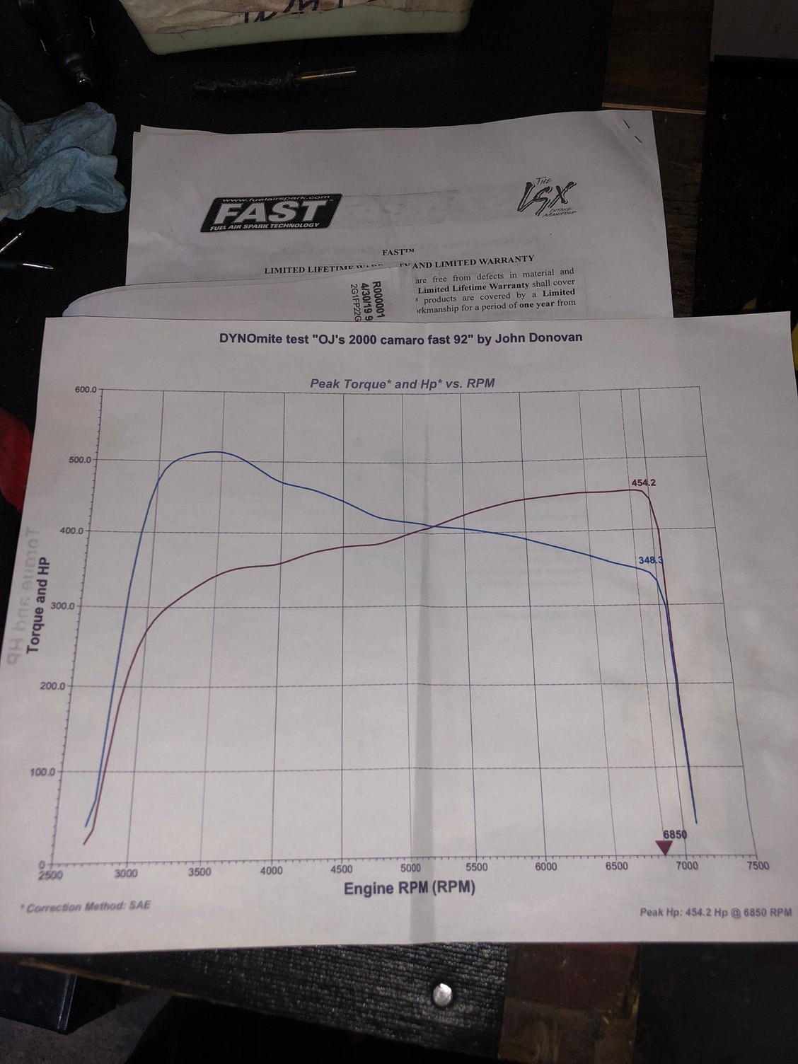

Alright so first photo was the two sheets he gave me from the first dyno run, the top sheet was hp bottom was the tq, second photo you can see where the tq was over 500 at a little over 3000 so I misspoke earlier. He showed me on the computer that it peaked at 513 for tq.

Nice power graphs. Now knowing it's an auto the numbers make sense.

So shouldn’t be to worried that it lost some top end? And tq increase seems ok..?

Yea, I wouldn't be too worried man. Just the dyno numbers. Bet the engine is more happy with the better intake setup & actually makes more power. The tq increase is just from the converter being unlocked & at lower rpm. Normal.
Good upgrade man. You made a good choice on intake setup. In my opinion.
