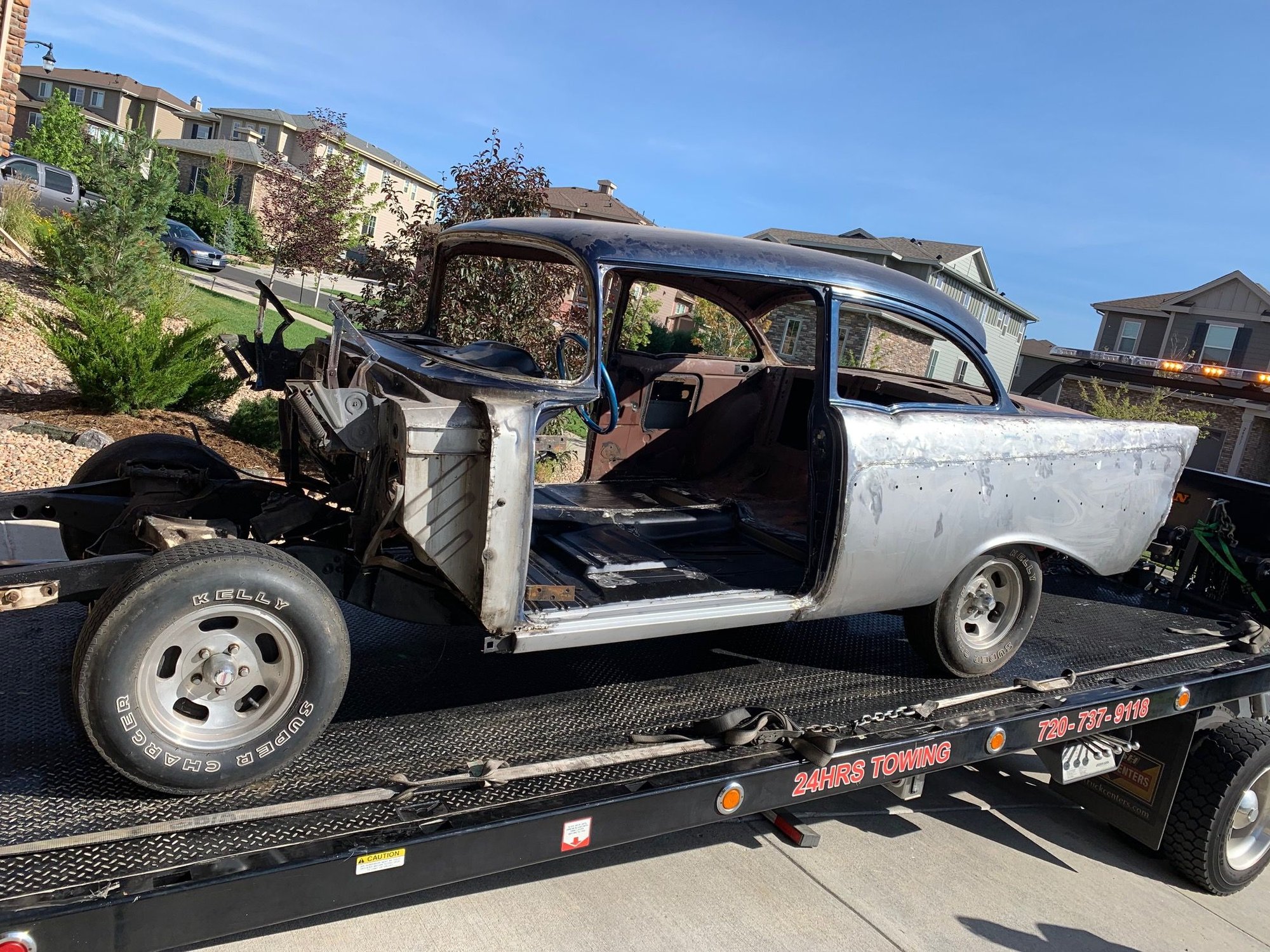

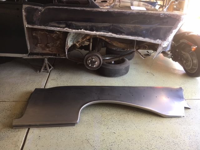

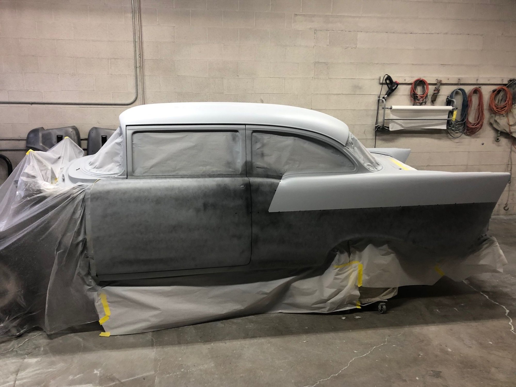

This is well along in the metal work journey
off to the blaster
guide coat on the paint break just to get me motivated
about done blocking
This is gonna sound stupid, but I really hadn't considered that approach until your remarks got me thinking that way. I have been so stuck on the "do it once, do it right" mantra that I never really considered that approach makes a lot more sense for metal work and paint and body than it does for the motor.
This is the "dry" project I bought a few years ago. It actually had fairly decent looking paint. The good news is that while it needs everything mechanical, I have all of the trim and expensive, hard to find parts for it.
Again, thanks for helping me with the thought process.
