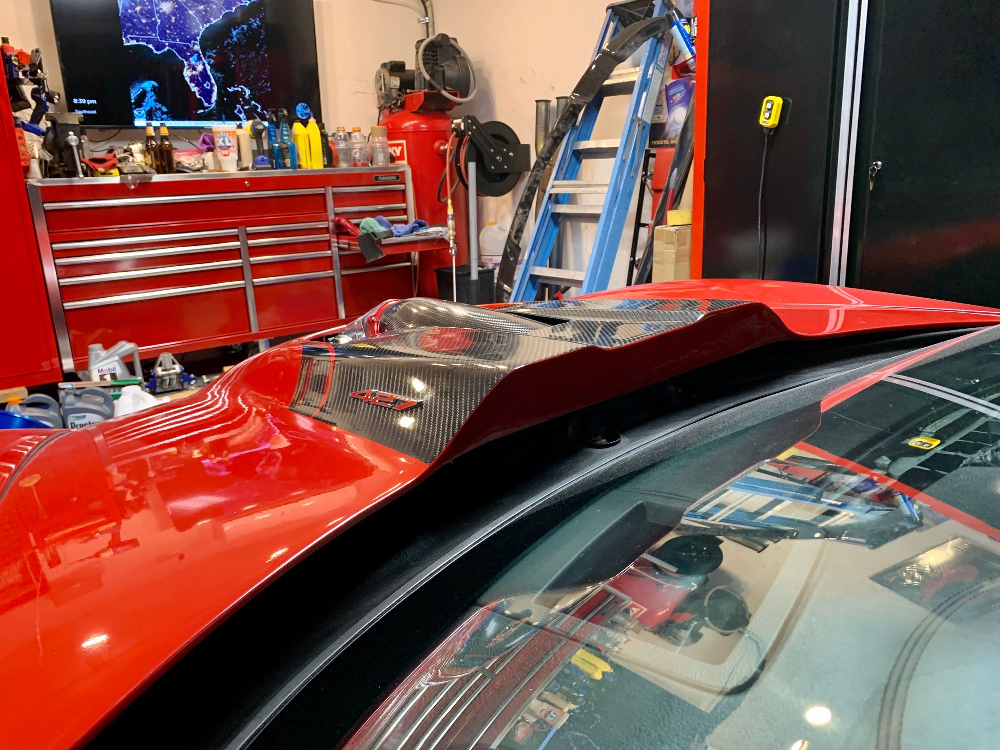

Getting ready to finally put the C6 Z06 on the chassis dyno (Dynojet) in February.
My car has a new 3.90 rear gear ratio (factory is 3.42), so it's going to skew the chassis dyno numbers down a bit.
With that said, let's see what people guess the final chassis dyno number is going to be
Engine is a LS7 based 468 ci engine, built by Horsepower Research.
The engine is going to be run with a version of the FAST LSXHR plastic tunnel ram, Performance Design's pTR carbon plastic tunnel ram, and a NW112 throttle body.

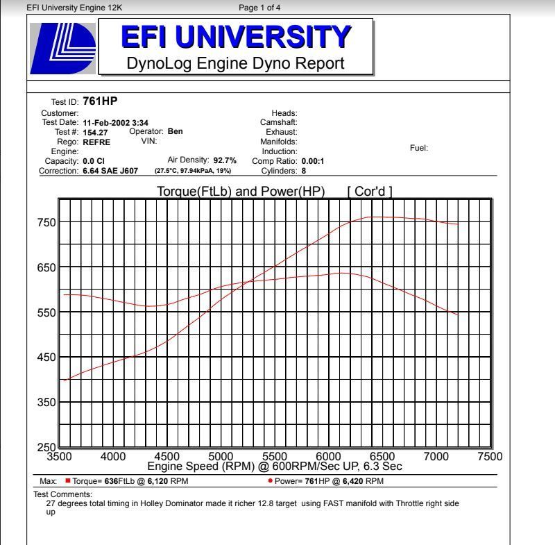

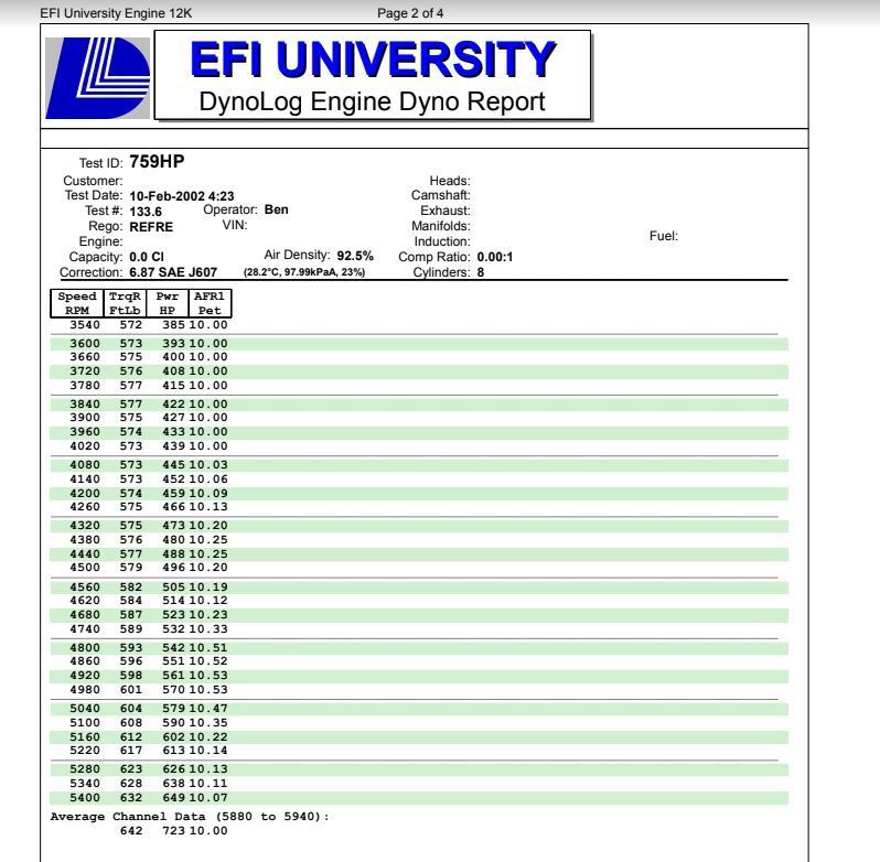

My engine dyno test was done with a pre-production FAST LSXHR, with a FAST 102 throttle body and Ignite 114 fuel ......... 761/635 was the initial numbers (4th pull).
It looks like the engine picked up an additional 5 HP and 6 ft/lbs on the last runs (24 pulls in total) when I was testing other intakes, but I don't have an official number with the FAST other than the 4th pull listed above as we didn't have time to re-run the FAST.

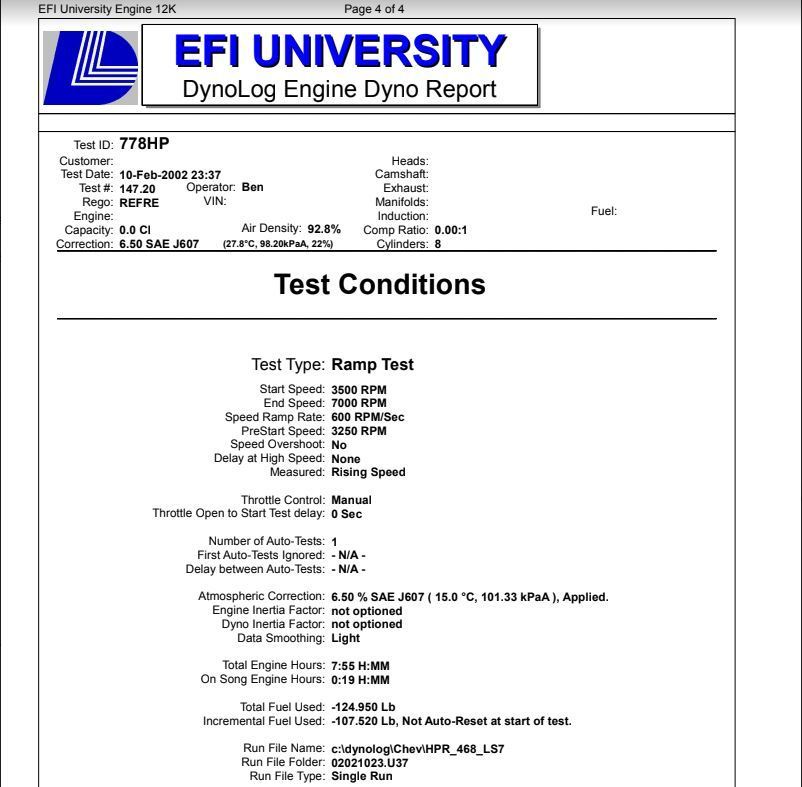

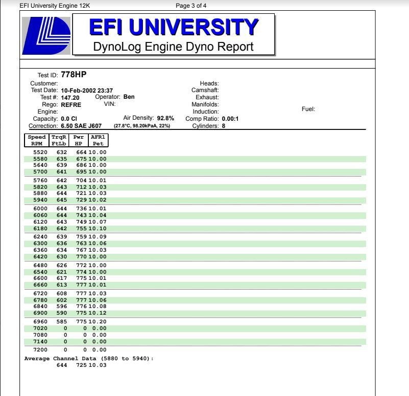

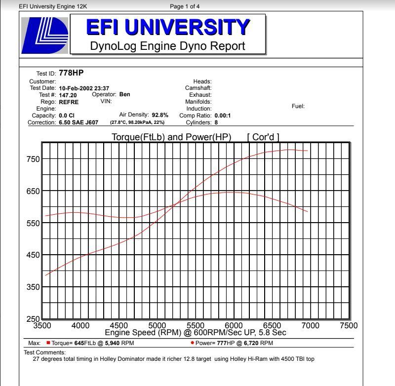

I also ran a billet top load Holley Hi-Ram with an Accufab 6500 throttle body, which made 780/645 , but I'm not using that particular intake
Car will be run on both E54 (best we have in AZ) and MS109 on the chassis dyno, instead of the Ignite 114 fuel used in the engine dyno test.
Take a guess at what the chassis dyno numbers will be........

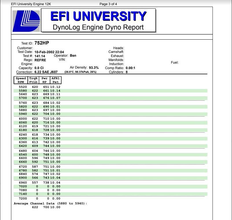

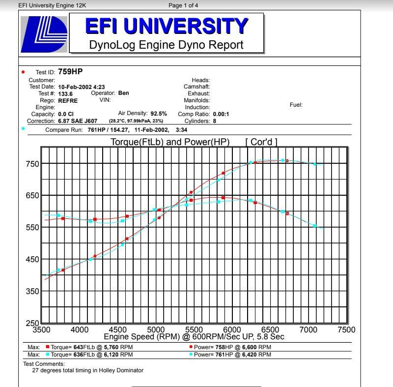

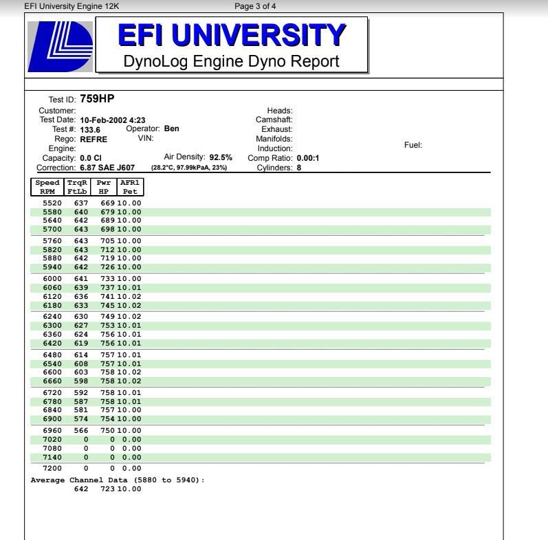

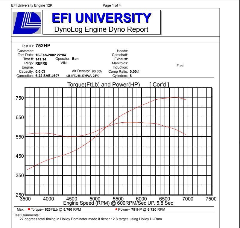

Here's the comparative runs with the Holly Hi-Ram and factory lid, with the base being port matched to my heads....

Wow thats the info I needed! was that with same tb on both intakes? Looks like the fast bests the holley by 9 hp?
Yes, same throttle body, injectors, and fuel.......just replaced the manifold.
For my setup, the Holley Hi-Ram was very sensitive to the type of lid and throttle body size that was attached to it.
For instance, I ran a replacement carbon fiber lid on the Holley base and lost a few horsepower,
I then ran a custom billet lid and Accufab 6500 throttle body on the same exact base...no other changes, and picked up almost 20 crank horsepower......

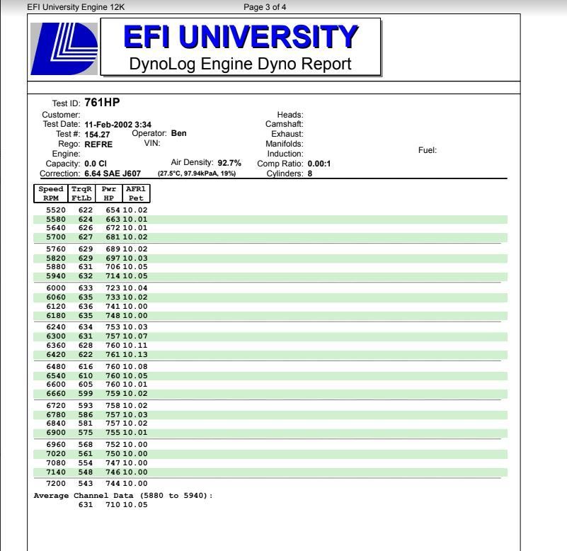

I ran all three trumpet sizes on the FAST....the dyno run I posted was with the long runners which ship with the intake by default.
AS odd as it sounds, the mid and short runner trumpets made no difference on the engine dyno....peak power came in at the same RPM. We think this was mainly due to the 102 throttle body not supplying enough air at the upper RPM's....we saw significant kPA drops as we approached 6500 or so. Once I complete my initial chassis dyno sessions with the long runners and NW112 throttle body, I'm going to re-run the mid and short runner test again, albeit on a chassis dyno, to see what happens.
We were surprised that it didn't affect the power band delivery, even with the throttle body limitations.

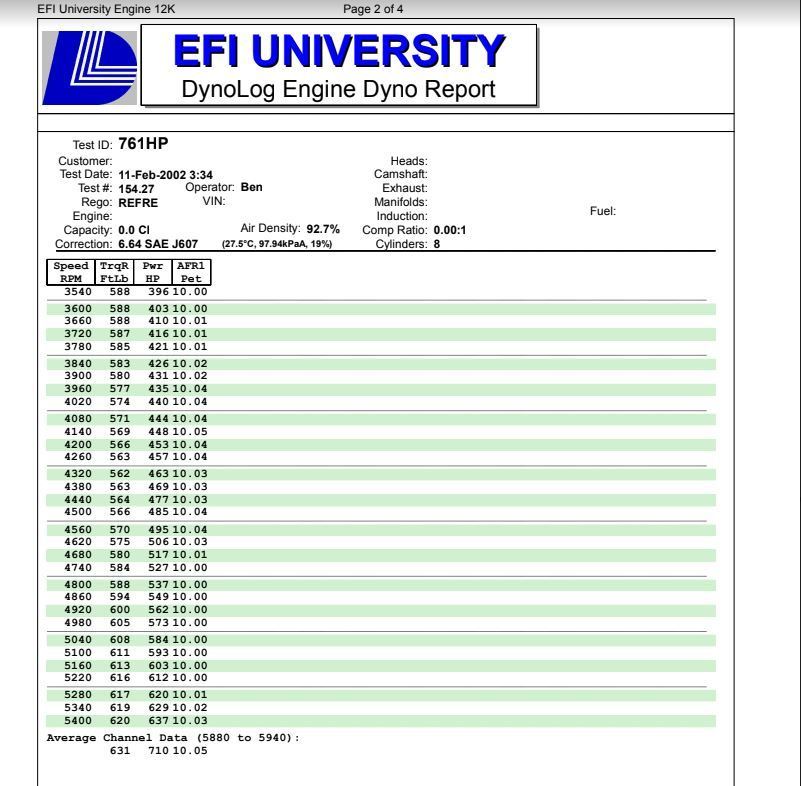

As an added bit of info, the ported MSD ran neck and neck with the pre-production FAST with long runners........
MSD dyno pull.....

It will be only the 112......I already saw what the 102 did, and you can see the potential difference by looking at the Accufab 6500 throttle body dyno test above.

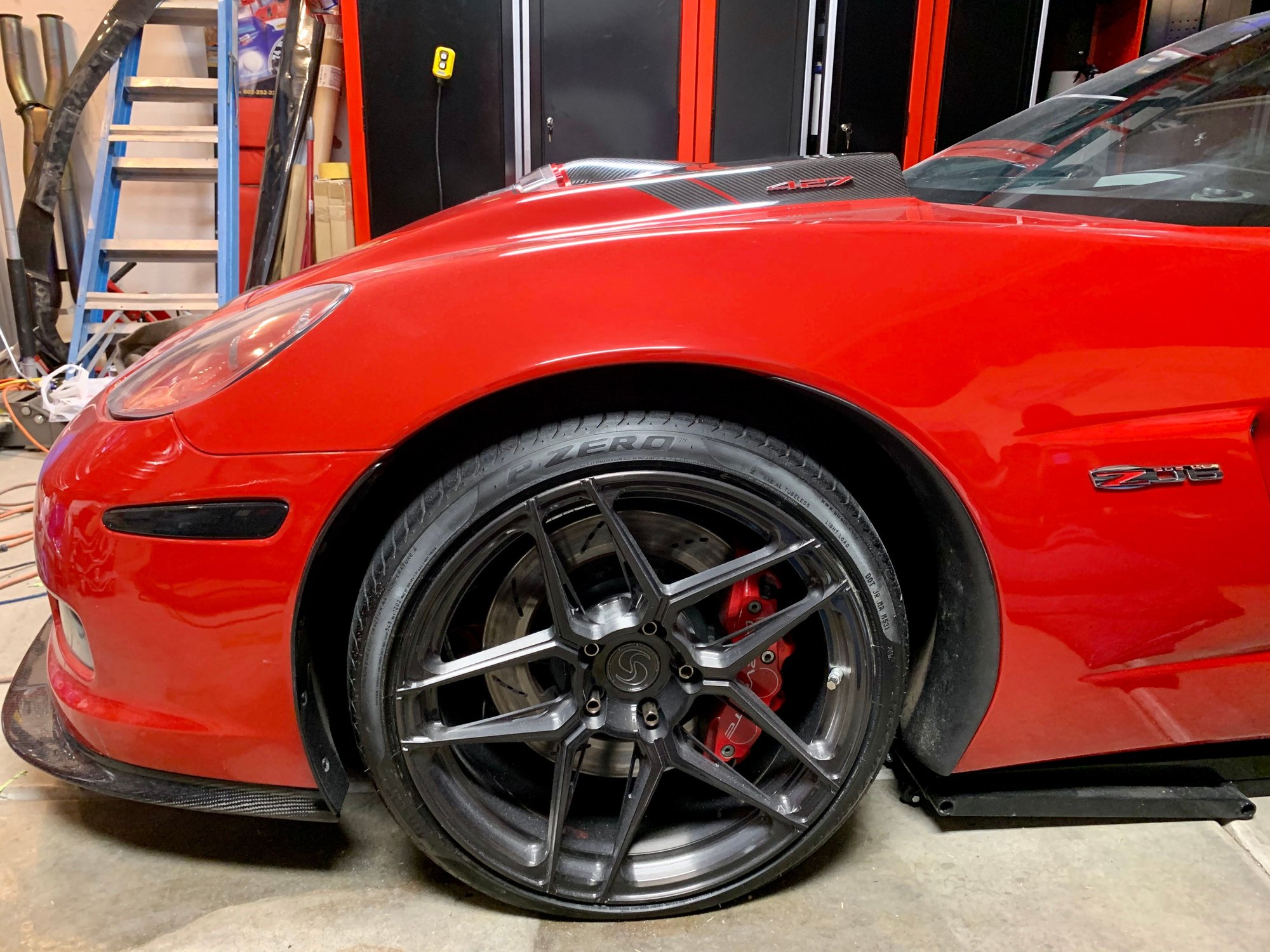

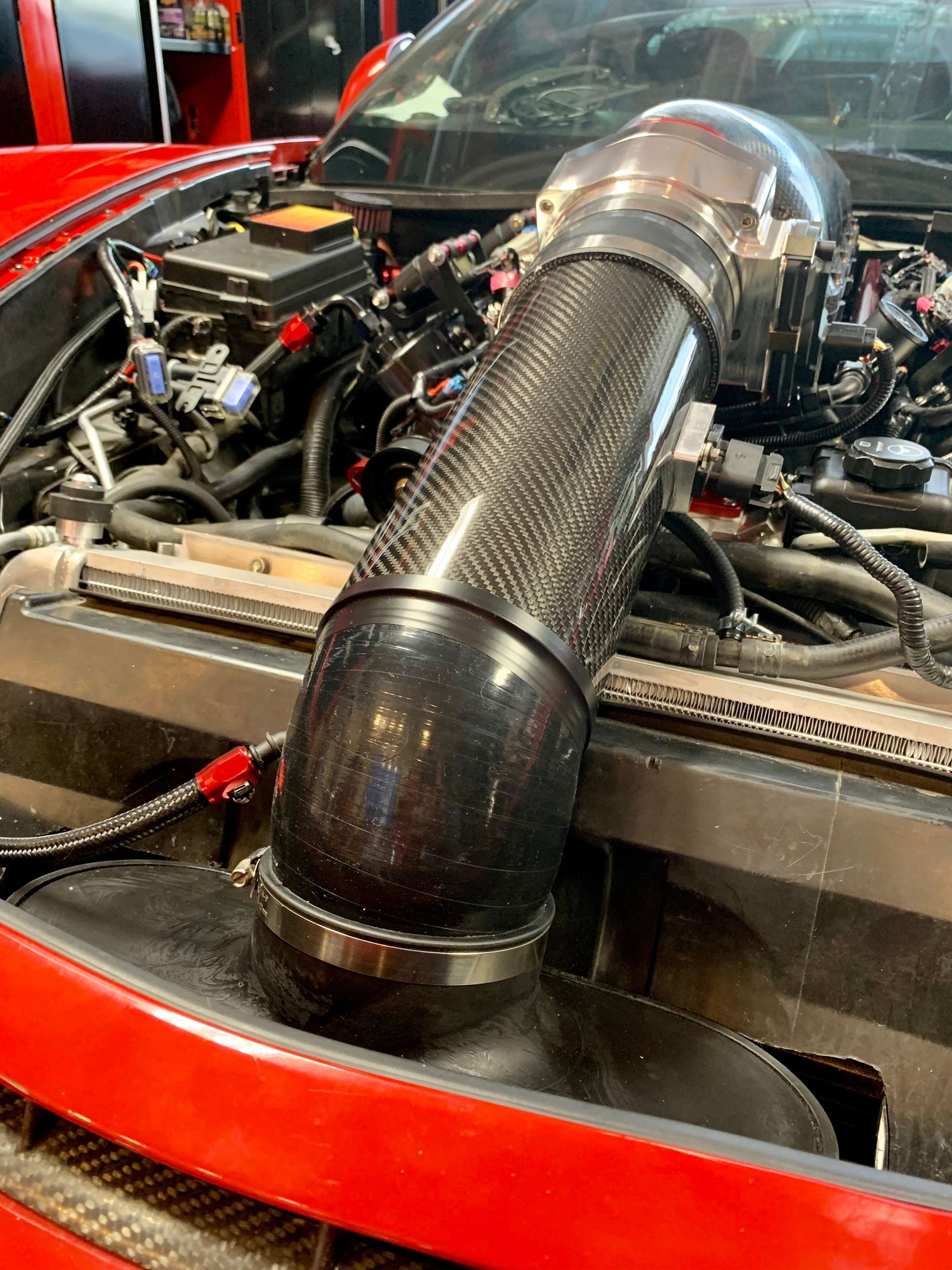

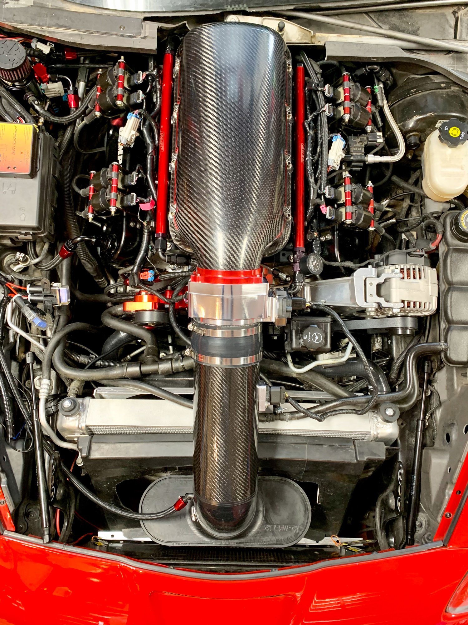

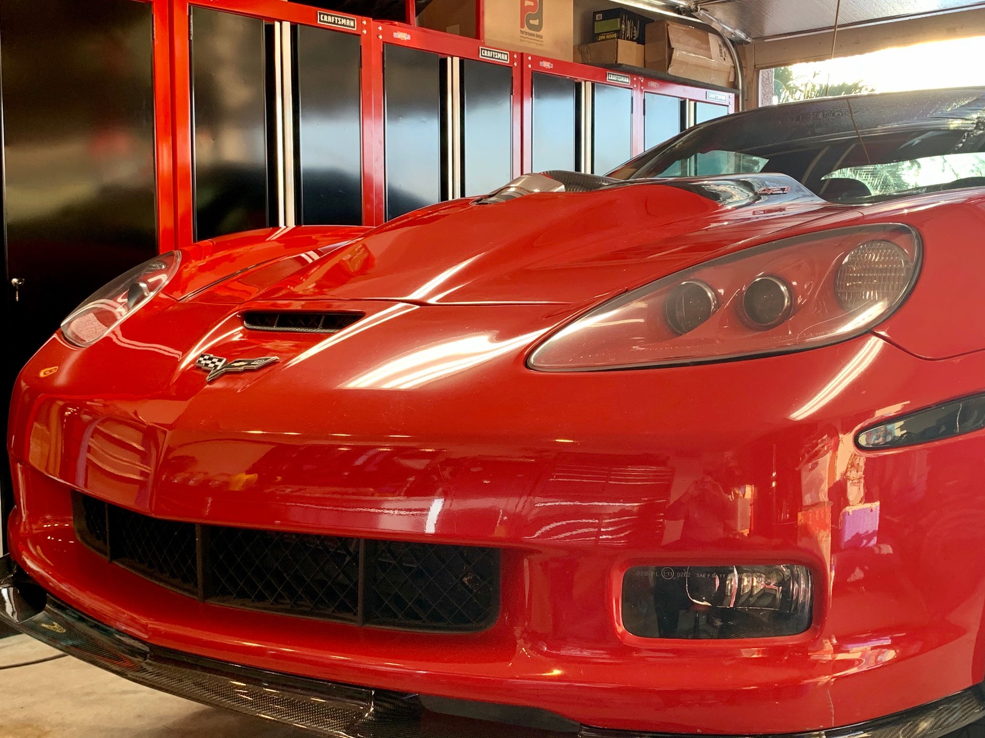

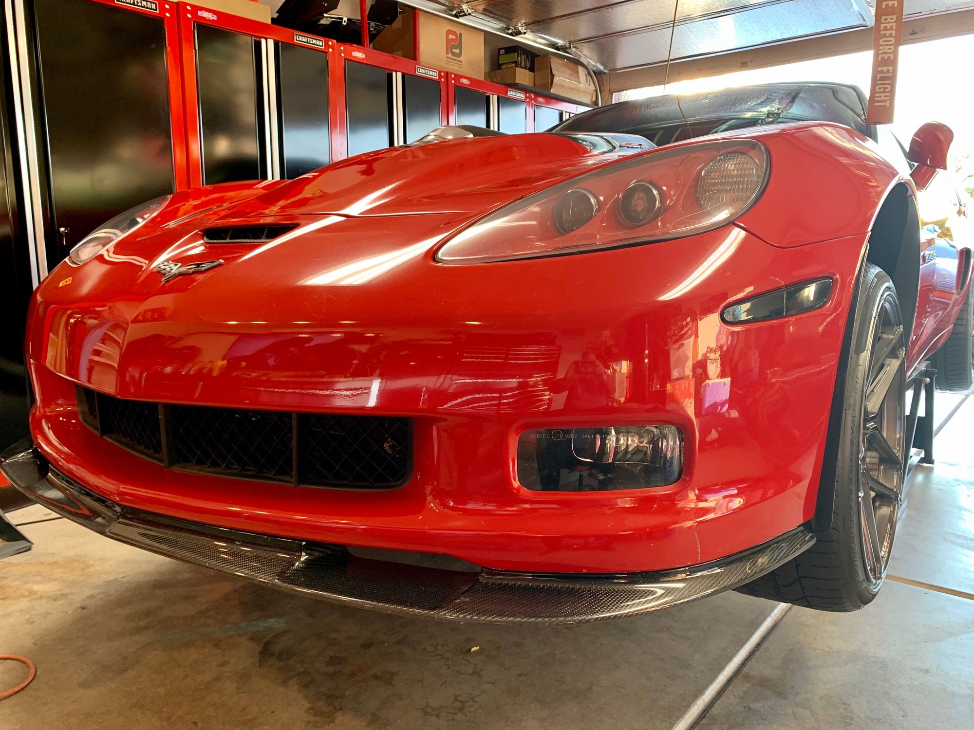

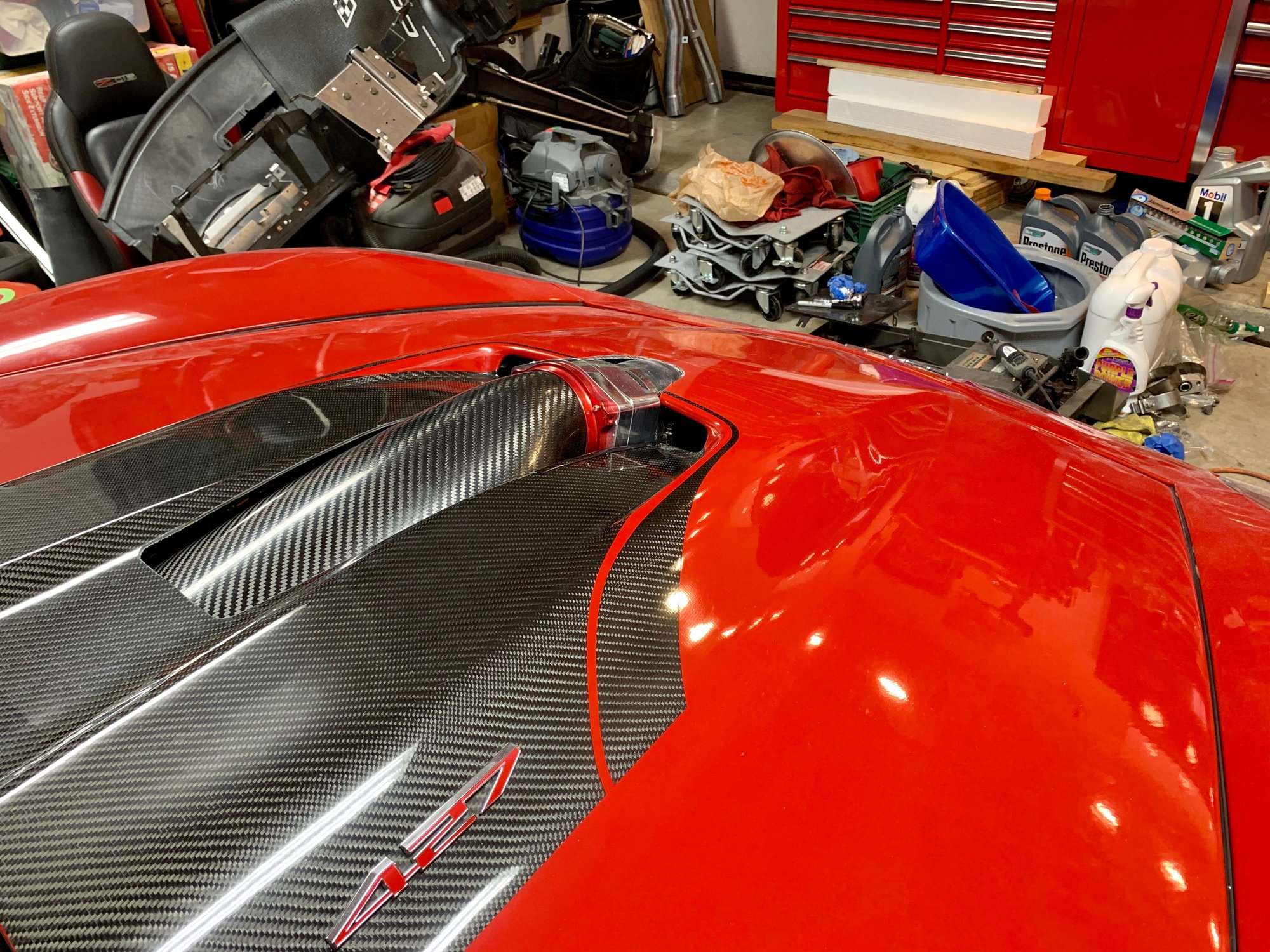

She's ready to go !!!!
Base tune at the end of the week........some miles to get the new ring gear and diff broken in, then back to the dyno
And......... possibly some exciting news on a new custom lid that natively supports a 112mm TB.
