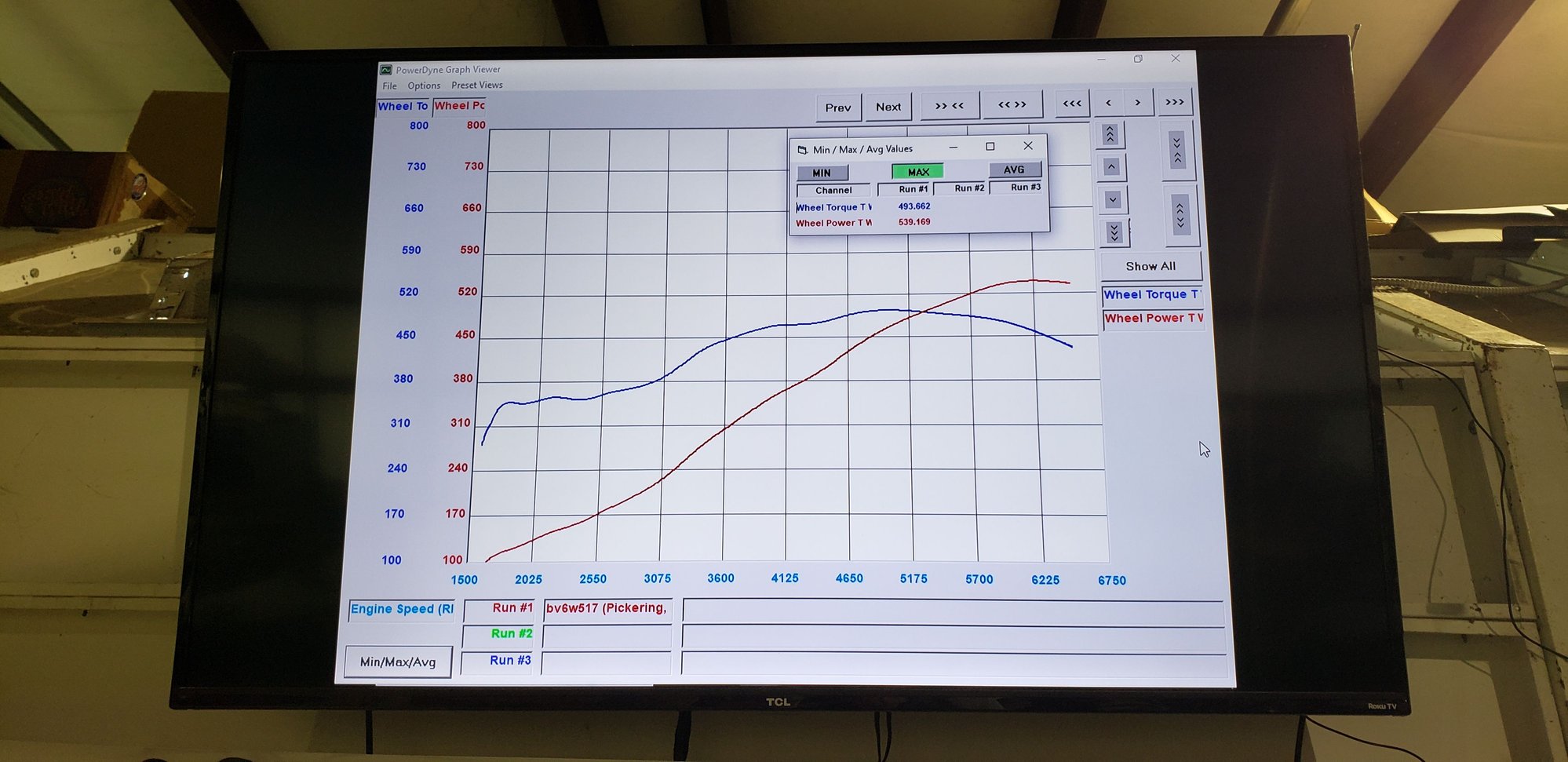

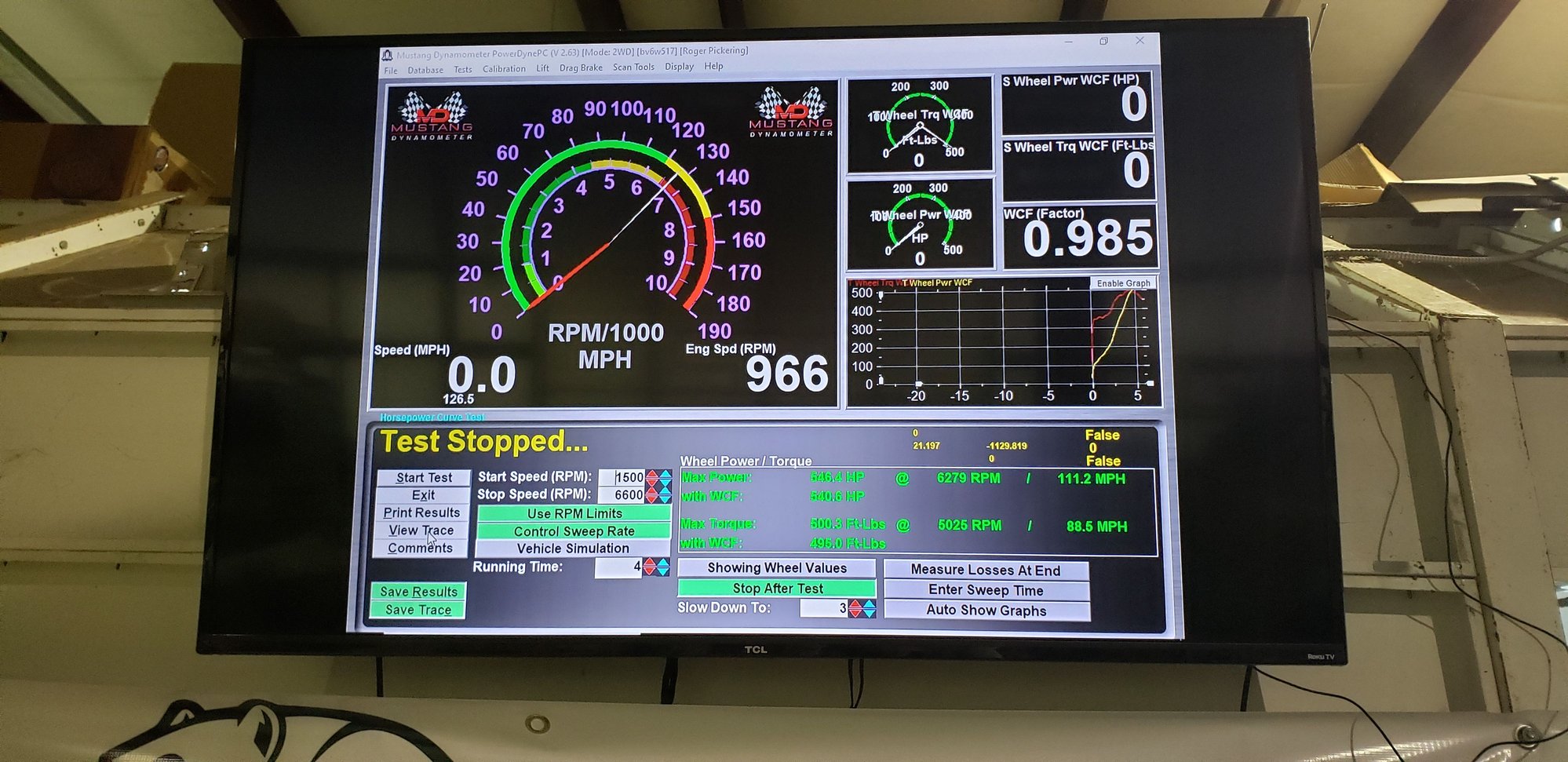

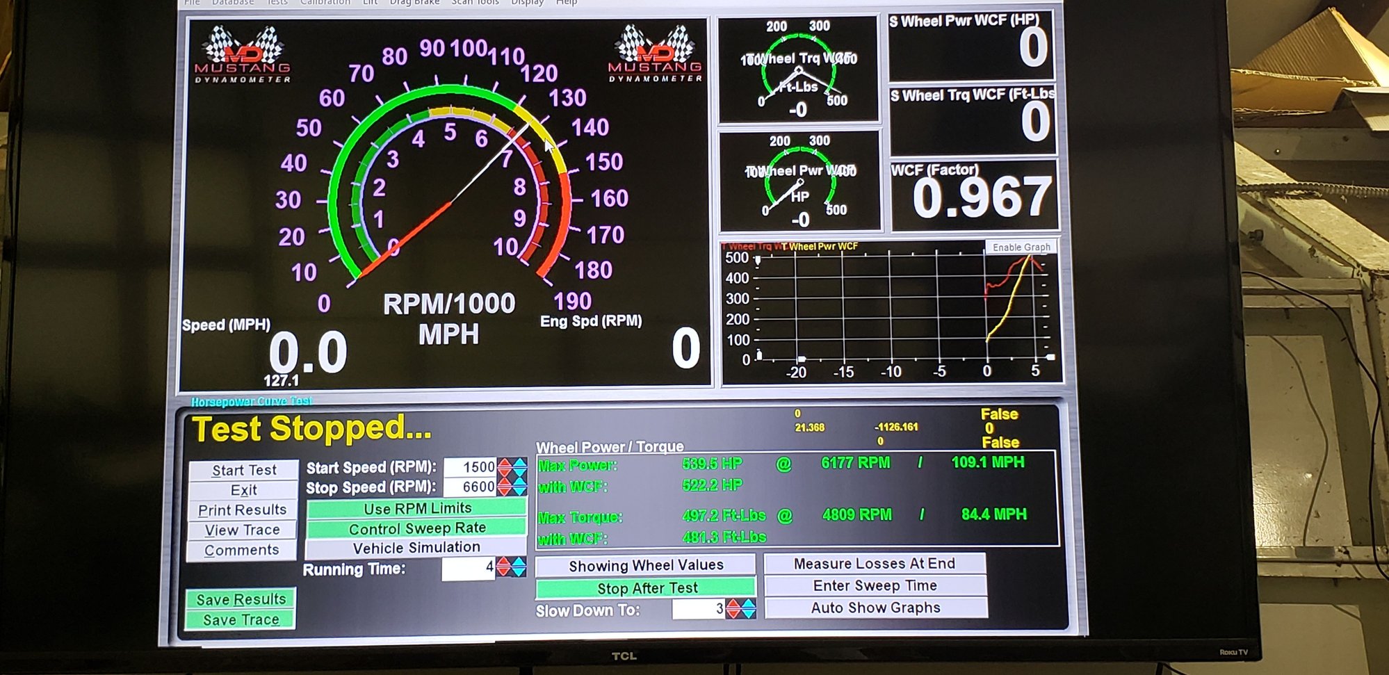

Default LSX 427 NA dyno pulls
In Pat G We Trust!
Engine: LSX 427 with LME Brodix BR7's, FAST 102, NW 102, 60lb inj.
Trans: RPM Level 6 T56 Magnum with Monster LT1-SC clutch
Rear: S60 HD posi with 4.10's
I was expecting 550 rwhp so overall I'm pleased with the results and I'm looking forward to seeing what it can do on the juice which will be my next upgrade for this car, which will be on the back burner until I'm finished with the 99 Camaro/E85 build.

540 rwhp on Pats dyno is legit numbers! I bet that thing hauls ***, that dyno is a heart breaker but his tuning is amazing, world class. I bet that car is a blast!!

A lighter clutch won't make any difference to power on a loaded dyno like you were on. Rotating mass is taken out of the equation with loaded dynos.
Does that mean I would make the same horsepower and torque if I had left my 10 bolt in?

Good cam choice for what you have. On the rear a dyno operator can chime in but I think the S60 might not be as effecient as the old 10 bolt but then of course does not matter if you break the 10 bolt with your power you need to beef up certain areas. On a Ford 9 inch versus a 12 bolt they say its a 20 hp difference due to where the pinion gear is located in relation to the ring gear on say a 600 hp car.
