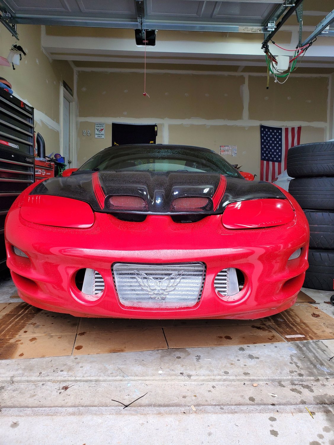

been a long time coming 😁

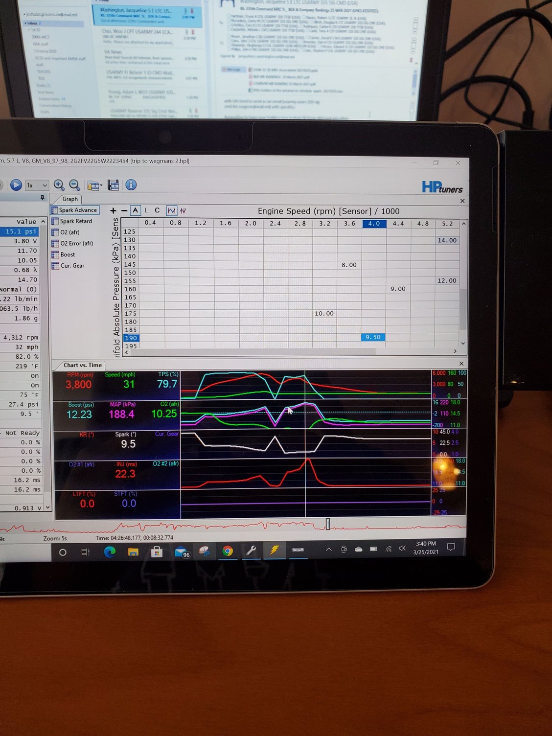

current datalog tune under boost. timing is now my main focus.

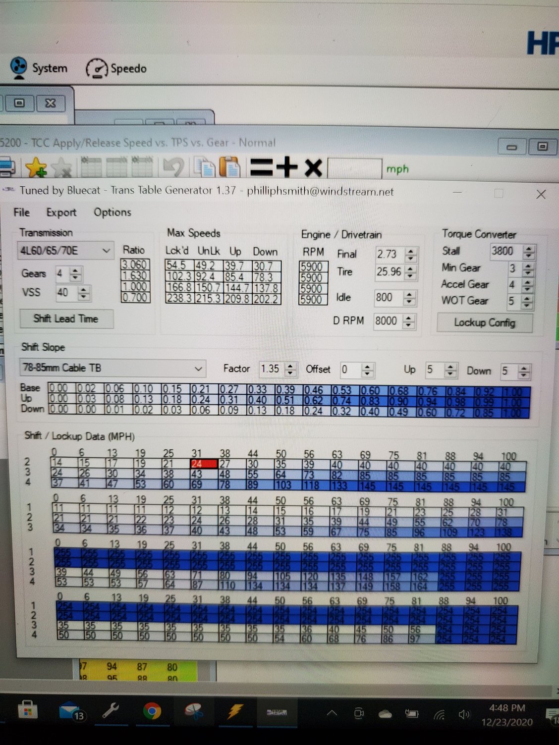

some bluecat data used to get the trans to shift a little better still need a litle more work though.

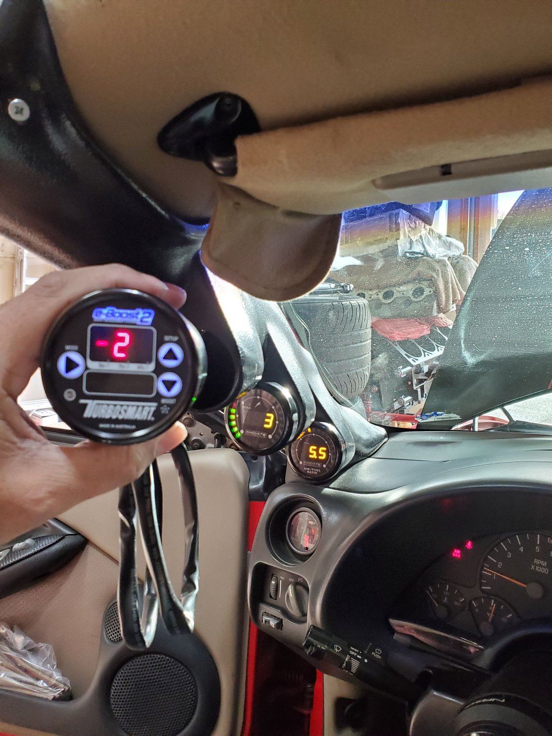

eBOOST2 working lol set at 12psi and 14psi

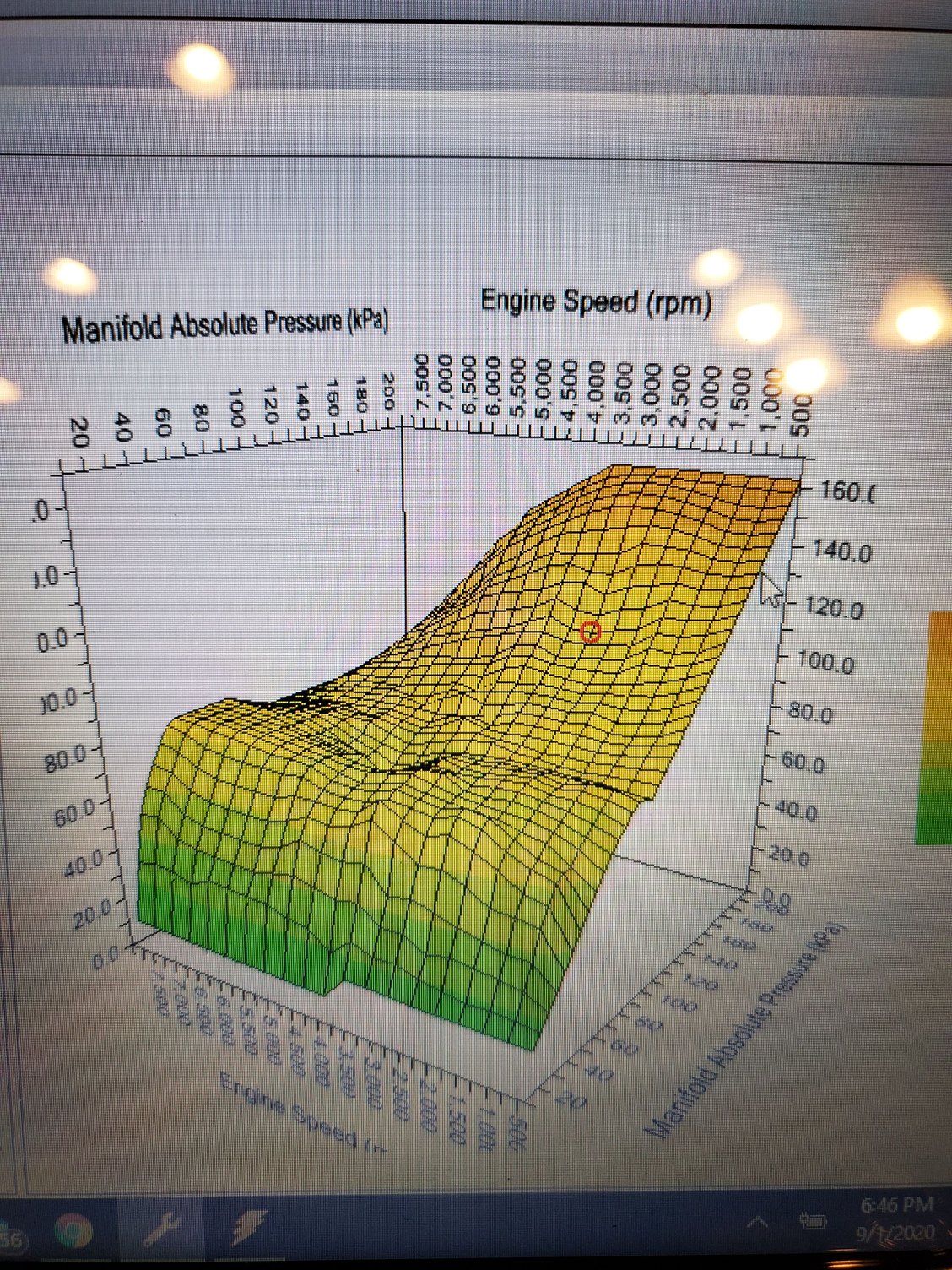

heres what the fuel map looked like when i first started back in AUG when i started learning hiw to tune... mind you this was something i paid for at a shop back in 2013... needless to say i had done a lot of work to do on my own lol
and now heres the VE map ive been playing with. VE table has come a long way, had some pig rich areas in the map that were rediculous at one point from the previous tune shop that was playing it way too safe. I had to pull over 10% of fuel in areas above 3000rpm and in boost. at times i was seen 9.0afr out of boost, not even in PE lol was rediculous.
