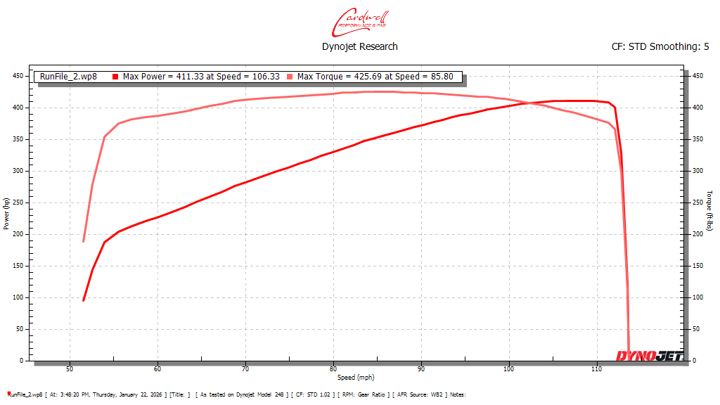

Here's the retune graph...

Thats a very small cam, looks about right, the retune might have knocked a few degrees of timing out above 5000 killing a few HP from your top end?
Timing is at 27 and afr 12.8. i never had a printout in in speed vs RPM's. Not sure if that has something to do with how the dyno reads/calibrated, but from going lean making 422whp 405wtq to updating fuel system and switched to colder ngk tr6 plugs being only changes, I just feel like something isn't right. Even on SDPC dyno data for my cam is over 20hp more than tq. And from the lean dyno session, i was right about at that point. Making more tq just seems like something is off. Even a good tq curve cam like asa or the Ws6store asa high lift cam still make more hp than tq. And I'm most likely am still going to go back to my FAST 78 as the low-mid loss from the 90 lacks too much. It definitely rev'd quicker with the fast 78 set up. Even tho SDPC used a 5.3 with lm7 and tbss intake and made 20hp more with tbss intake. That's the only reason i bothered swapping to my fast 90 besides tired of seeing it sitting and collecting dust.
I did just remember something from the retune session, my rack n pinion has been leaking and it did blow a seal on the dyno. The ps pump resvr was bone dry during last 2 fine tuning runs. Not sure sure if that would chew up 10-15whp... I'd think maybe a few whp...?
