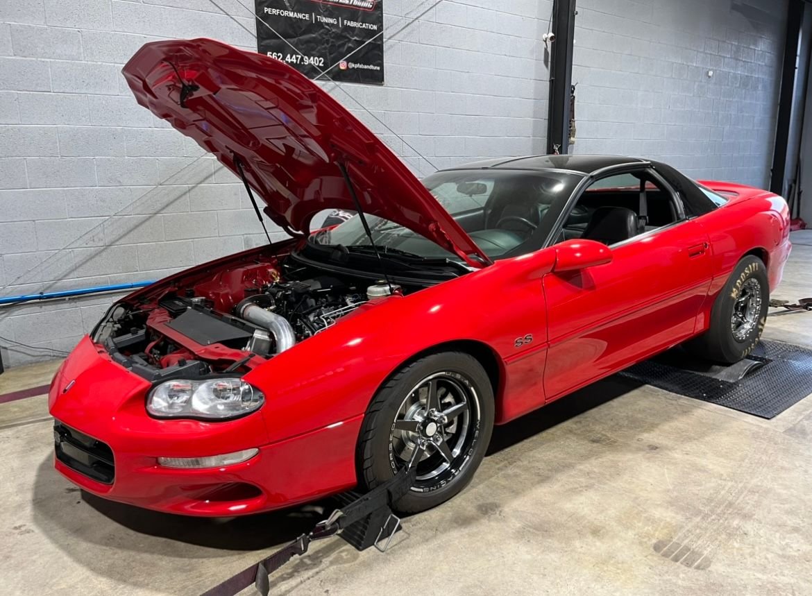

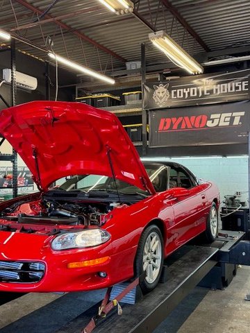

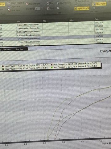

Hit the dyno after the winter of putting a fuel system in the car & D1SC with a front mount. When the car was n/a it put down 488/417 with the Heads/Cam/Intake. This a T56 car with a Dana 60 out back. Hoping to dip into the 9s once everything gets dialed in.
Stock Bottom end LS1
TFS/TEA 225's
Street Sweeper Camshaft
Mamo Ported 102
Kooks 1 7/8th Headers
D1SC with Front mount
Chrs1313 Fuel system on E85
Made 679/534 on 10lbs

Nice! Should get you there but might be a little tricky with the 6 spd. I went 9.35@146 with a d1 making 730whp. Similar car too.

/QUOTE] I think we could have made in the 700's, but he kept timing at 16, he did say if we put more in it would take it just don't know for how long lol
