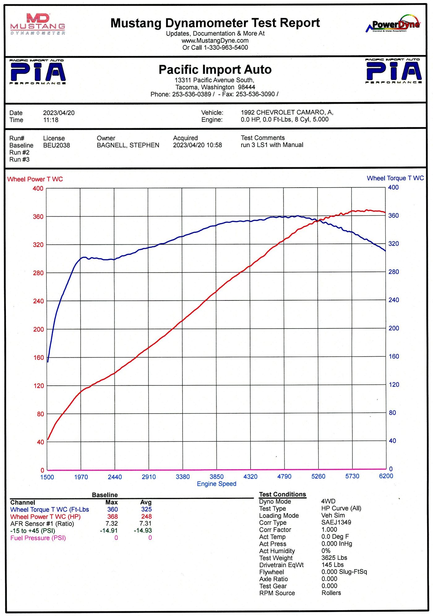

Old thread, but I'll post for future reference.
368rwhp/360rwtq
on an AWD Mustang Dyno
1992 Camaro.
LS1 is from a 2001 firebird.(+T56 Mag-F)216/220 0.600/0.600 112 Lsa cam.(TSP Stage 2 truck cam high lift)Long tubes + dual 3in + 2 Vibrant Bullet mufflers + SpinTech 3000 muffler with side exist exhaust.Crank scraper from Improved racingATI diaper, 10% under drive.Other than that, it's a basic LS1.
