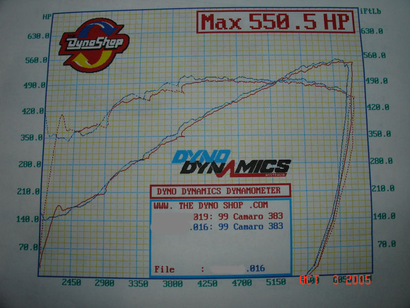

Well after getting to the shop. I was told the Dynojet wasn't working and all they had was a Mustang Dyno .
Even though the Mustang Dyno read lower, its actually better for tuning. Soo...........
I could only get 7# of boost. Not the 10-12 I was hoping for. (Time for a smaller blower pulley)
And running really rich 11:1. I ended up with:
550.5 RWHP - 505 RWTQ - 7# Mustang Dyno
And I have not even sprayed yet.
Does anyone make a smaller blower pulley than a 3.4?

pretty good number considerng boost and cam size for that motor.

Thanks, I was hoping for 10# of boost.

Ed you are running a P1. with a 3.4? and seeing 7#?
FYI I am running a D1 with a 3.7 and see a good 8-9#, 5.7motor, stock cam except, ams though.
Any idea on how small you can go on a (8rib).
Old Oct 3, 2005 | 09:50 PM
Ed Blown Vert's Avatar
Posts: 3,066
From: Sunny San Diego
Yep a P1 with the SDCE tensioner and the 3.4 pulley. I have heard about a 3.2 pulley. Don't know if it is 8-rib.

Nice numbers considering your boost issues and your A/F ratio. That car will be a monster once everything gets worked out....not to mention spray on top of it

11:1 isnt really rich...he wants to be 11:1-11.5:1 on the street

I ran a 3" Reichard pulley on my P1SC, on my D1SC I'm running a 3.2" pulley.
Did you have any problems with slippage with the 3" ?
Old Oct 6, 2005 | 07:58 PM
blu00rdstr's Avatar
Joined: Dec 2001
Posts: 548
From: Dublin, CA
Yes initially, but it was caused by a loose belt or not enough belt wrap.
I finally got minimal slip, but the belt must be very tight, it must be a solid rib (no 'cogs' or notches), and full belt wrap on the blower and crank pulleys.

Thanks, I'll see if I can get a larger crank pulley instead.
