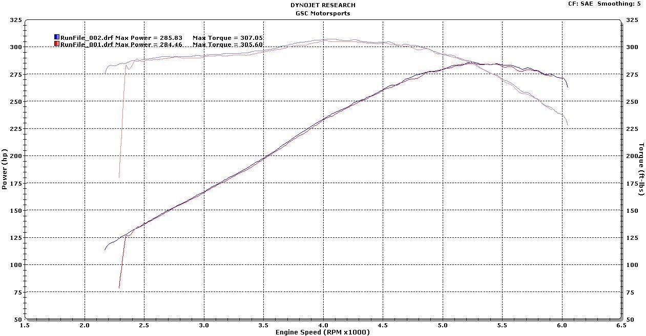

I have a 98 M6 SS and I think I dynoed kind of low. The only mods I have are a hooker catback and an SLP lid. I only dynoed 285/307. The only reason I can think of is that my clutch is pretty bad. Could this actually show a big loss? If so, how much do you guys think?

Your numbers do seem pretty low for an M6. If your clutch is slipping it can definitely affect your dyno numbers. What kind of dyno was it?

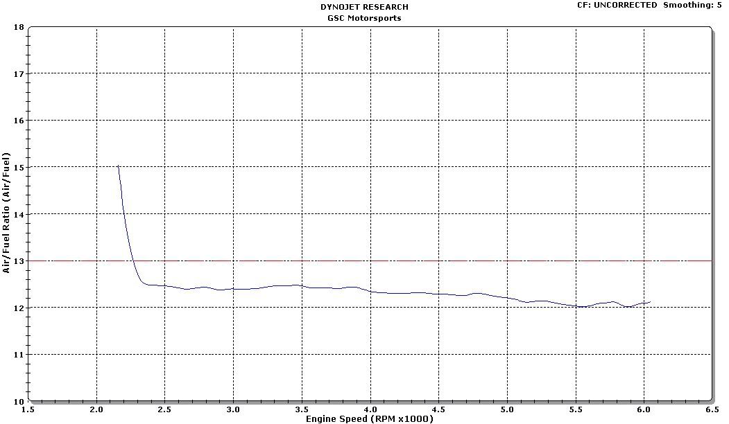

a/f was right at 12.5 almost all the way across. and yes, my clutch is REALLY bad

here's the graphs
Old Dec 20, 2005 | 05:51 PM
JohnnySuperSport's Avatar
Joined: Sep 2005
Posts: 56
don't know why the a/f one is so small but the red graph line above the a/f reading is 13
