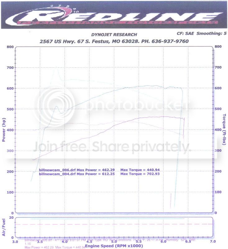

Finished this up on friday morning, and tuned friday evening. Mods as follows.
Stock 243 heads, with stainless 2.02/1.60 valves, nice valve job, minor bowl work.
Comp Cams 222/224 on a 112
ARH 1 3/4 race headers
C6 Z06 full exhaust (open)
Nitro Daves plate kit (125 jets)
Also this is an A6 with no converter.

Freakin awesome numbers man with A6 WOW and great work.

Stock water pump, factory LS2 intake (with the casting smoothed out), and the TB was slightly polished up. I wouldn't really consider it ported, because they don't have much room to work with there, but call it what you want. Factory pulley as well.

WOW, you pick up 150 rwhp and 262 rwtq from a 125 shot through an A6. What kind of power levels are the A6s rated for?

Nice results, hope the trans can live

pulley, milled heads, and 1 7/8 headers would have really made it shine
