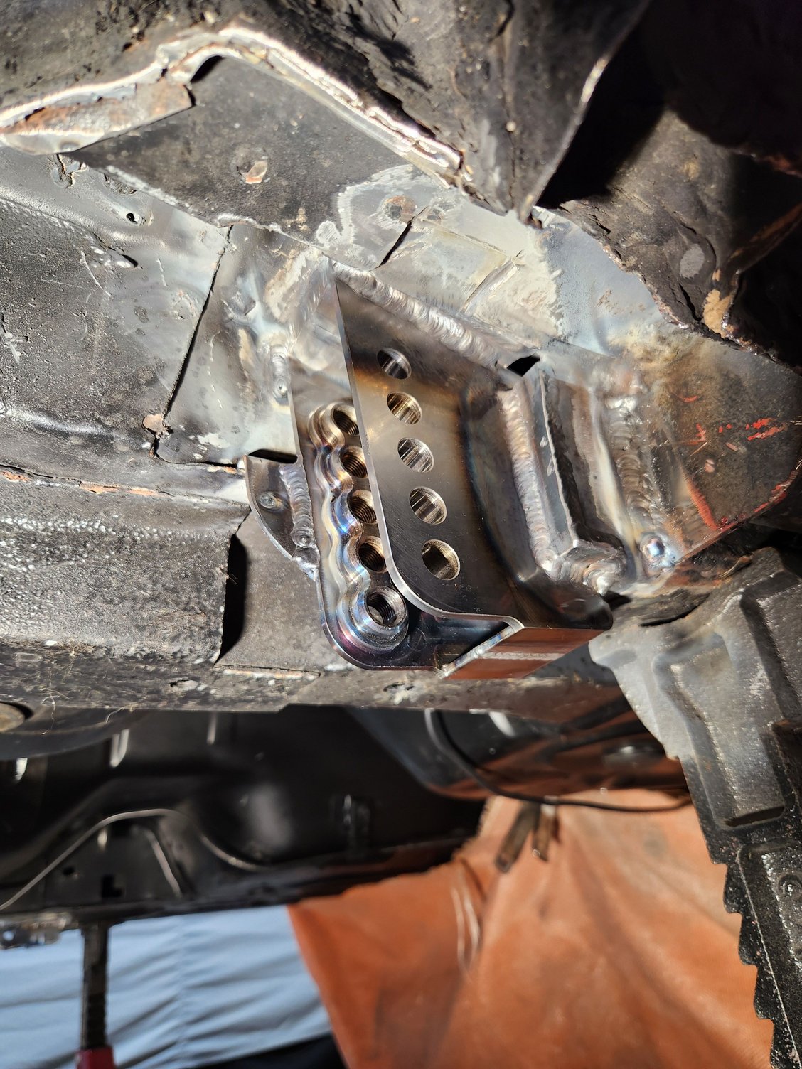

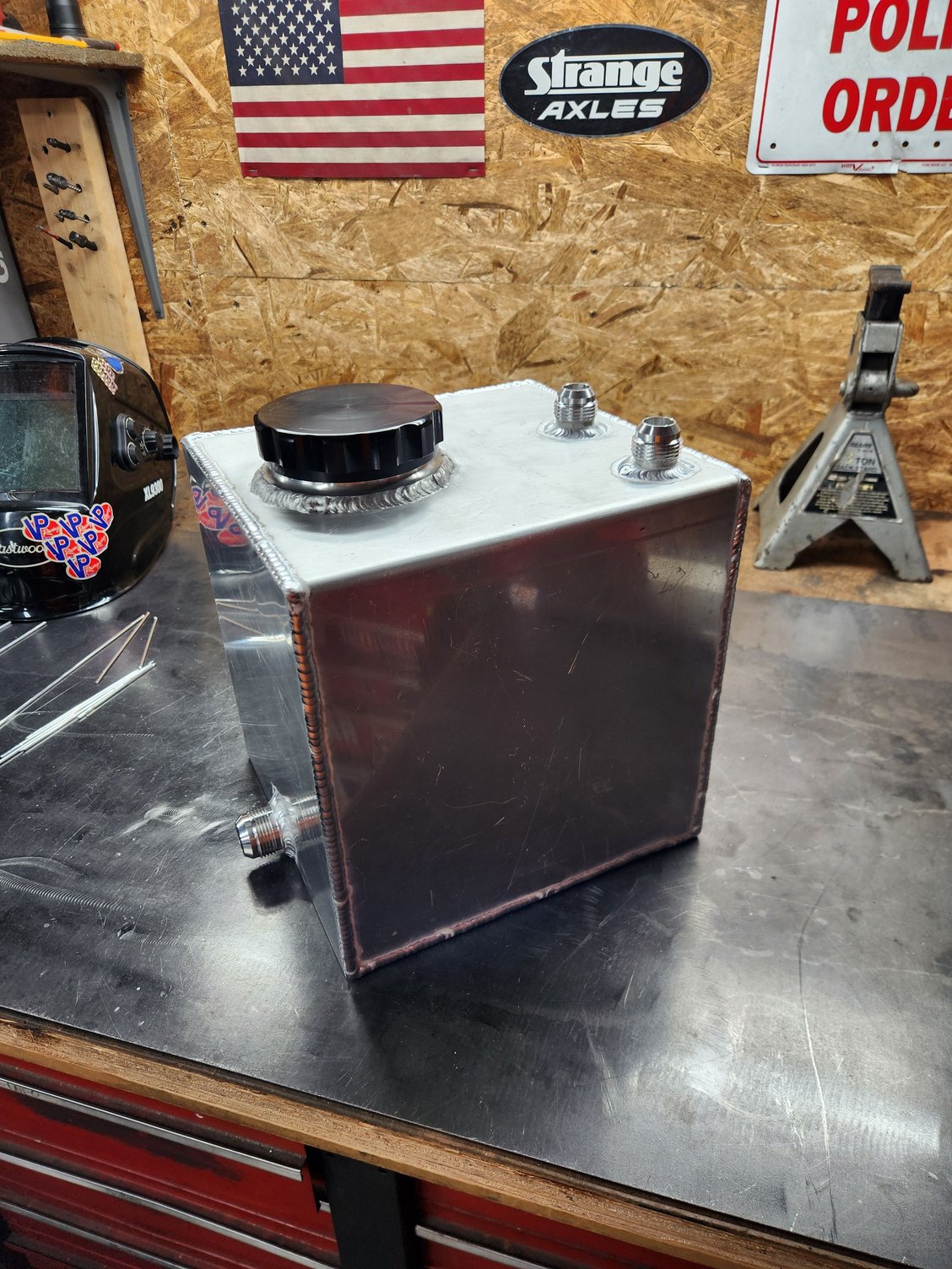

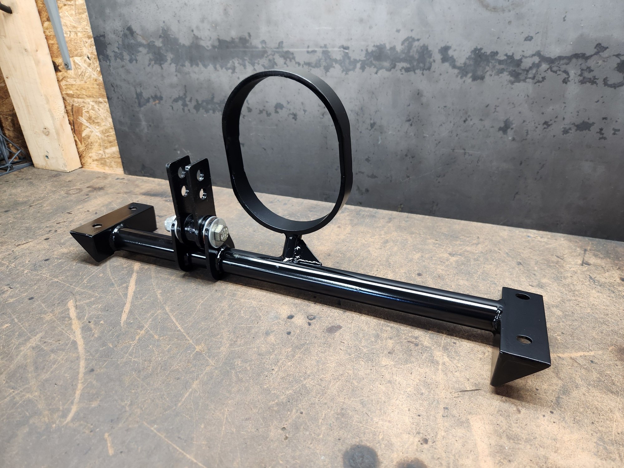

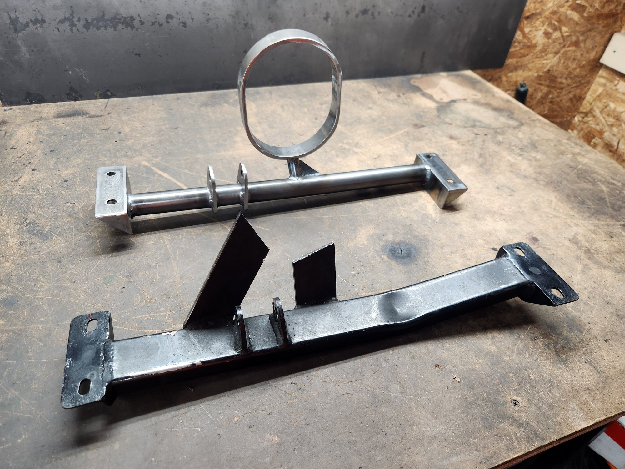

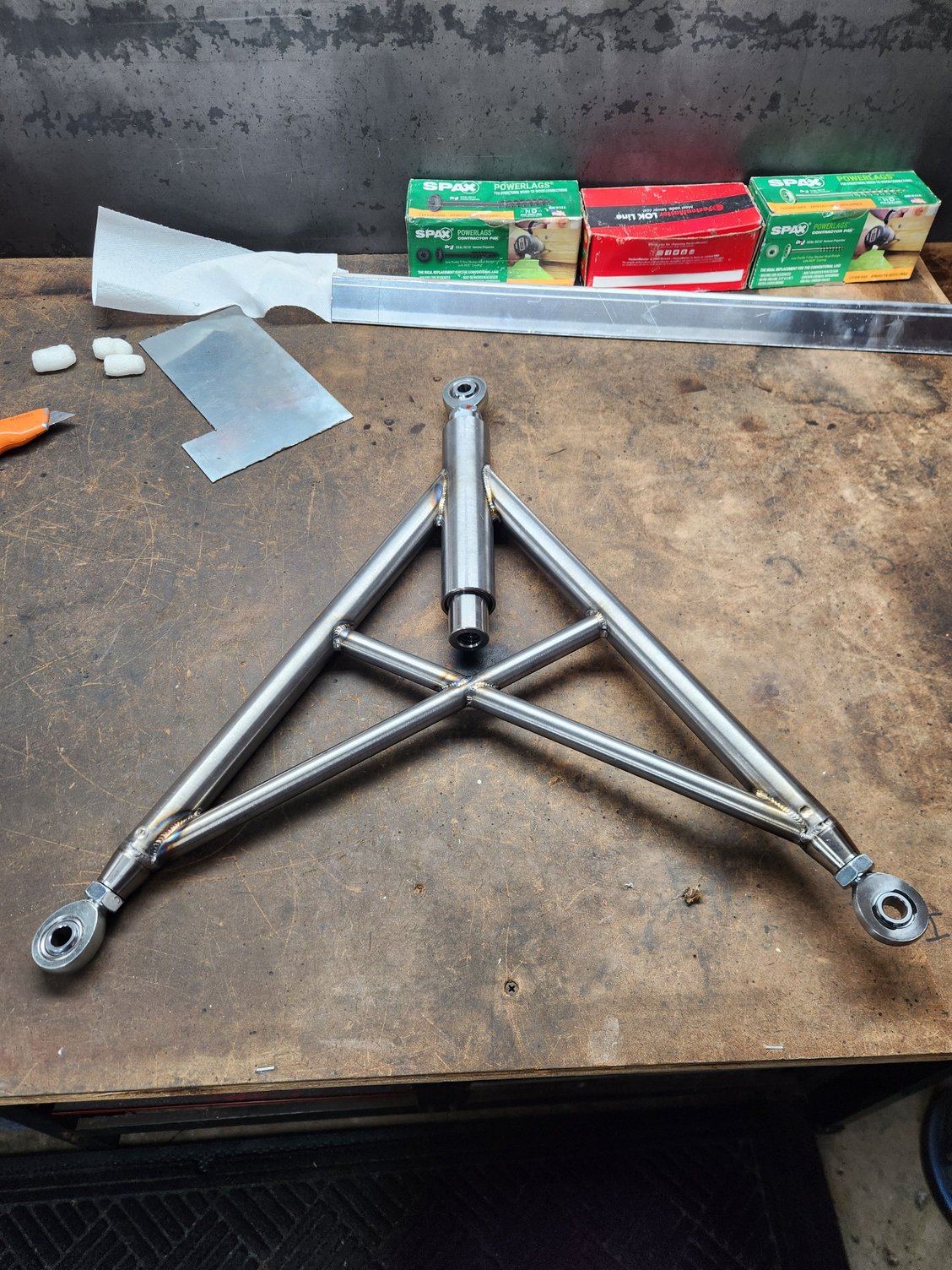

Originally Posted by Taubr Unit
Thread bump....
Quick winter update, welded in Tick torque boxes to add strength and more har angle. Made a 4 gal fuel cell and got rid of my 12 gal cell. Don't drive the car anymore so lost a lot of fluid weight off the car. Ditched the panhard bar, cut off all the brackets off the car and adding a wishbone from Hammer Concepts. Then made my own torque arm mount due to the old one pushing my rearend off center.
Did you weld in the control arm boxes yourself?
If so how was the install?
Did you have to pull the carpet?
Looks great btw.
Looks great btw.
Yea I did all the work besides weld the wishbone. They are pretty easy to do honestly. Tig welding them in gets a little tricky at times but if you mig them in, it'll be a breeze!
