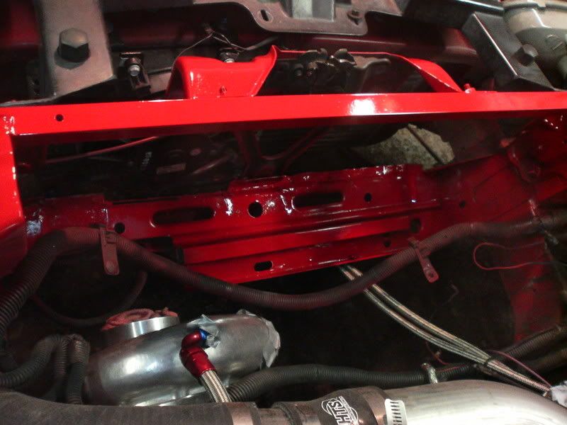

Here is my old one. The rad. was a little taller than the factory one, so I had to cut out the bottom support and make a new bottom support as well.
you can see the bottom support there (unpainted)
and there is my hand-bent cover for it. Tucks in nicely.
