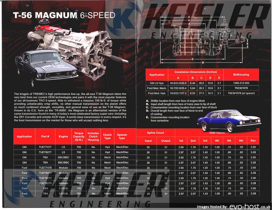

Some Magnum info
http://www.rodauthority.com/tech-sto...reet-or-strip/
With the off the shelf Magnums, at least on what they call the GM LS platform, the further rearwards shift position they offer is still 3" further forward than an FBody.
Standard T56 or 6060 unit
This site offers some shift position options
http://www.southernperformancesystem...-dims.html#t56
Magnum shift positions

I'd found that first chart previously, but thanks for that second one.
There seems to be lots of shifter options though it looks like, so it looks like I should be fine with fitment.
I think I've got pretty much all the info I need now, thanks everyone.
Pretty much gotta decide which one to go with, but I think I'll just wait and save for a Magnum.
