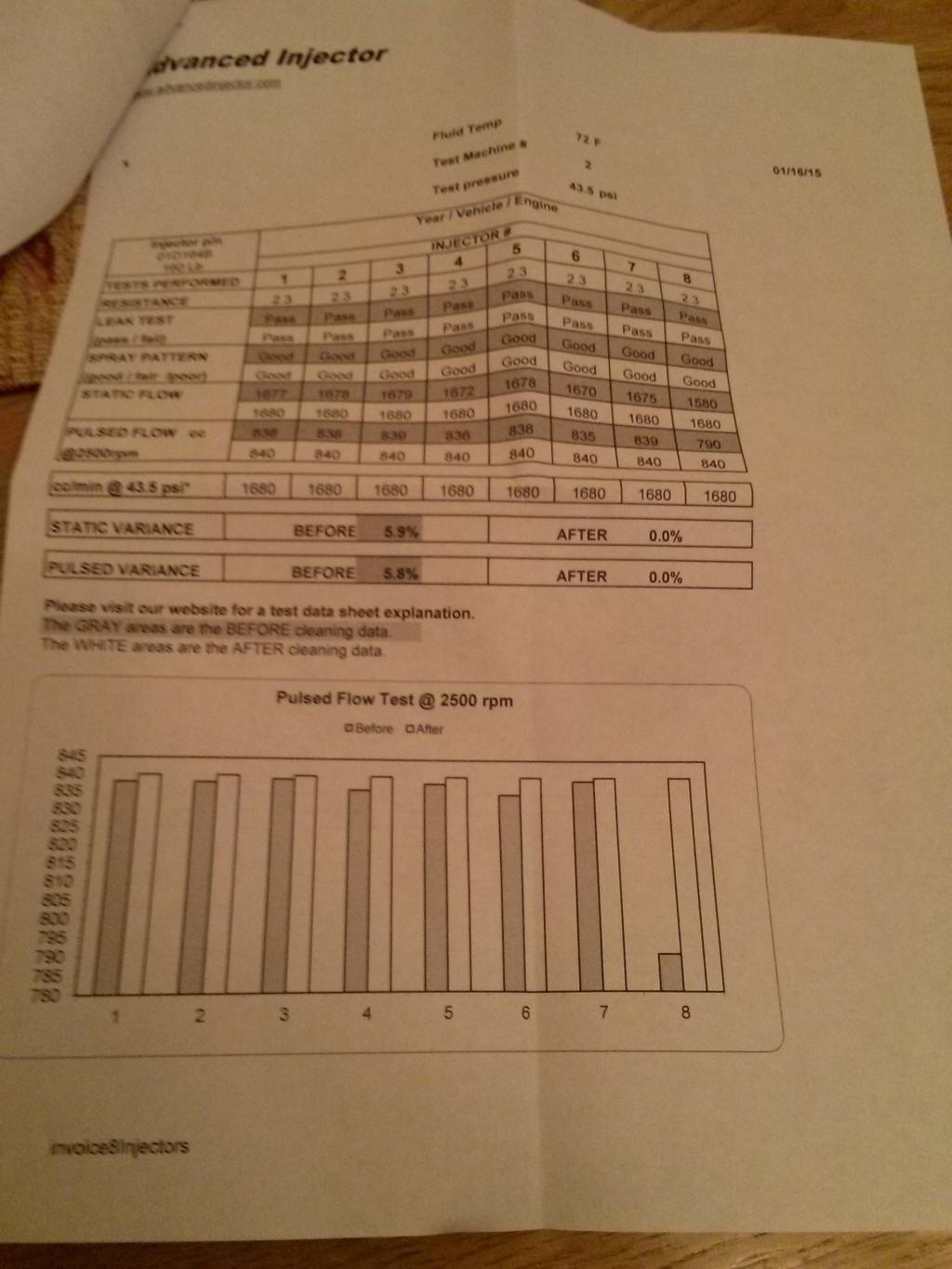

I think there are 3 separate problems here…
Problem 1) Pre-injector “goo” that clogs filters is not the same as post injector “goo”. I know it exists, but I’ve never seen pre-injector Goo. I started with 100% new fuel system. Poly tank/SS lines/anodized fittings. I split my paper element filters yearly and have never had a problem there. Everything pre-injector looks great. If you’re getting crap in your filters I believe it’s either form your existing dirty tank, fuel system, or some sort of problem from the stations fuel filtration. I don’t believe Goo can “grow” in a clean fuel system and clog filters.
Problem 2) I have always had problems with post injector Goo. (on several cars over 5-6 years) Build up on the injectors is form a chemical crashing out of the fuel mixture post injector. This isn’t going to hurt or clog an injector internally. But it can build up enough to eventually cause flow and spray pattern issues. Injector design, leakage, driving habits all play a big roll. Cycling pump gas or adding toluene, carb defender, Lucas, etc all seem to help with this.
Problem 3) Similar to methanol, ethanol will “Gel”. From what I’ve read the fuel needs to mix with free air and/or moisture to “Gel”. At the start of the 2014 race season I installed new 160lb injectors. I had an engine failure mid 2014 (unrelated to goo) and pulled my injectors/rail and let them sit for a few weeks while I threw in a replacement engine. I believe this caused a problem internally with one of the injectors causing it to flow significantly less. I ran the spare engine the last half of the season without any noticeable issues. Tore this engine out a week ago and found the #8 rod bent. Took my injectors in to be flowed and found the #8 was down on flow. Graph isn’t a great representation. Was basically flowing 6% less at that DC. We pulled the injector screens and found no material in them. Sonic cleaned the injector and it flows like new. So I’m assuming this was due to some sort of gel or buildup internally. I also have no proof the slightly low flowing injector caused my #8 rod to bend. Sure seems likely though.
