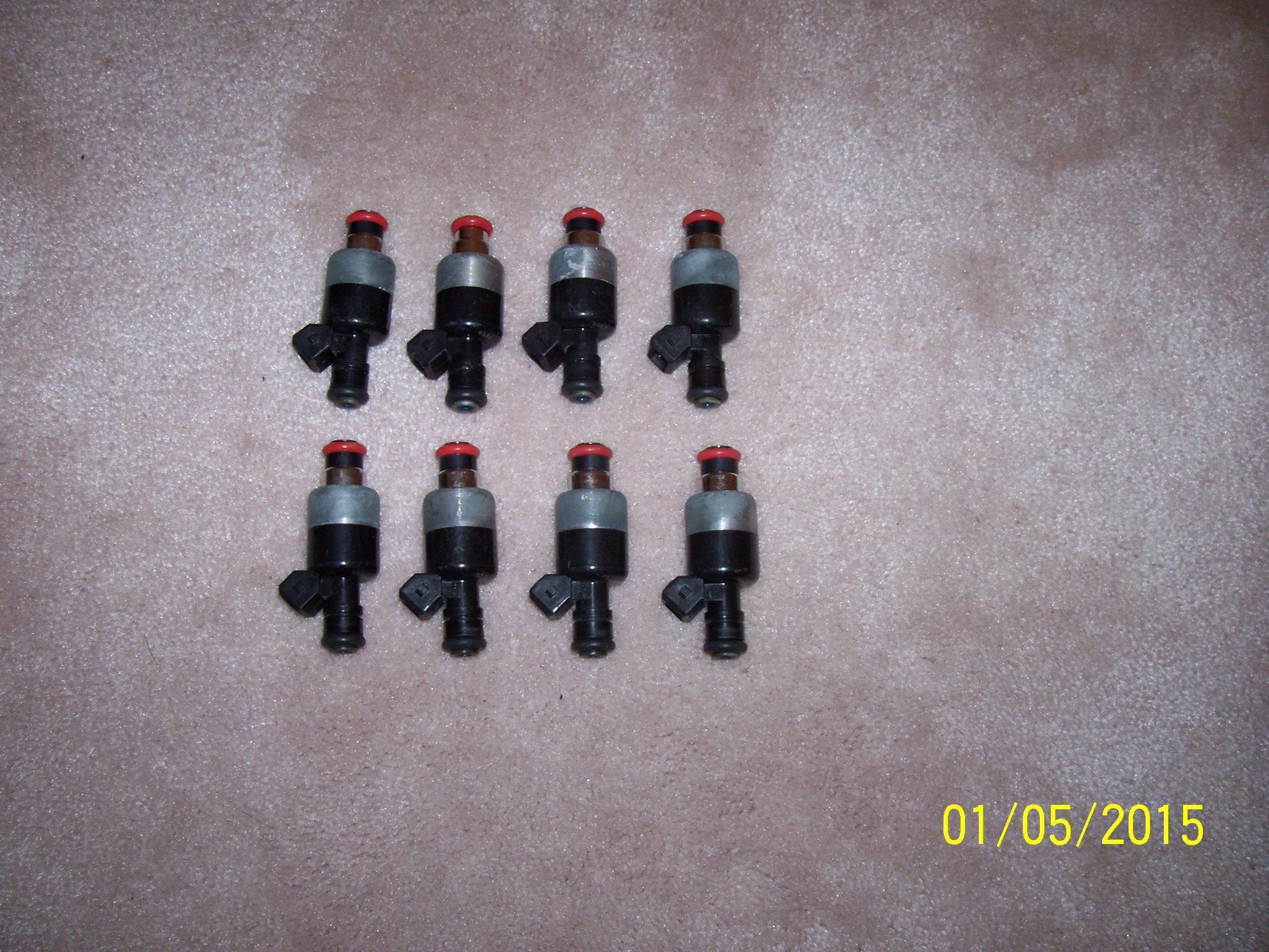

These. They are Delphi 96lb. Part # 17113744.Just had cleaned and flowed by Lingenfelters. $200

Thanks guys. That's refreshing. I have been eyeing them up and even used them before. I just didn't know if there was any better options right now.
Bln, do you have a receipt from Lingenfelter for those injectors?
