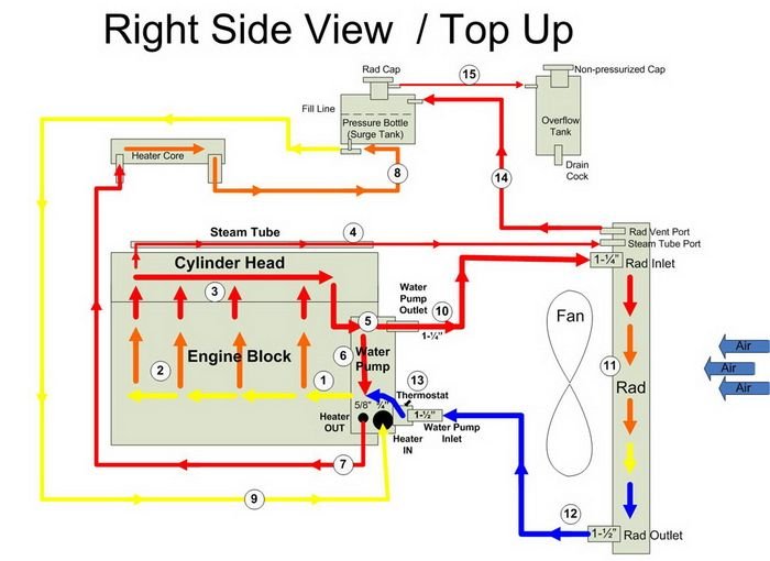

okay so I have a stupid question.. if you read my coolant temps above the upper hose is cooler than the lower by a substantial amount. I thought I remembered reading about cooling flow direction so I looked it up again.. Heres the picture I found. Are we overlooking something so simple or is this diagram wrong?
Old Aug 14, 2015 | 09:27 PM
  #42
xxwhiteneonxx's Avatar
Joined: Feb 2014
Posts: 94
Okay so i let my 2013 silverado run through a complete heat cycle while monitoring everything. I used those numbers to compare to my camaro..
Okay so lets start with lsx motors being reverse flow. To those who may not know what this means, it means the the coolant flows into the motor from the lower hose and out the upper hose. Now with that, my truck when temped throughout a full heat cycle would show 215 upper rad hose and 99 low rad hose. From what i gather my truck has a 195 thermostat.
So now onto the camaro. First 5 minutes, lower rad hose was cooler than the upper. Okay, cool. After that, they ramained very similar in temp. I think i have it figured out and ill run i by you guys and see what your opinion is.
If you notice in the picture below, my downpipe ( 4") is only an inch away from the rad hose. Now i temped it with the car running and even though the downpipe is wrapped its still seeing 300+ degree temps.
So now im thinking the downpipr is heating up the what should be " cool " coolant going into the motor. If im thinking right with my theory, my car is reacting as if the thermostat is " stuck open". Reason im saying this is because the downpipe i believe is reheating the already "cool" coolant and making sure the thermostat never has a chance to close and regain a lower temp.

ok that steam vent is a by pass for water meaning it can circulate without going thru the radiator. I dump mine into the upper waterpump neck so it goes thru the radiator.
my hot side is unwrapped and a lot closer than yours and I have no issue so that should work good it looks very good.
where is the timing when driving easy. ?
get it running and check the heat at the tanks see if that rad/fan setup is removing heat . I can tell you if you don't have a ton of airflow on that turbo it will radiate heat into the rear core of the radiator and reheat that water. so make sure there is a good temp drop from driver to pass side tanks. that should be very accurate being there aluminum.
you might try removing the rear hood seal to help get heat out of the engine compartment. if you close the hood and the heat is trapped it will just circulate and keep getting hotter.
its a good idea to close the hood and try to block off any area where under hood heat can get from the engine compartment back to the fans . make sure it has to suck cool air and push it thru the radiator.
you will need good fans on that car as it looks like you will not get much help from road speeds with the intercooler up there. hope you get it cooler. good luck.

okay so to answer your questions. i have removed the hood gasket ( awhile back) and it didnt help ( or if it did, it wasnt noticable). Now, the next thing is airflow, i built an airdam and like previously stated im not overheating yet but its going to happen. At idle, once it hits into the 215's, itll start sowly creeping up until i shut it off. My truck, does not do that, so this isnt right. ( obviously).
According to charts i read, i have plenty of fan for my setup being a small block. They claim you need 4000 cfm. I have 5200 cfm as pushers ( 80% efficiency) . So, in theory that should not be my issue.
From what i know now about cooling steam vents and reverse flow patterns, my steam tubes should of vented to the upper hose not the thermostat housing. I do not however think that would solve all my cooling problems but it may help them.
As stated previously i think the downpipe is heat soaking the rad hose and causing the fluid to reheat and allow the thermostat to stay open all the time.
Now, as you can i have the downpipe wrapped. ( 1 layer).. Can i mulilayerthe heat wrap on the downpipe to achieve more cooling efficiency?
What i can tell you about the end tanks is the rad isnt hot. When the temp of the vehicle is 225 the radiator ( this is a full idle heat cycle so now air has hit the rad) Is only 143 degrees.
If you measure from the radiator side of the lower hose then measure it on the thermostat housing side, it has substantially raised once its passed by the downpipe.

Although it's just simantics, an LS cooling system is not a reverse flow system. In a reverse flow system, the coolant enters the head first, then goes through the block. Not the case here. Either which way, when the engine is 225, you shouldn't be able to touch the radiator without burning your hand (above the fan that is). Below the fan is another story. How much timing at idle? Low timing will affect exhaust/engine temp tremendously. Don't believe the whole "the coolant is going too fast through the radiator" BS. The engine temp should definitely stay in check while sitting idling. If that's not straight, typically your problems will only become worse when driving. I'd still mount some sort of heat shield between the DP and the radiator hose if you think that's a problem. Bend up some cheap thin wall aluminum and metal zip tie it temporarily to the DP as it sits right now. Easy enough to try, just be sure you have an air gap between the pipe and the heat shield. Otherwise you'll conduct heat from the pipe to the shield rendering the shield useless.

Let's think about this. Your upper hose should always be hotter than your bottom hose once up to temp correct because the radiator cools the coolant, right? Yep, if not, that means the coolant isn't flowing through the upper hose. Why would the coolant not flow through the upper hose? Only a bad pump or a restriction not letting the coolant out of the radiator. Notice on an LS engine the tstat is after the lower hose. The tstat extends into the water pump and is exposed to the recirculating coolant from the water pump. After the tstat, The coolant goes from the block to the heads to the pump, recirculates down to the tstat and back into the block. Once the stat gets to temp, it opens and allows the coolant from the radiator into the block. This is really simple. I'm not being demeaning at all, so please don't be offended. Maybe your stat isn't opening fully?

Well heres another question to go along with this. Would the front steam tubes being plummed into the lower waterneck behind the thermostat ( engine side) cause any issues like this? I mean in theory im putting hot coolant back into the already hot motor.

The steam lines being pumped back into the back side if the pump may not be the best bet. As I understand, they should be on the radiator return side or in the upper hose. Which makes sense, you want ALL of the coolant to go through the radiator. Otherwise, it's just recirculating some hot coolant. The water pump does that until the stat opens then the coolant goes to the radiator for cooling after the stat opens allowing the coolant from the radiator to the engine. The fact that the upper hose is cooler than the lower is still stuck in my head. The upper is the "hot coolant" return. Id pull the stat and check it then just leave it out for a test and just see what happens without it. Could it be defective from the factory? Hell yah! Very possible. At least you'd know if it made a difference. Really without it, all your temps should be close until the fans come on. That upper hose should be scorching. I'd try it. What's it on a hurt? I know antifreeze is a pain in the ***, but it's worth it to me. Hell, if it finds the problem, you could be out in a few hours enjoying your car and not worrying about it anymore.
