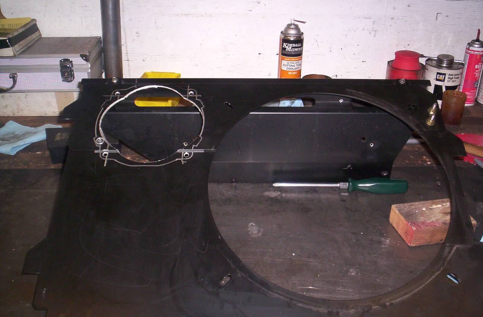

Conan do you have another pic of the rad shroud, I am trying to see where the two pieces come together (upper and lower). It looks like you would have to cut a half circle on the top part then another half circle on the lower part of the rad shroud. Could someone who has done this shed some light on this, and maybe share how they did this?

Here's a few more pics, I used a 5" hole saw and drilled the edges and then ground out the rest. The hole does extend into the lower half of the fan shroud. I bolted the two sections together before I started drilling. I used a 7.5'' 440cfm Spal puller fan, but I think I've seen people use up to a 9'' fan. This is where I buy my fans from http://the-fan-man.com/ But Summit or Jegs will have them too.
I would also look at the LT1 radiator Like Alchemist suggested, Its not that expensive and like he said it drops right in. I don't think you can go wrong with doing both the radiator and the second fan.
This will help with the wiring if you add the second fan https://ls1tech.com/forums/forced-in...ring-help.html
Here's a couple more pics of the process...
