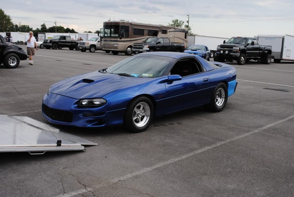

In 2010 I decided to adult and sold my last car, a 2001 Camaro that over the course of 7 years ended up with a S88 turbo / 410" engine and ran 9.000 @ 153. I sold it to a gentlemen down in Mississippi, and he had it running well into the 8's. This was the car:
The car was great, built well, but I was tired of the car scene and said I'd never do that again (to that extent). Well, 2013 came around and I had to scratch that itch, so I became an idiot again and bought this:

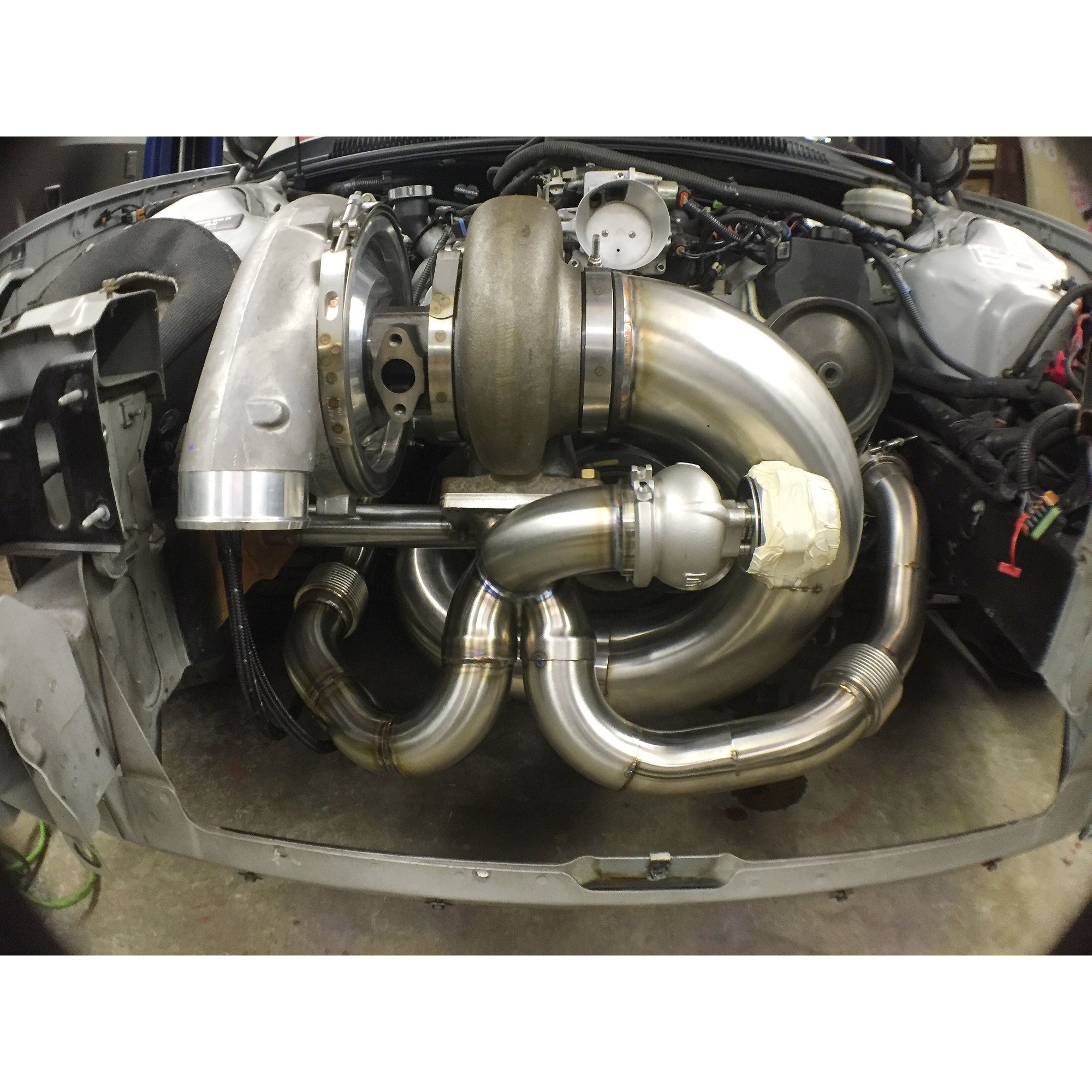

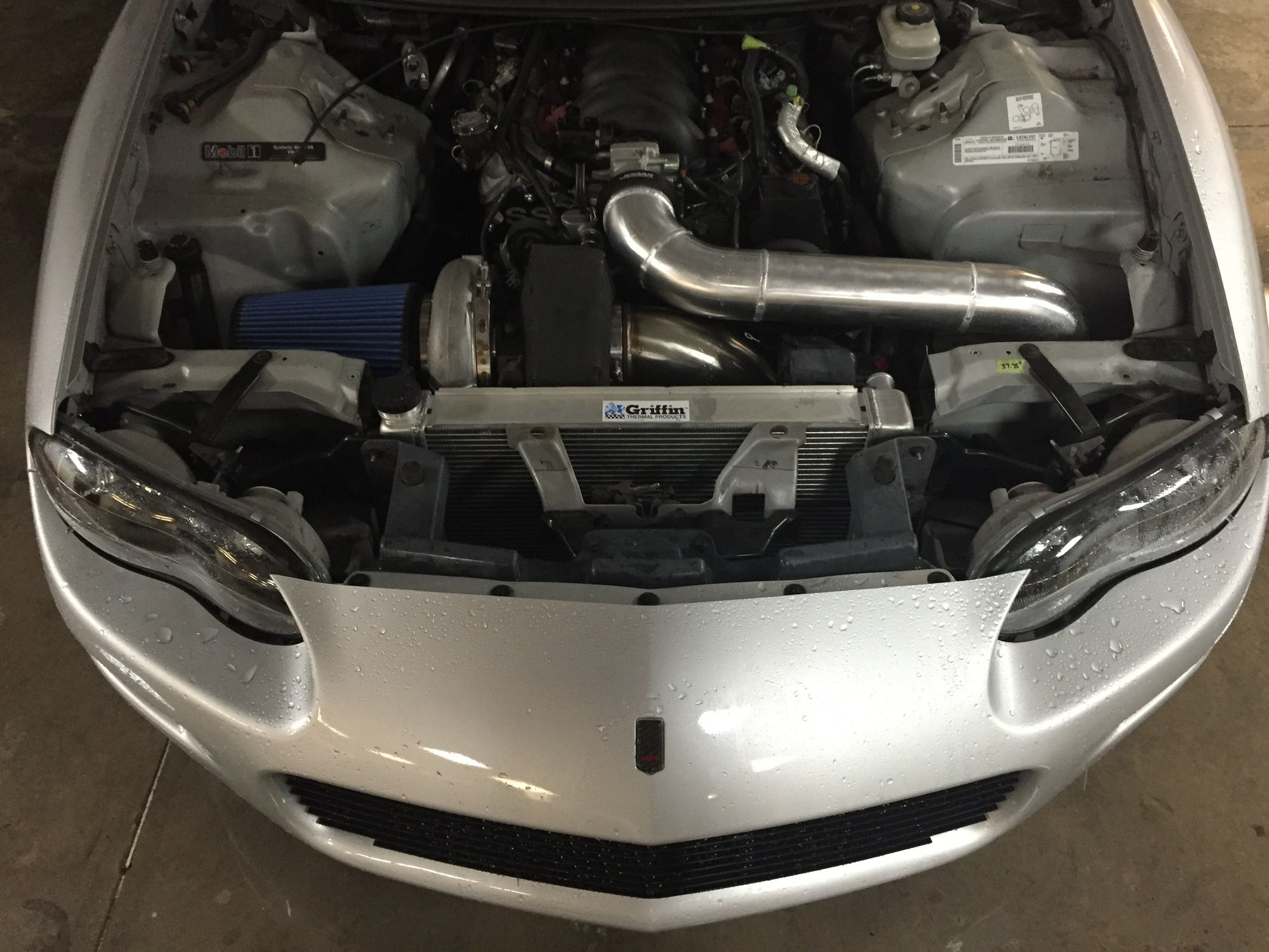

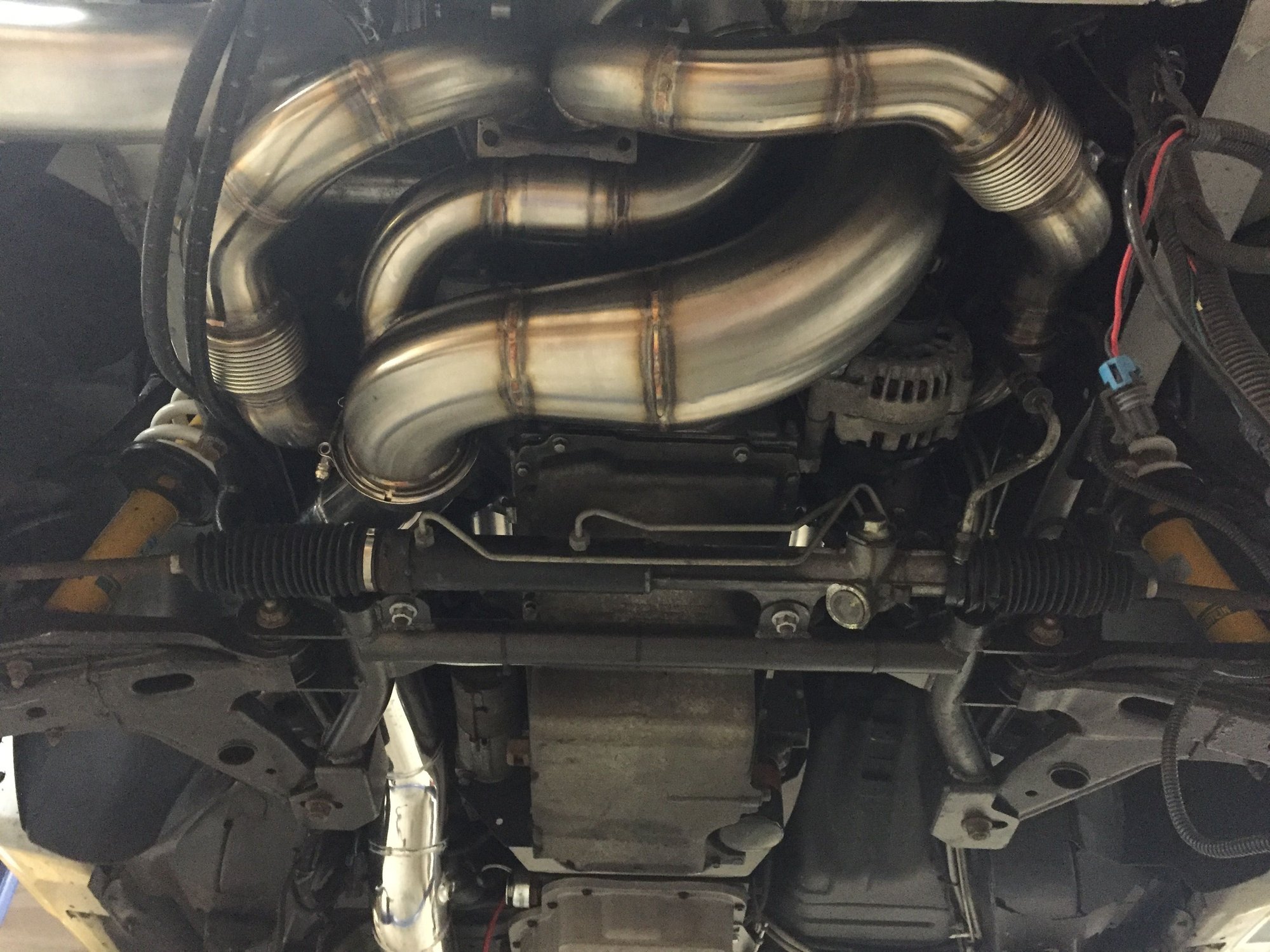

Then I came across a deal i couldn't refuse for the turbo. A picked up a brand new Garrett GT5533R with a Forced Inductions billet 6 blade 94mm wheel and backing plate from a member on here that needed to abandon his project. I gathered the rest of the items needed and got to work. The only problem was, I just don't have the time to dedicate to the fab as I did before, so I decided to have a local guy build the turbo setup. GREAT DECISION. I used "Filthy Habits Fabrication" out of Western New York, but he is soon moving to the Harrisburg, PA area. Strongly recommended as his fabrication skills are bar-none, and he is great to work with. Anyways, this is where I'm at:

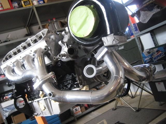

-V-banded manifolds
-2.5" 304ss hotside with flex bellows
-Turbo is hard mounted to chassis frame with 1.75" tube, but is removable. Very slick setup that Jay @ Filthy Habits came up with.

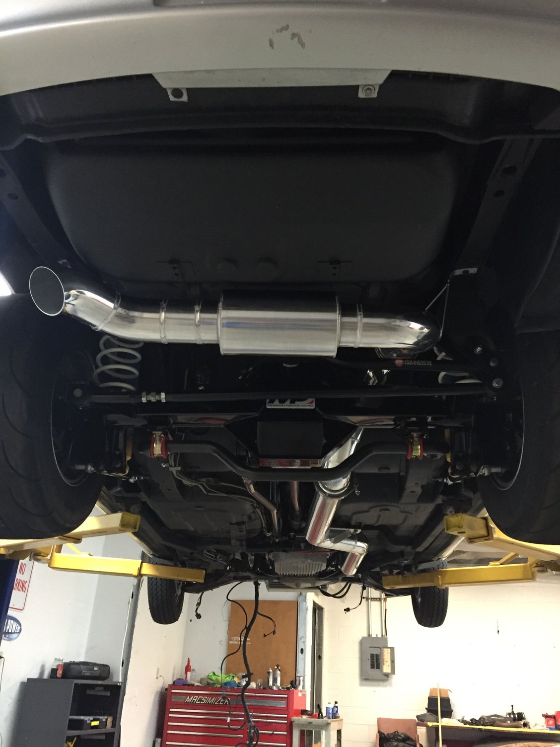

-5" 304ss downpipe necked down to 4" aluminum exhaust from the k-member back
-4" aluminum exhaust over the axle with an aluminum bullet muffler and a single hidden outlet
-3.5" aluminum charge piping from turbo to IC. 4" from IC to TB. IC has v-bands and the TB has a Jodar clamp.
-IC has a 6" thick Garrett core, built by Chiseled Performance.

Secondly, that is absolutely immaculate. The plumbing of that honking turbo is pure finesse. It should be ridiculously fun to drive.

You already know how much I support Jay - Filthy Habits as he has been a good friend of mine for many years. As always his work is very clean and well thought out.

oh my fabrication boner, that underside shot of the turbo plumbing is the background for my computer now. That is so well done, wow. Good luck balancing the wife and the car!
