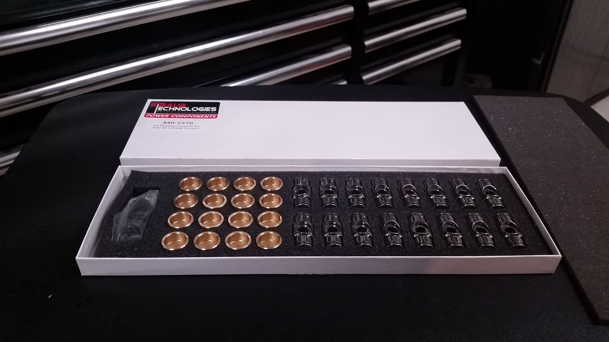

We'll soon be installing these on a turbo swap soon. Very,very nice kit. Very well packed.

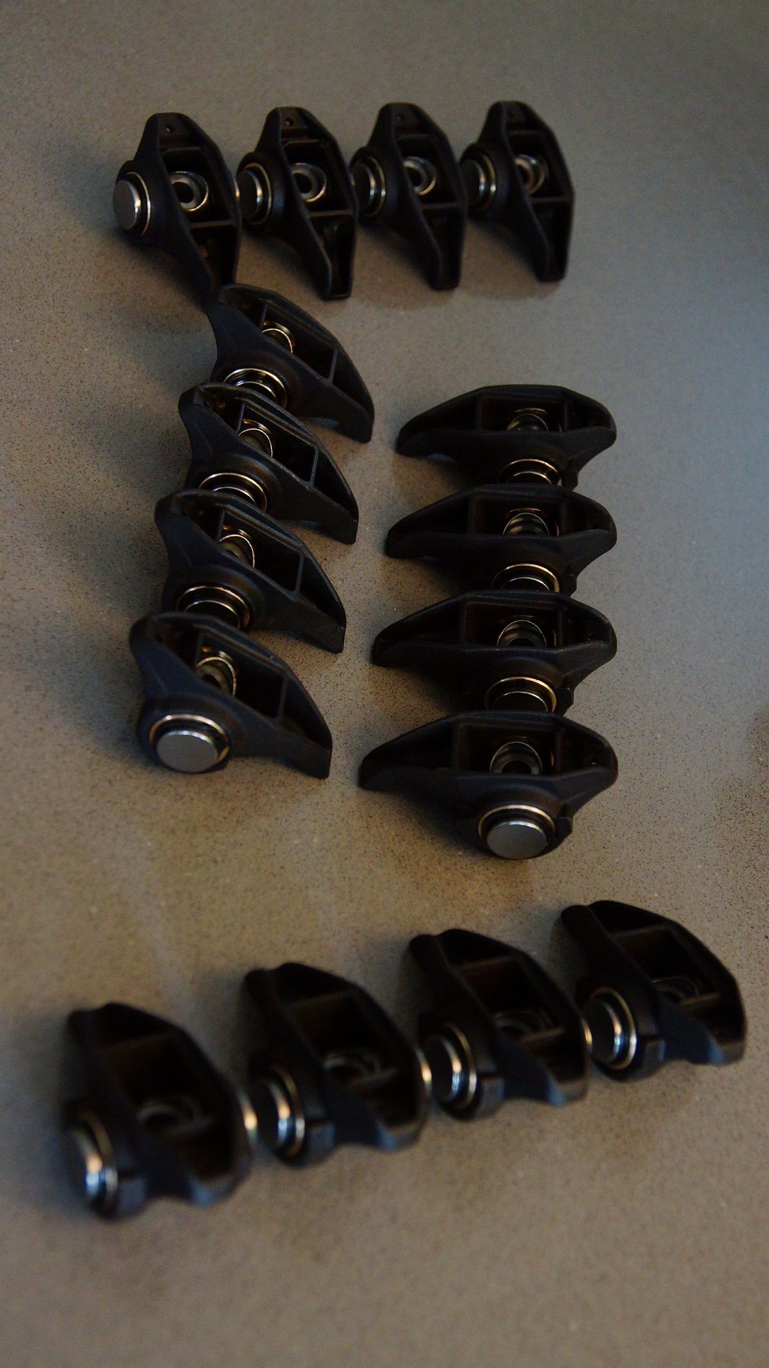

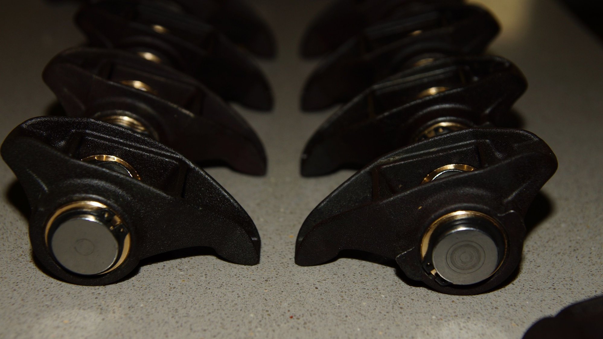

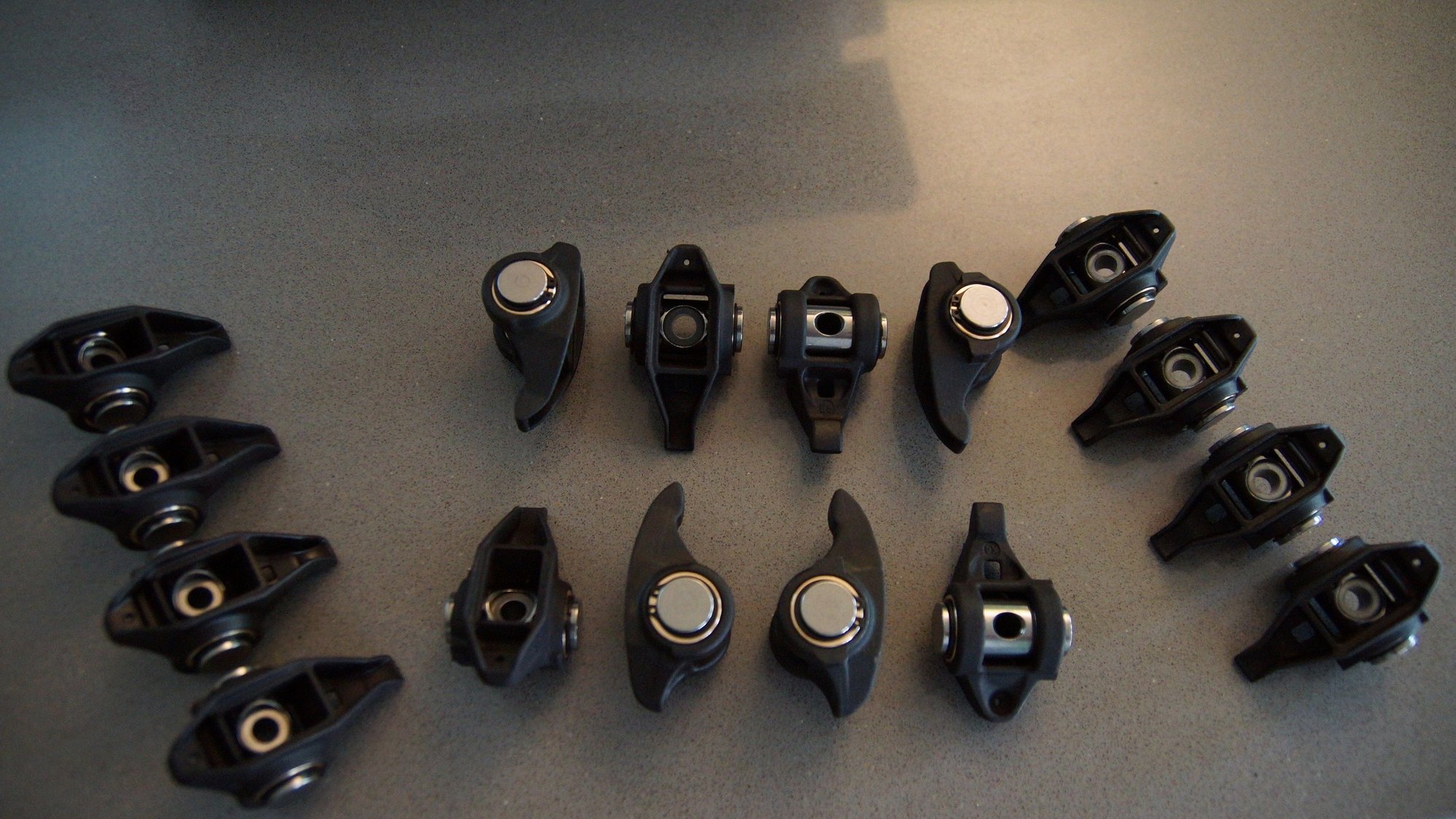

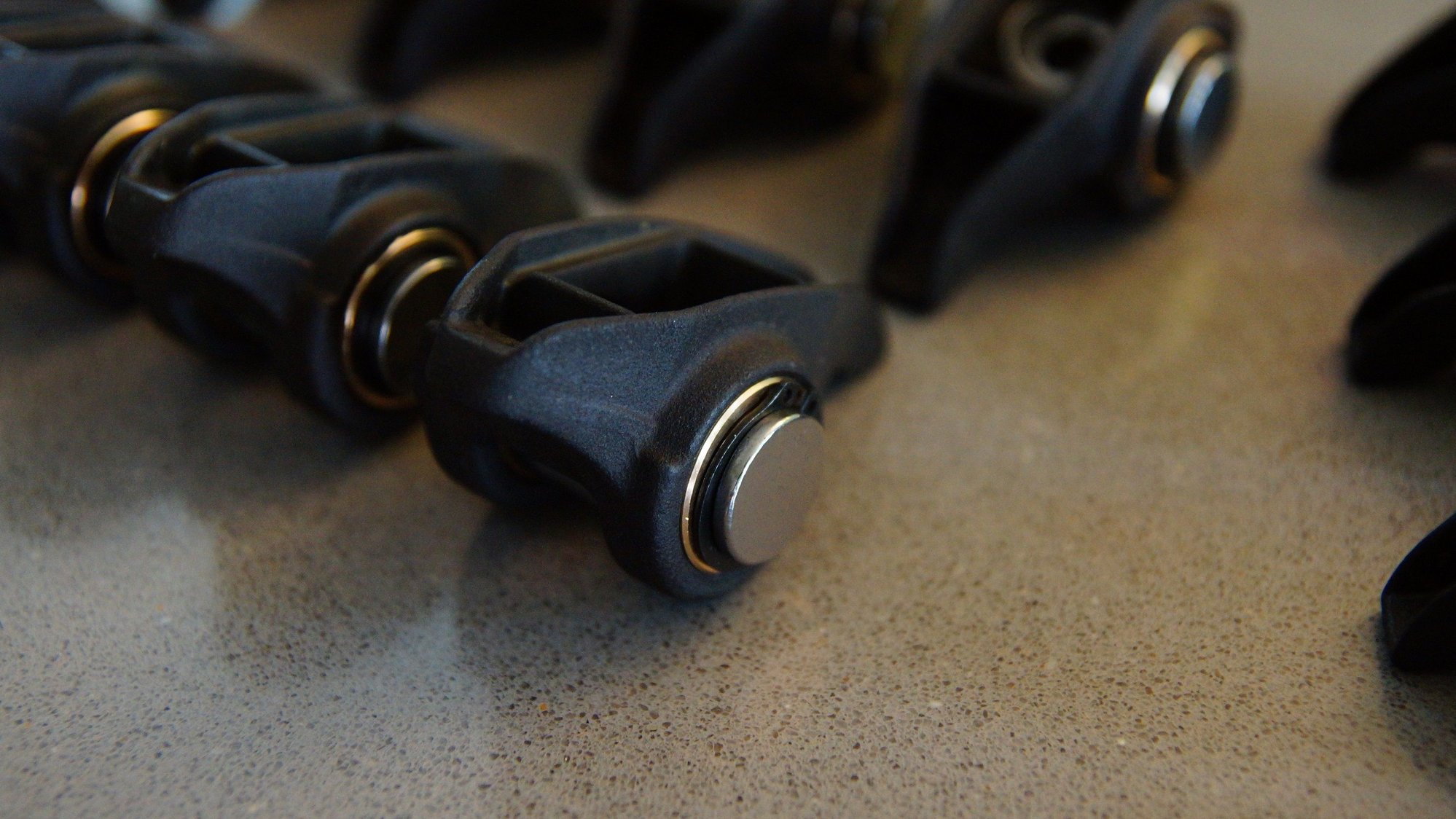

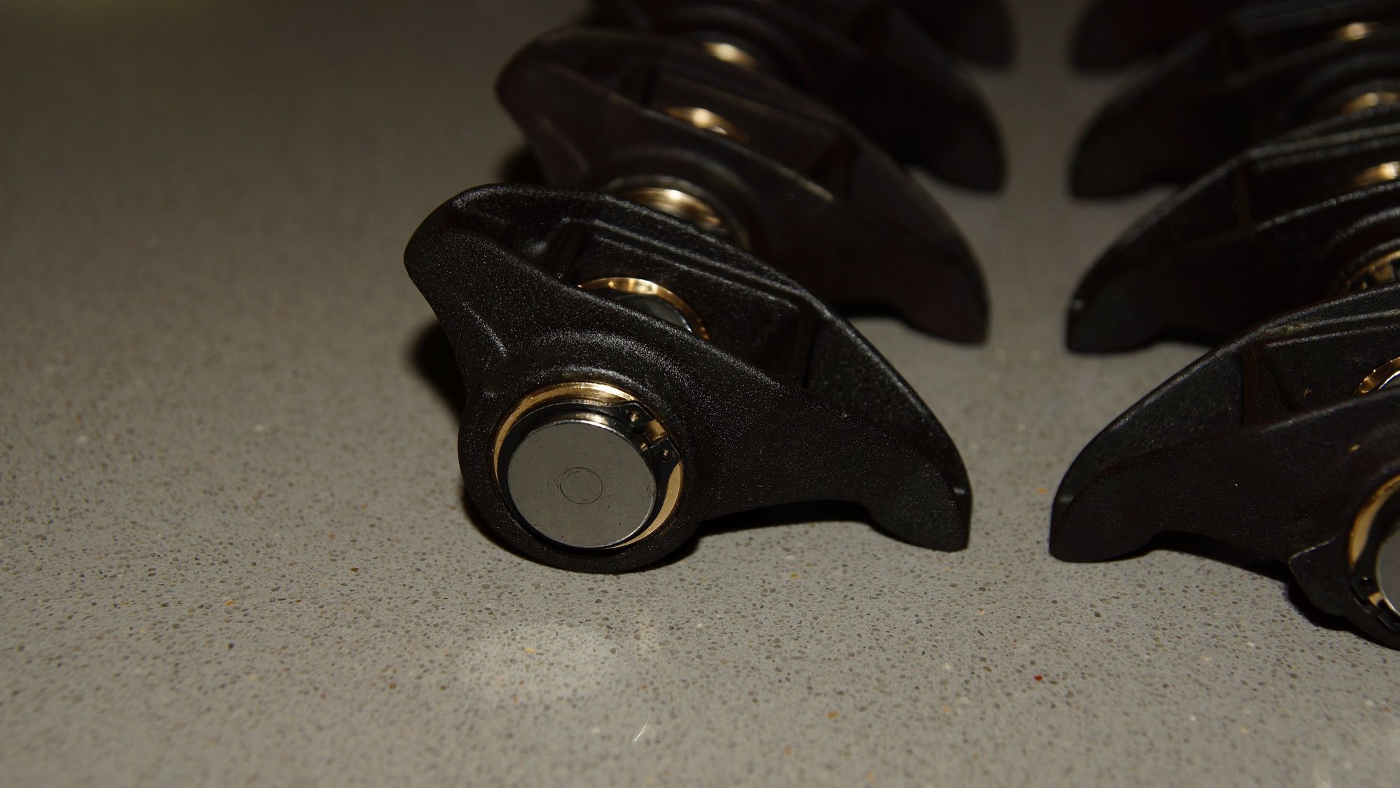

Got my sets this week. Had some rockers I Parkerized(phosphated) for fun. The black/oiled finish really makes the new goodies "pop."
Sadly I won't be able to run them for a while but they certainly do seem like they will do well when I am able.
Sexy.

^^Those look awesome^^

Really digging the finish on those rockers!
