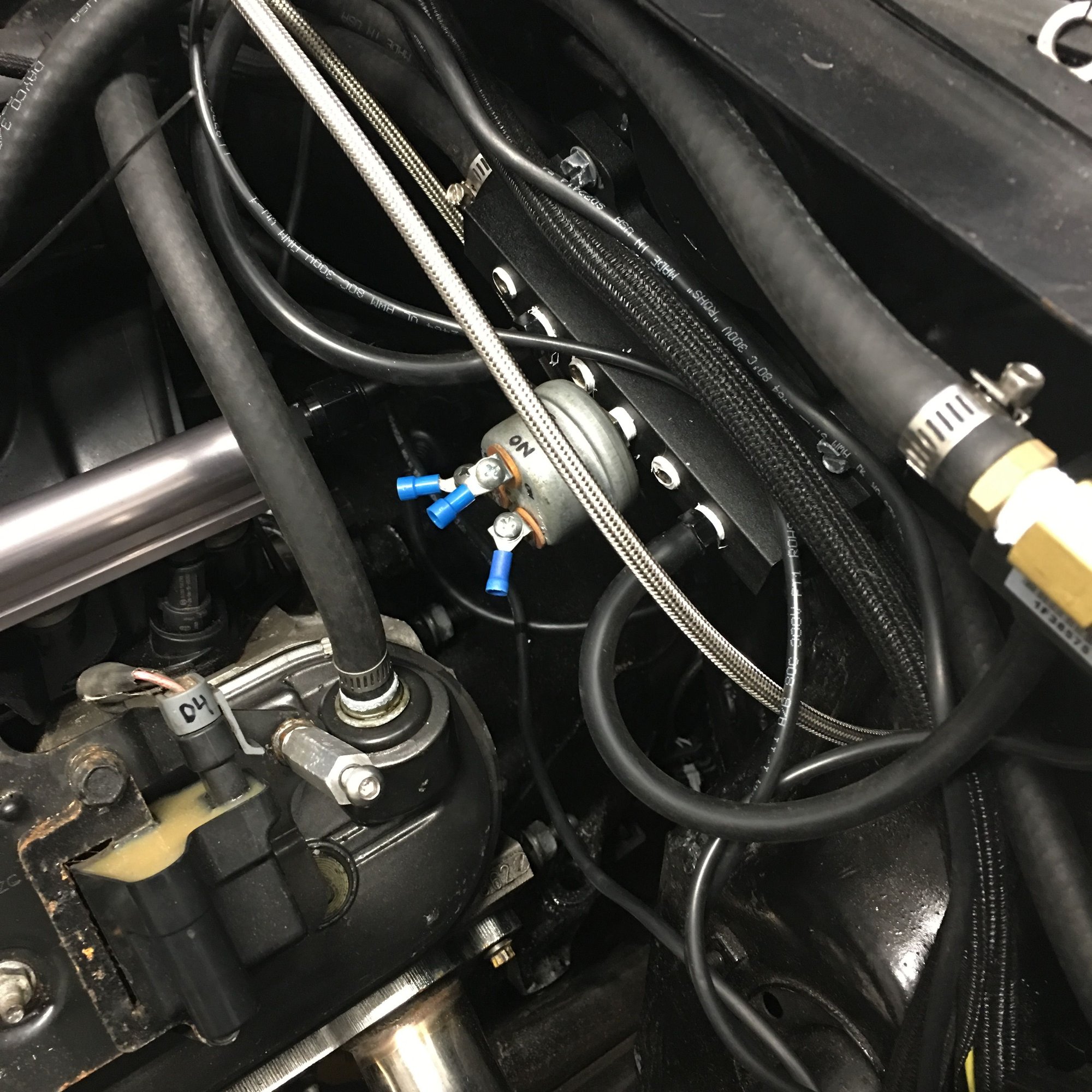

So I came home and decided to test my pressure switches I have left over from previous builds and I was curious to the psi activation points. I wanted to see what I had before I drop $30 on a new switch.
I have a Holley fuel pressure switch very robust and heavy and verified with a compressor and a few pressure gauges and LED that it has a pressure switch rating of 5.5psi. That one will work beautifully!
I then tested an oil pressure safety switch I had laying around and figured out it had a 8.5psi switching pressure. That's good to know! I was using it for low oil pressure that would kill the motor but never knew the psi rating.
Decided to see if I can get the 5.5psi Holley switch to work. The 1/8" npt screwed right into the boost block. This is just test fitting as it might contact my coil cover but worst case I can run a 90* and push it straight up which I will probably do. It's robust so I'm sure the rating is like 10amps which should be enough to ground the meth pump relay!

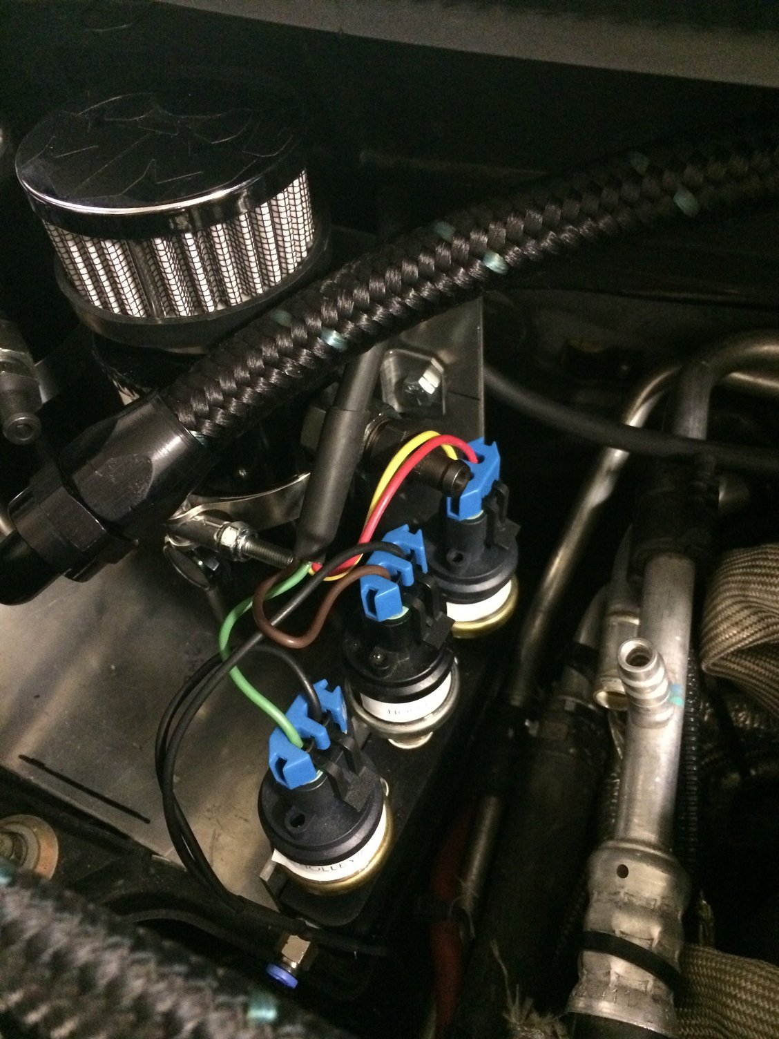

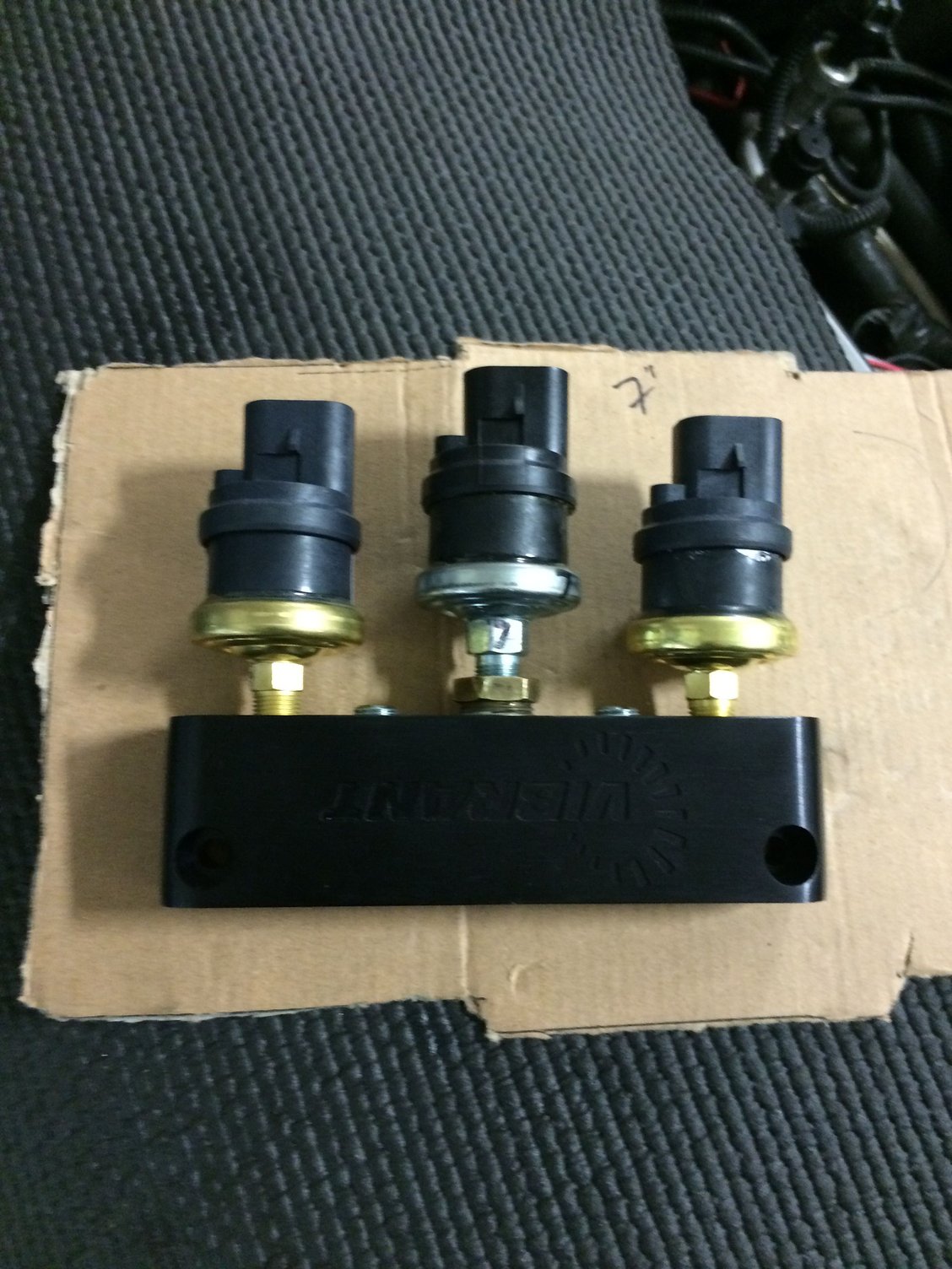

Personally, I do not like to skimp to much on parts that can cause major damage if they fail. If you are going to spend the 25 bucks on the switch mentioned, I would look a the Racetonix switches. They come in various pressure levels and are adjustable from there, up and down several lbs. They also have proper factory style connections which will keep out moisture and dirt.
I use 3 of them, all adjusted to exactly where I want them.
