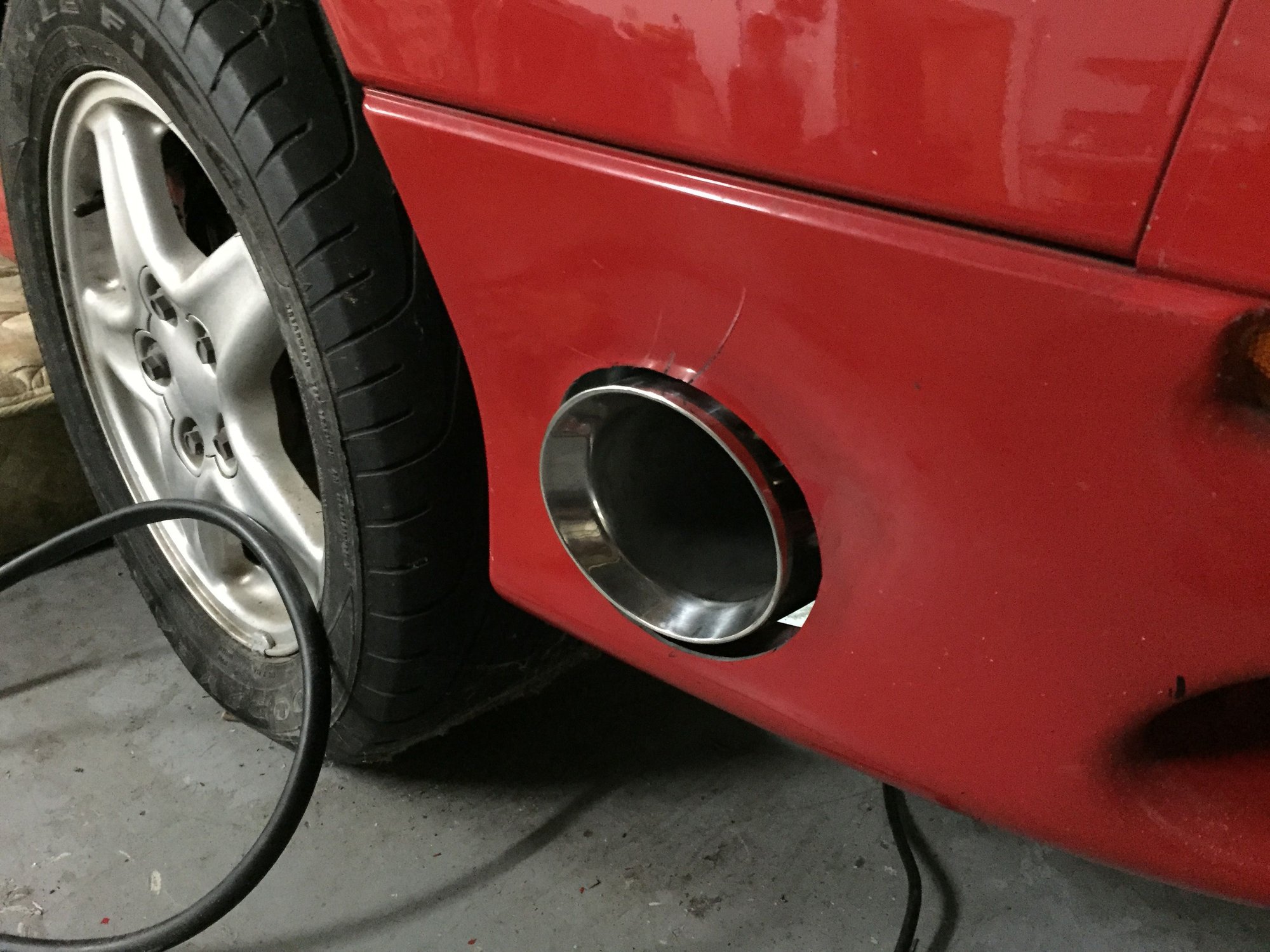

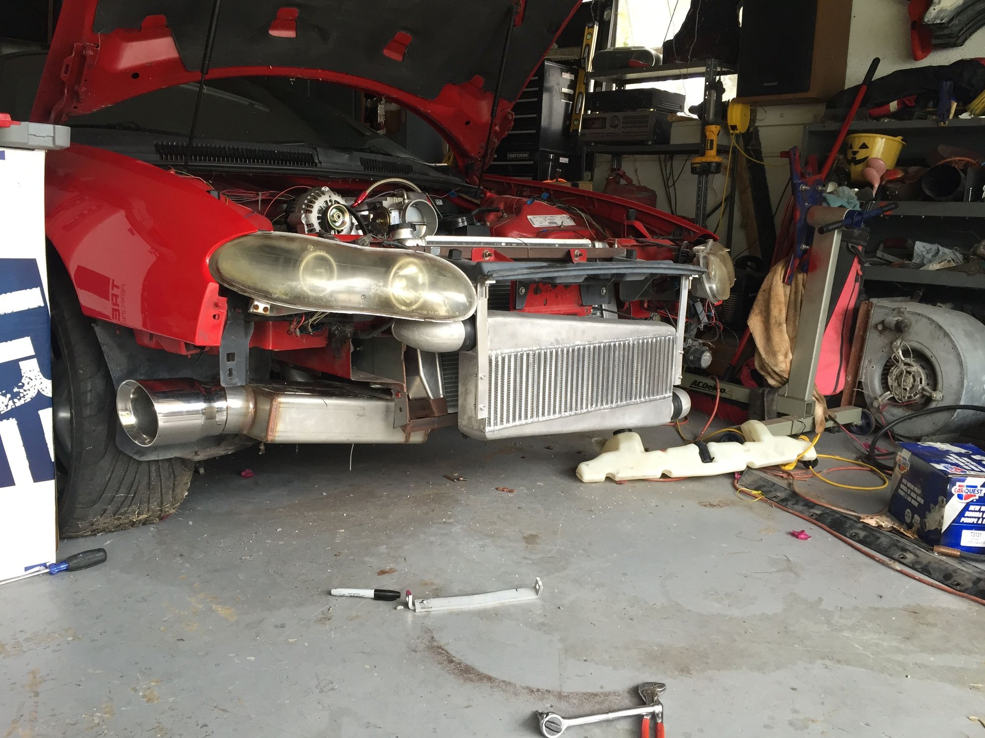

I think it depends on your manifolds. If they turn down and face forward like a truck manny, then it is difficult to get 4"or 5" through. This is the reason I chose to do a bumper exit with a muffler. Took a little engineering, and lost the fog lights, but it was very quiet on the street.
Sorry OP, forgot to answer your actual question!
I don't think anyone makes a pre-welded down pipe for an F body front mount, there are just too many variables.
Racepartsolutions.com is a good source for mandrel bends and V-bands, but I don't think they carry mild steel anymore, just stainless and aluminum.
I mounted my turbo, then figured out where I could route the DP, ordered the pieces, cut to fit, tack welded them together, took them to a shop to finish weld.

cashbrown - Sweet front muffler action! Im all about quiet on the street. I built an exhaust all the way to the back and through a multi-chamber muffler....but I have an exhaust cutout up front for occasional use right off downpipe. Would be nice to have no exhaust lik you....would have saved me alot of time (multiple days)
